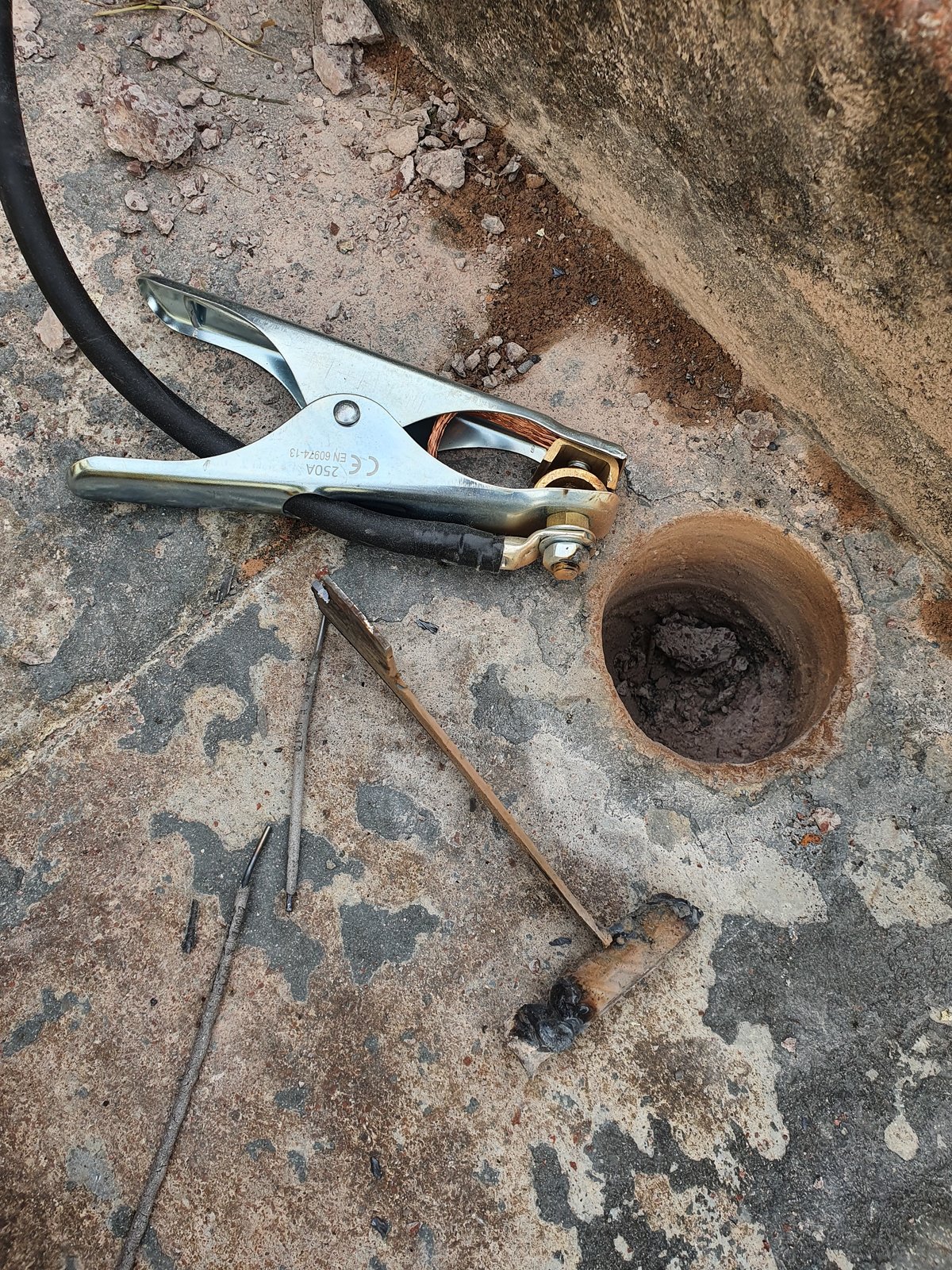

How thick is the concrete it might only be an inch or two thicker than the depth of the re-bar.
I'd drill a pilot hole through the middle to see the thickness and if practical try to get right through the concrete and chisel the concrete from below the rebar, it should be easy to cut the rebar when it is clear below even using a hacksaw blade in a pad saw or wrapping a rag/ tape around the end.
A SDS Drill just on impact with a chisel can be really handy for jobs like this.
