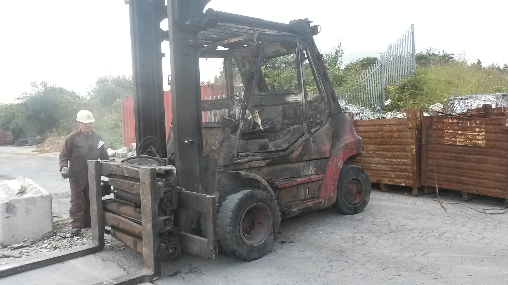

Thats halon 1211, very good as long as not in an enclosed space. Both carcenogenic and an asphixiant. The halon for enclosed spaces was halon 1301.I wish we still had the old Halon. 1kg was the same as a 10kg CO2. They are still allowed on aircraft and military vehicles.
They weren't as dangerous as made out but were banned due to harm to the ozone layer .My guess is a burning car would do even more harm!
