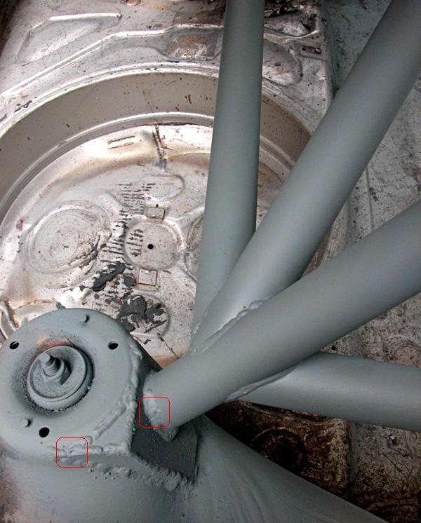

Where is this hole?
I cant see it!?!
I cant see it!?!
oppsI'd be ashamed to send the job out looking like that.
I've pointed the guy who made in the direction of this thread hoping he won't take offence to it
Seriously though, just a little care setting up his machine would have probably made all the difference and we'd all be cooing over a nice job rather than picking (minor) faults
Well not a decent one anyway. So I'd better be getting the MIG welds done properly first time then, or its grind grind grind. And I hate grinding down metal at the best of times.
The`ll be welded all the way round. When doing cages you drill holes in the floor of the car first, then put a plate over it but dont weld, then assemble and weld what cage you can, pull the plates out, then drop the cage through the floor so you can get to the top. Bring it back up, stick plates back under, weld plates in, then weld cage to plates. At heast thats the way i know. Someone will probably come along and tell you a proper way of doing it though.
