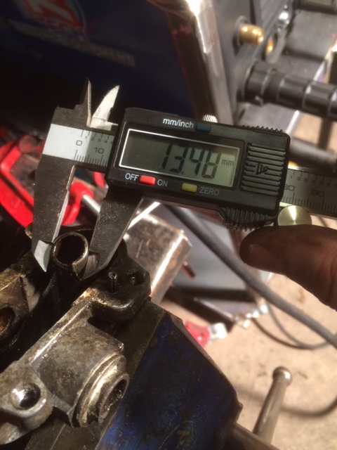

looking through one end, can you see daylight through it?
Quite often HSS drills will not touch roll pins,
Roll pins themselves, are, HSS!
there made of spring steel
If it's burred over , you could try hitting the end of it and the pulley with an angle grinder, then with the right size punch it should knock out ok.
On a mower it won't be going that fast and it's near the centre anyway. Plus he wouldn't be taking much off. Looking at it again though, a parallel punch and a decent hammer and it should just smack through. That trick is useful though if you have a bit of the roll pin sticking out and burred over.That'll do the balance the world of good!![]()
I think this is being over complicated here! Yes you can drill them out with a cobat drill or get it out with a grinder, or anneal them, but generally speaking even when burred over it's still normally just a case of having the right size punch and giving it a good clout!
