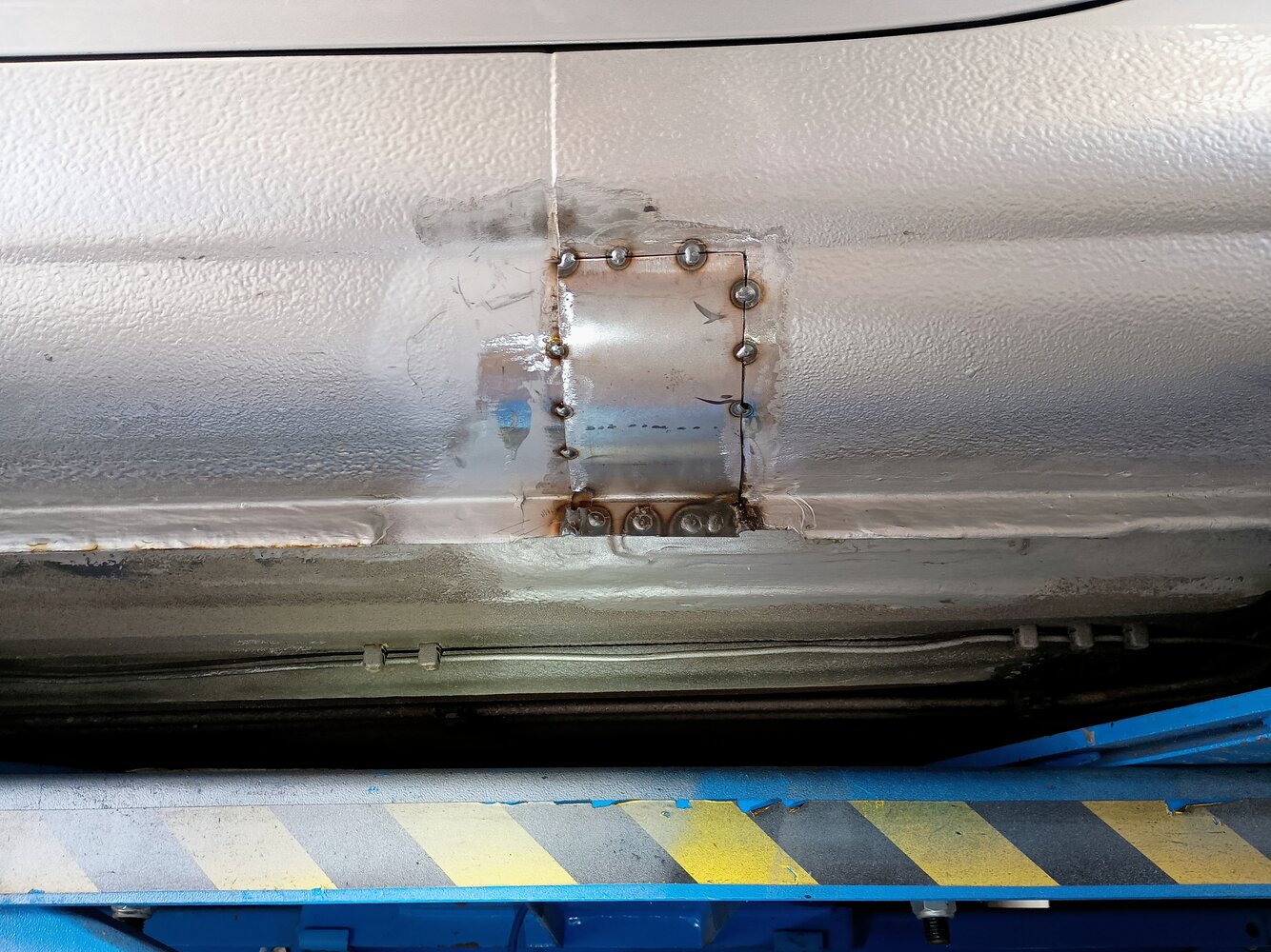

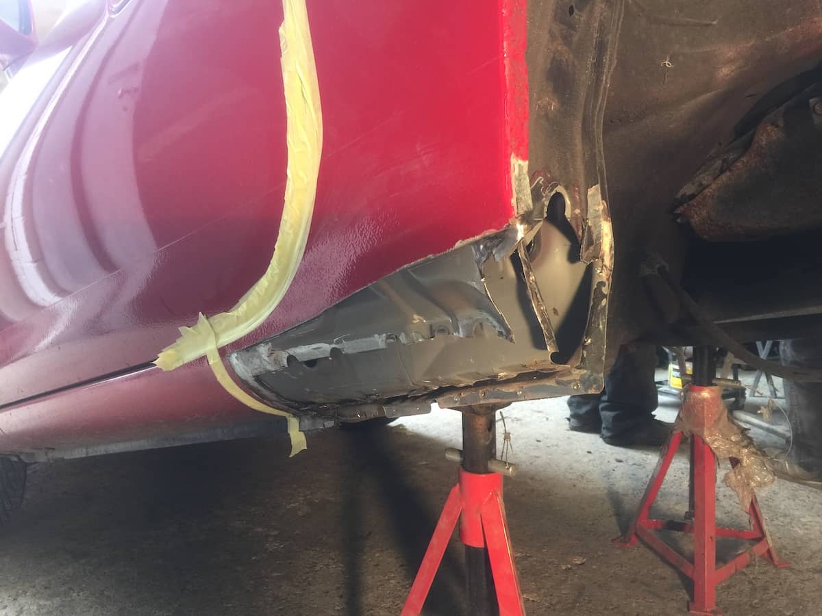

Whilst this as may be, and you're all "great" comedians... I have still been tasked with replicating it faithfully, to preserve the car as we got it.My father has been spraying for the best part of 40 years...he just said the best way to achieve that finish is to find someone that cant paint and let them at it

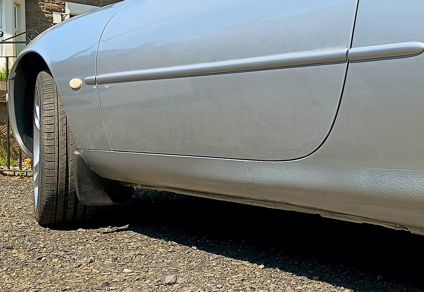

Some Mazda MX-5 brochure pictures. You can see the top of the textured coating in all of them (there is no seam line or swage on any of the panels at that point). It's a [very] hard coating with a fairly subtle texture, not like the ruberised stone chip that's under the arches.Schutz halfway up the door is not original paintwork on any motor I've seen.
The line is the top of the stonechip / 'avocado' skin texture (there is no 'line' as such) - just showing that yes, it did come half way up the doors.There are no ripples and bumps on the advert pictures just a line and none of the avocado finish.
I am not fussy at all, drove the Hilux round with fluro pink duct tape covering rust holes in the rear quarter panel for a year (that is apparently an MOT pass as the sharp edges are covered and it's not within 30CM of a prescribed area)you will struggle to do a spot repair and have look great , i would roar it off to the nearest join , or the whole sill and redo it all so it matches , depends how fussy you are
This one is basically as factory, no welding until the tiny underbody patch I did earlier this week first.The trouble is that, by now, any MK1/MK2 MX-5 is a bit like an archeological dig...

If you see it from 6ft away and/or with the lighting perpendicular it looks nearly flat.There are no ripples and bumps on the advert pictures just a line and none of the avocado finish.

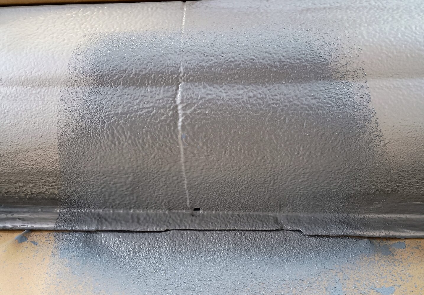

It's very specific, which is why I'm researching how to recreate that exact effect.
That's certainly an option, I suspect it will take quite a few tests to get it "just so"I would be experimenting with an orange peel finish, low gun pressure and unthinned paint, but watch out for plastering on too much and getting runs. Jotun also looks like that after spraying.
Yeah, I can see a subtle texture difference... Again experimentation is going to be key here.I did this repair with gravitex as I had some on hand. Not perfect but good enough for my Mrs.
So the original stippled effect is definitely a coating not a paint technique?
It was "Special PVC paint" that was over-painted with top coat according to a 1990 MX-5 body shop manual referenced here:So the original stippled effect is definitely a coating not a paint technique?
Ok that opened up some interesting avenues of research.It was "Special PVC paint" that was over-painted with top coat according to a 1990 MX-5 body shop manual referenced here:

There is reference to PVC chip guard in the attached Toyota collision repair advice from 2004 that lists a range of contemporary products (probably discontinued by now).
