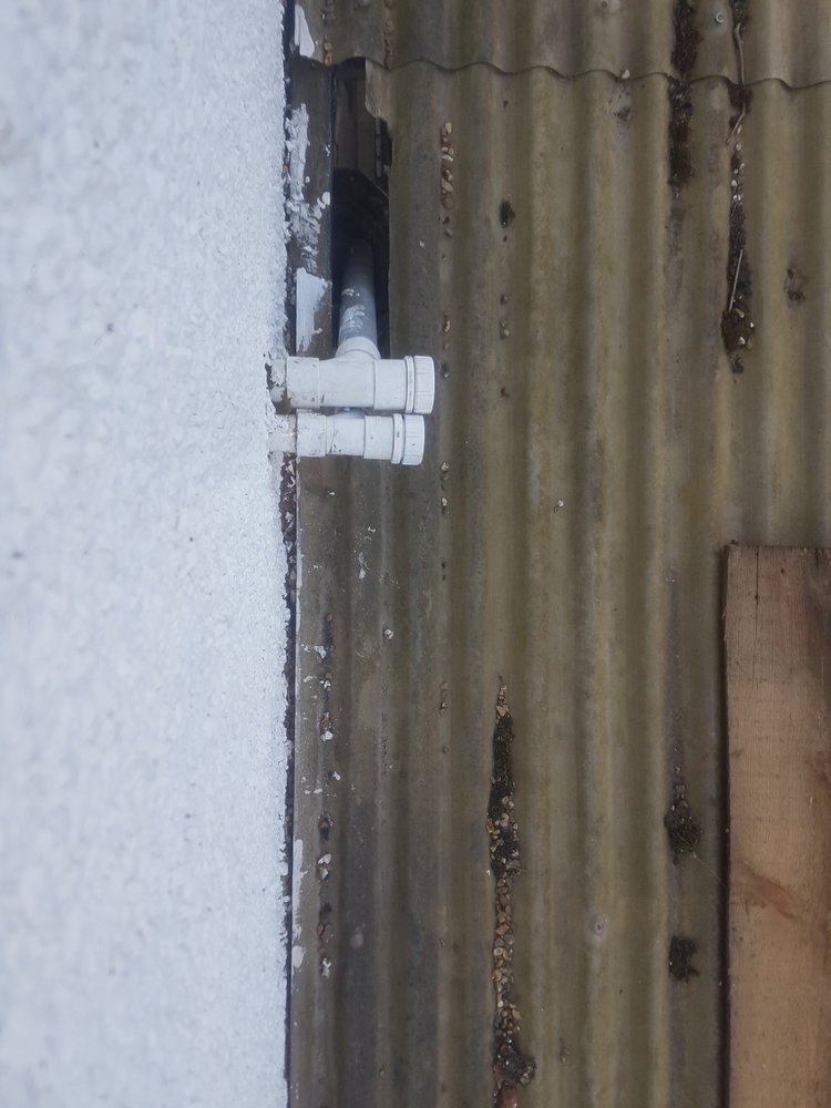

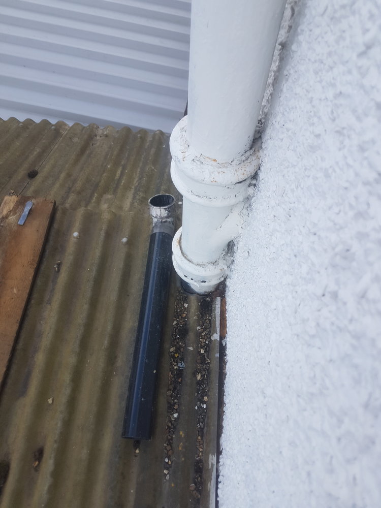

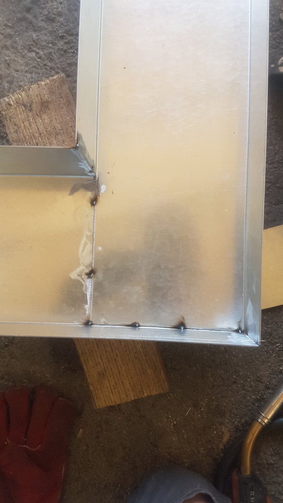

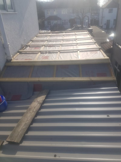

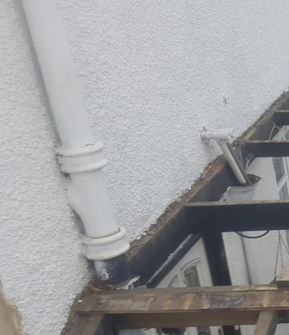

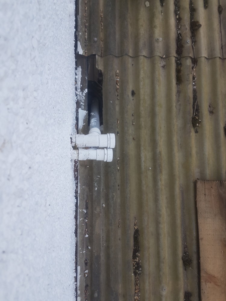

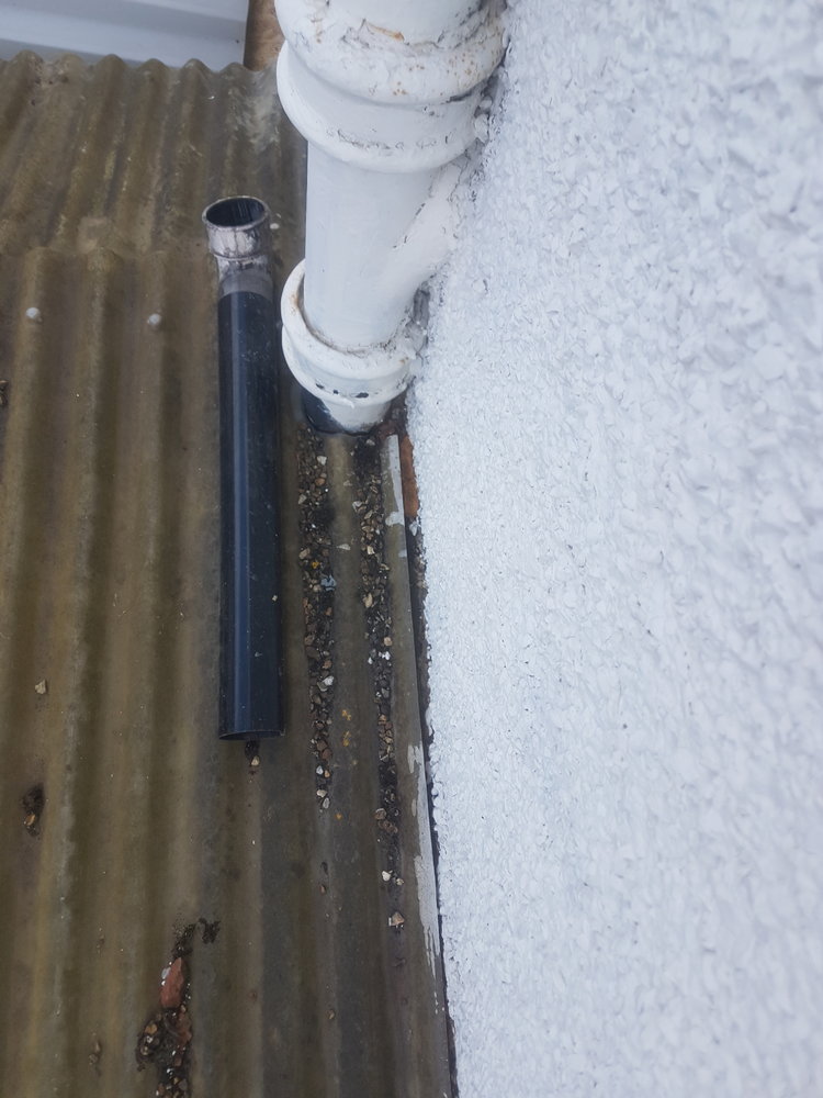

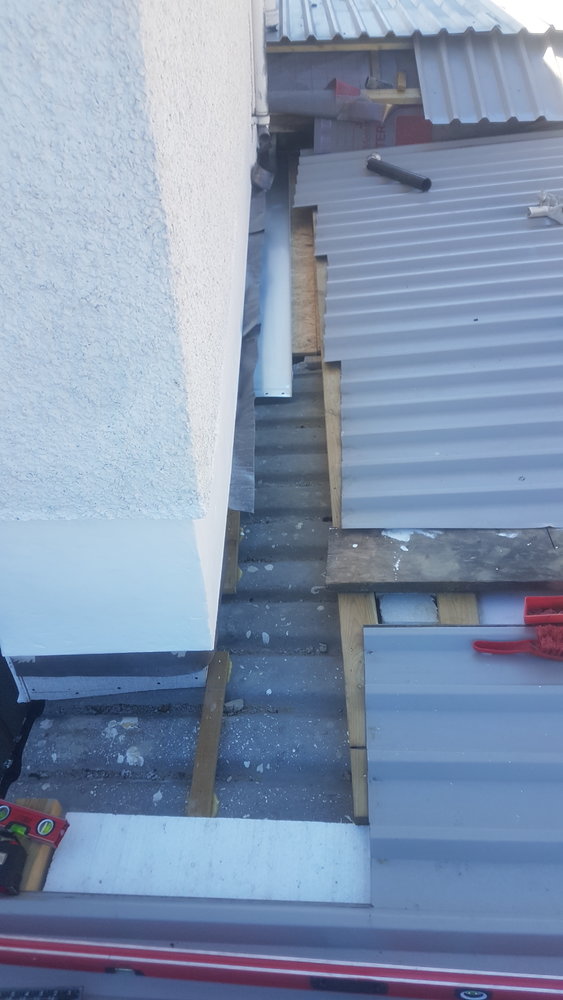

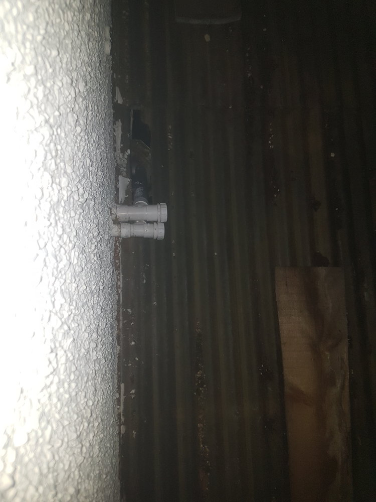

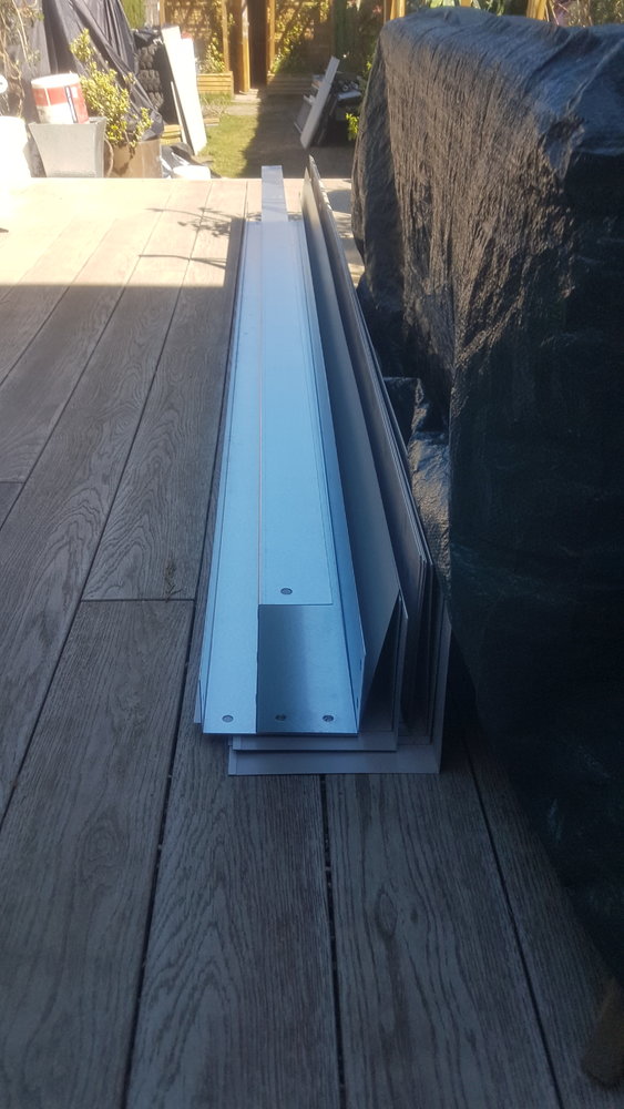

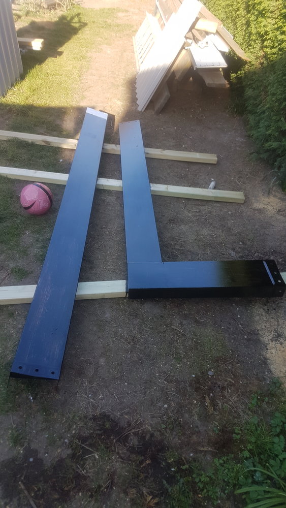

that looks great but there is only 10mm beteween the wall and soil stack pipe

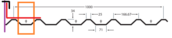

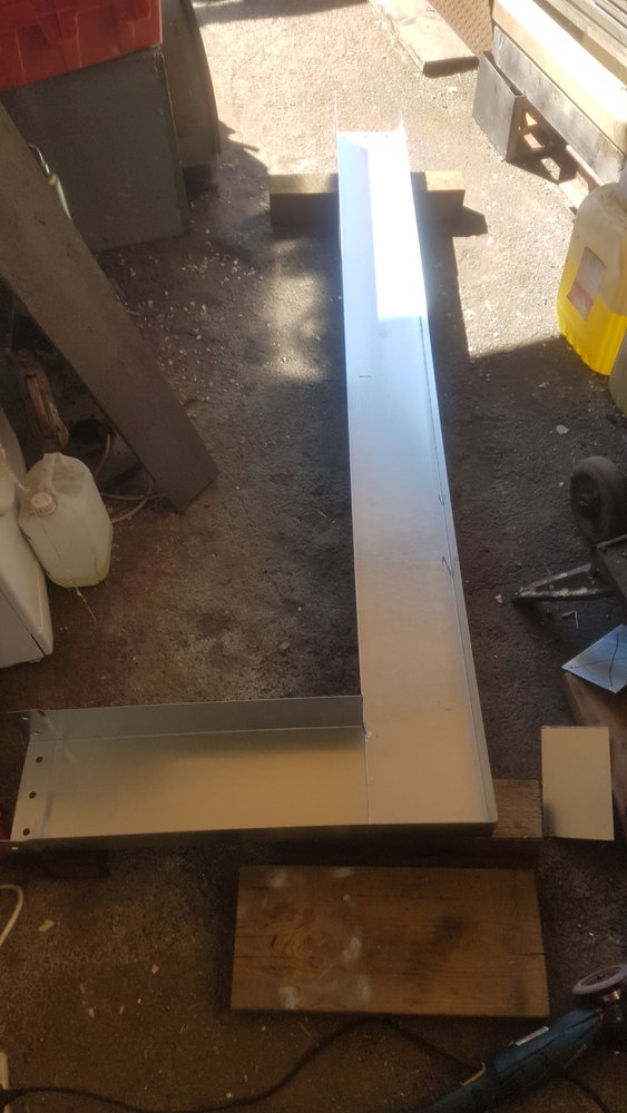

The problem is there is a T section that enters the wall right where I will want to be with the lead and upright of the L trim.erm i have to do it many a time so i can assure you its hard to do but it can be done
use a grinder most of the way then use a pointing chisel for behind the soil pipe
Roughneck Plugging Chisel
Made from hardened and tempered steel with hexagonal shank. Chamfered striking face. For removing mortar in between brick courses.www.toolstation.com
you will use the point more than the long blade of it all you need is a line like your grind mark
do the rear lead first slot the lead behind the pipe and then slot another piece over it

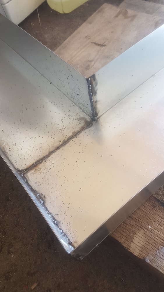

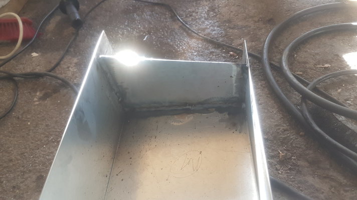

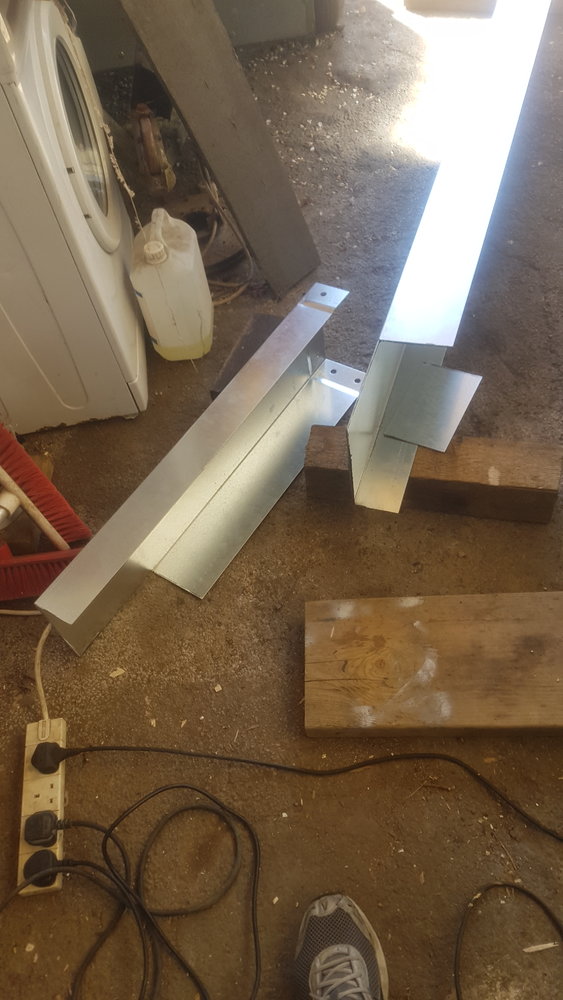

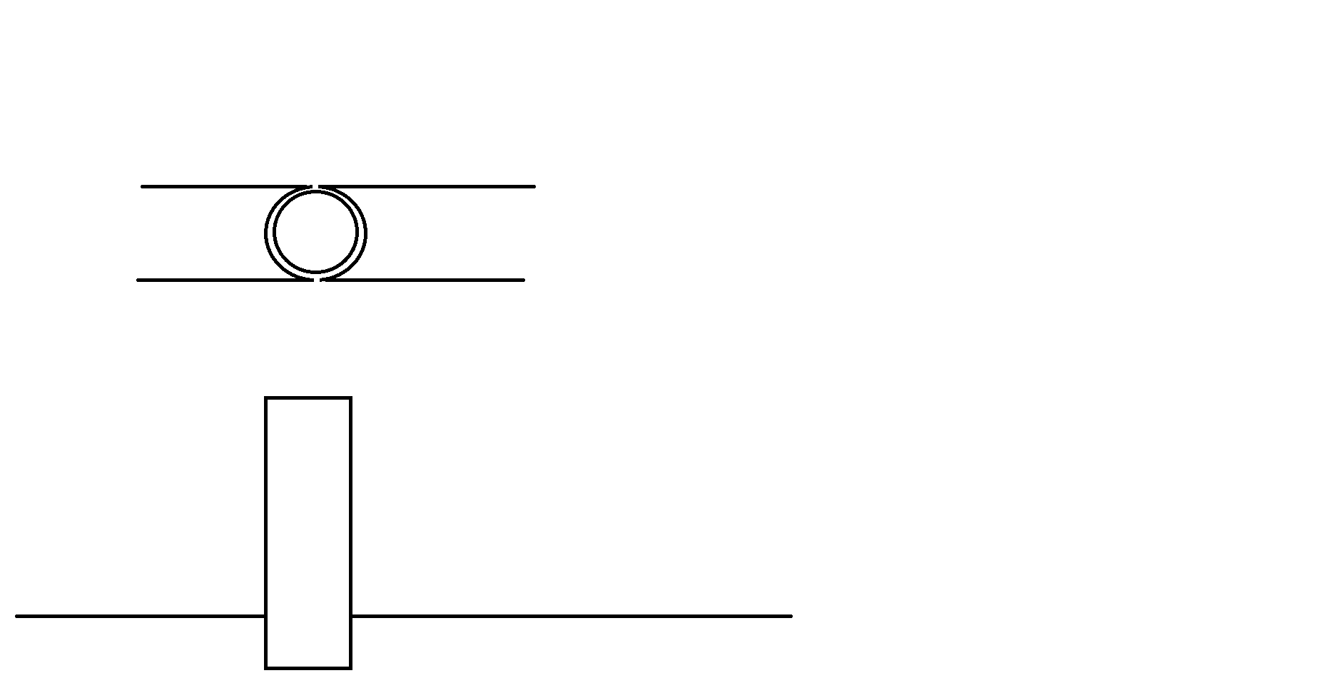

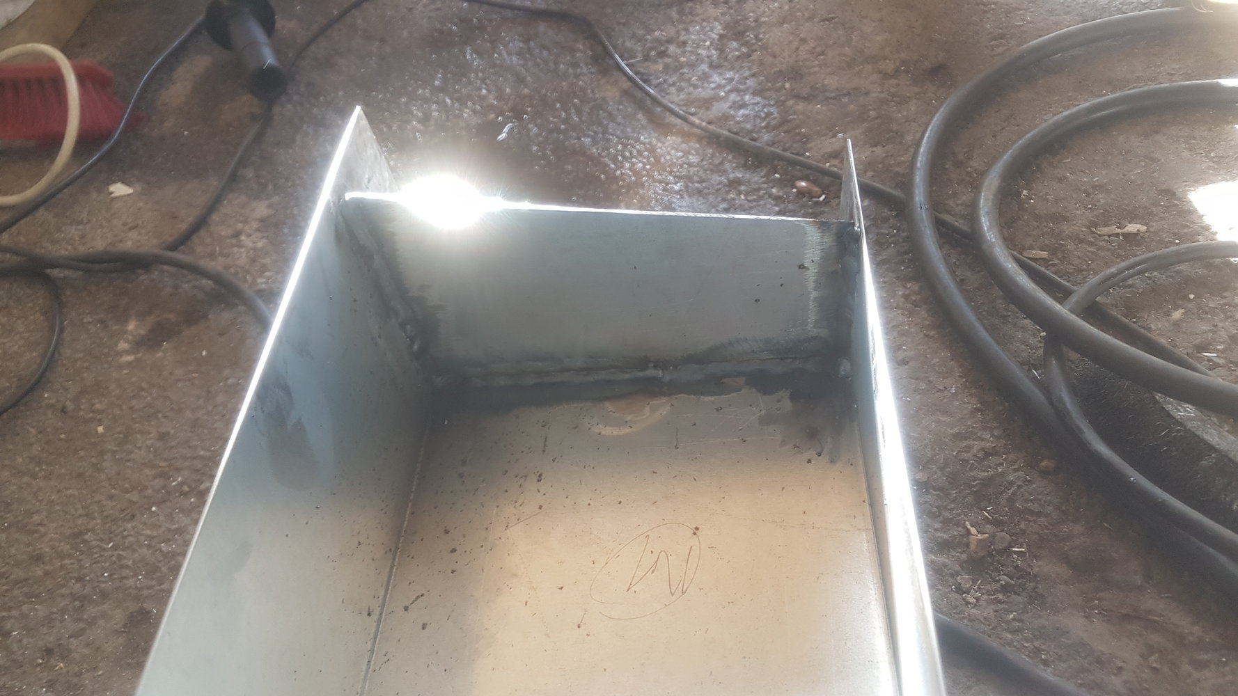

like ive said split the L into 2 and shape it around the soild stack illustrated below
the lower end must be longer to go behind the soil pipe silicone well behind it the higher end goes over it and silicone well again

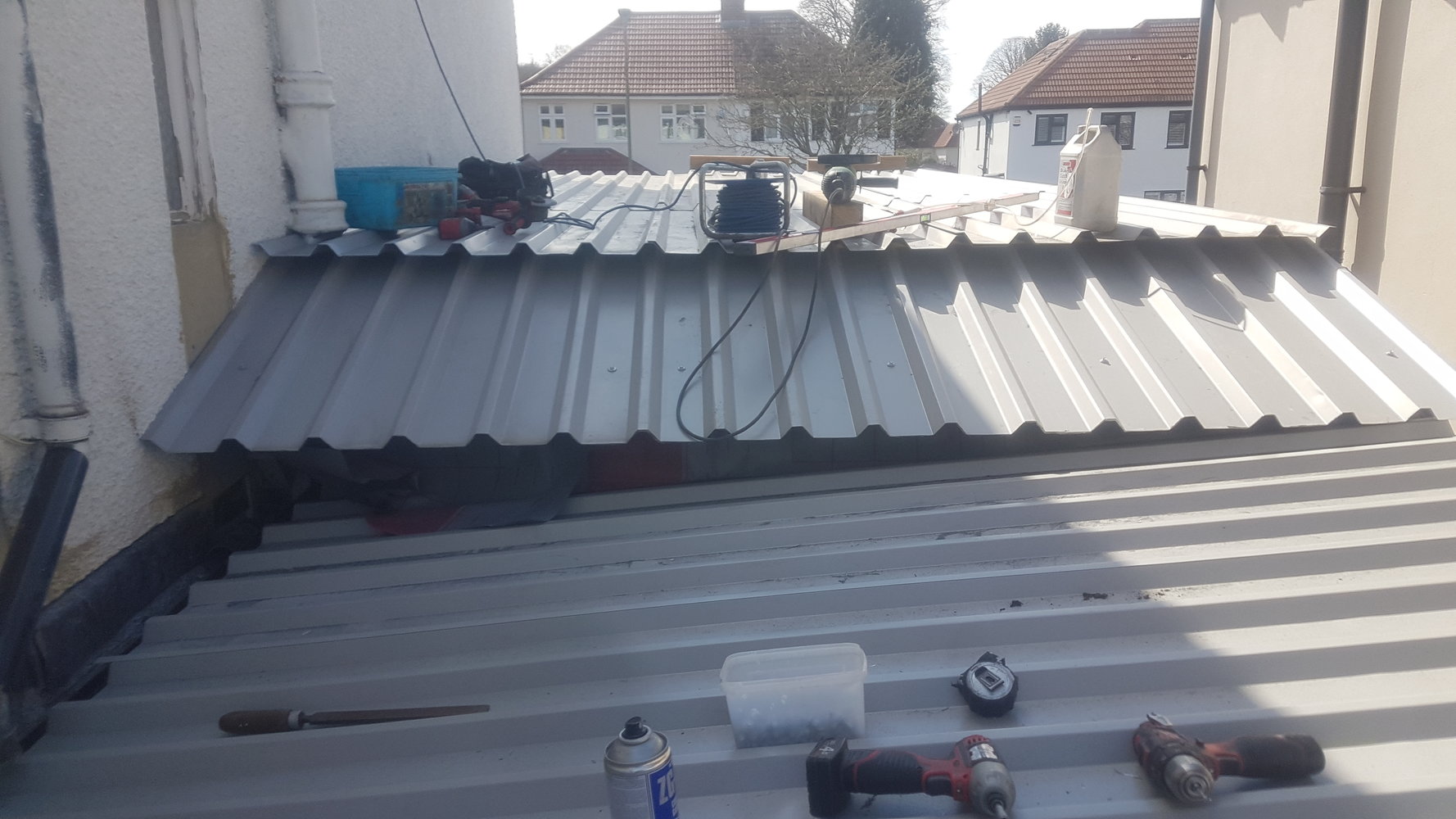

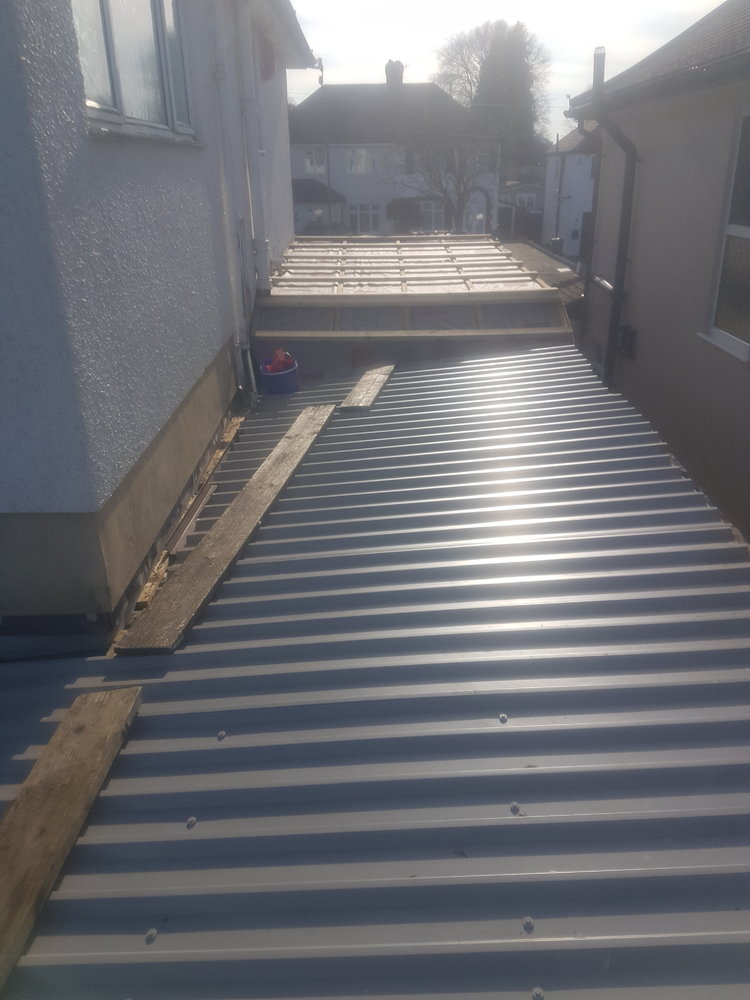

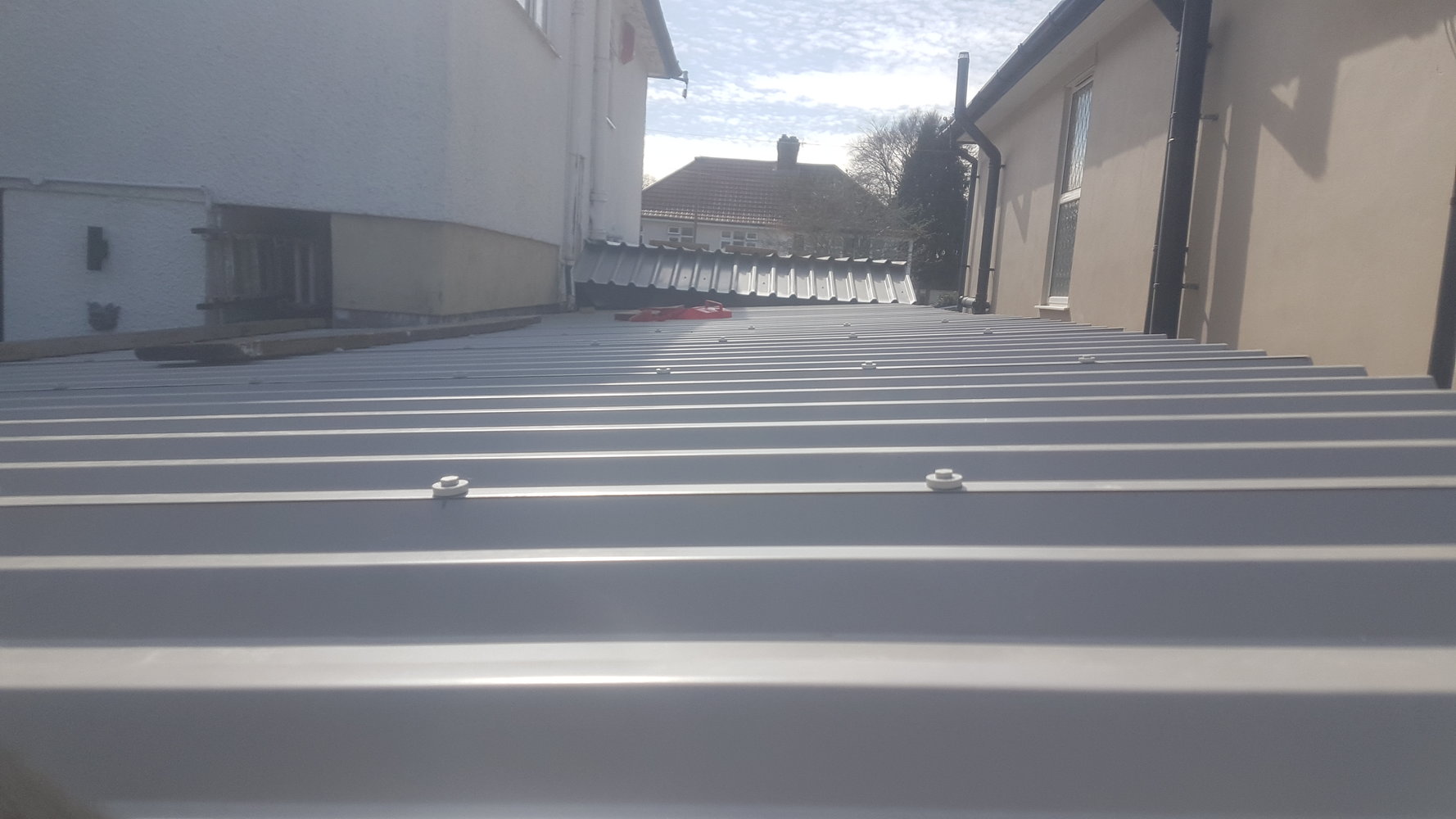

You've done a very good job of sorting this new roof, Fair Play.
