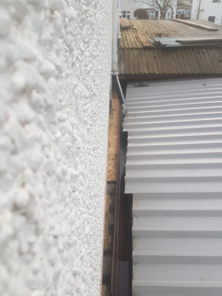

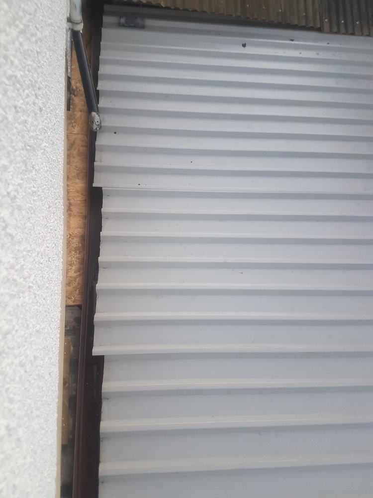

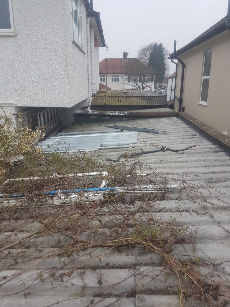

your box gutter as it swings round the house you could weld itwhat corner we tinning?
sounds like extra work to tin it, the mig welder is right below I reakon the torch will reach! gotta be quicker, easier and neater welding ityour box gutter as it swings round the house you could weld it
but you could also tin it as well if you so choose to do

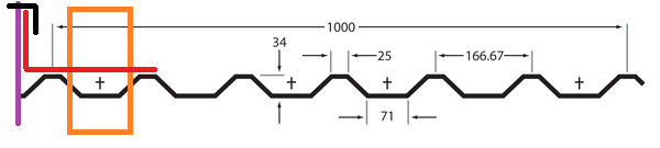

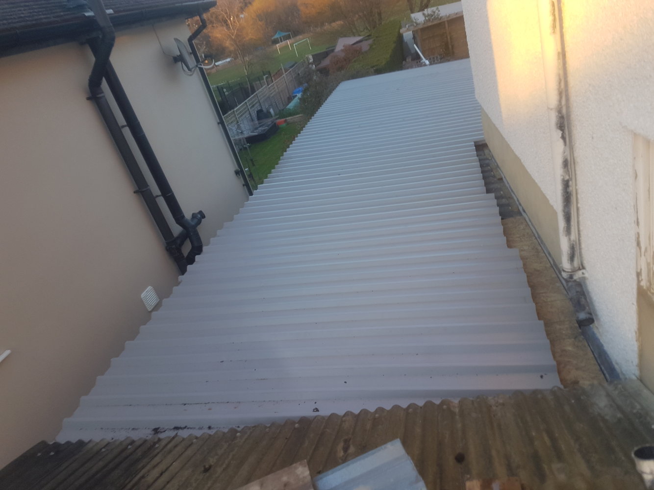

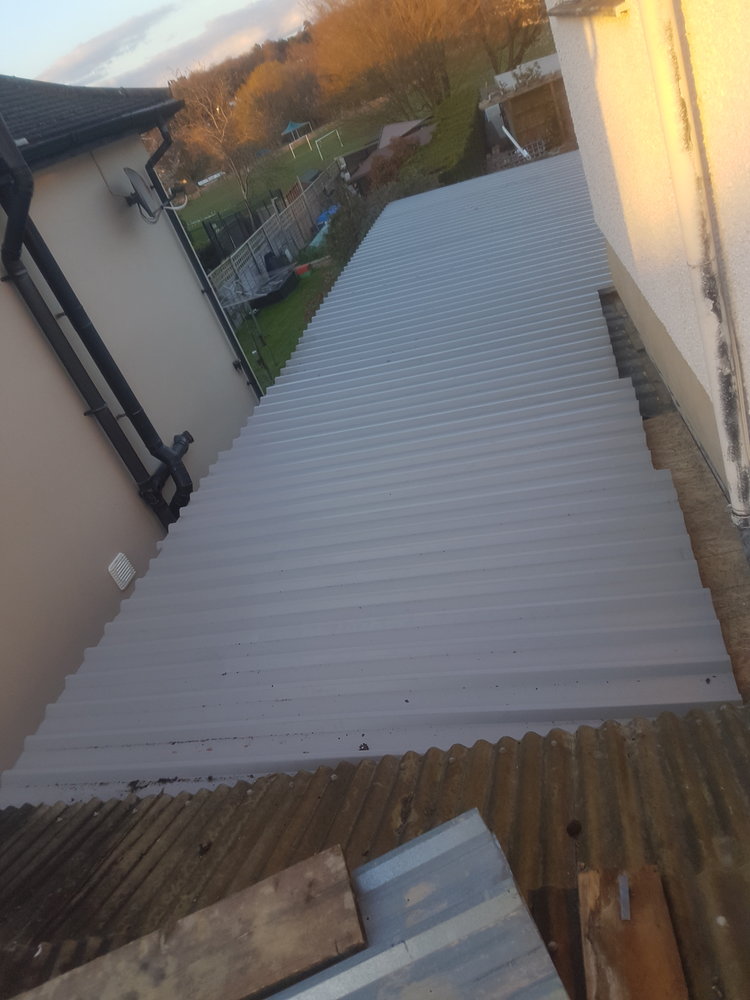

oh so the soil pipes need to be boxed in up to the soffit?if you use the same method bridging over 2 uprights with an l plate up your wall
just a silicone seal would be enough
just remember to cap the end as no water wants to get in it on either end
