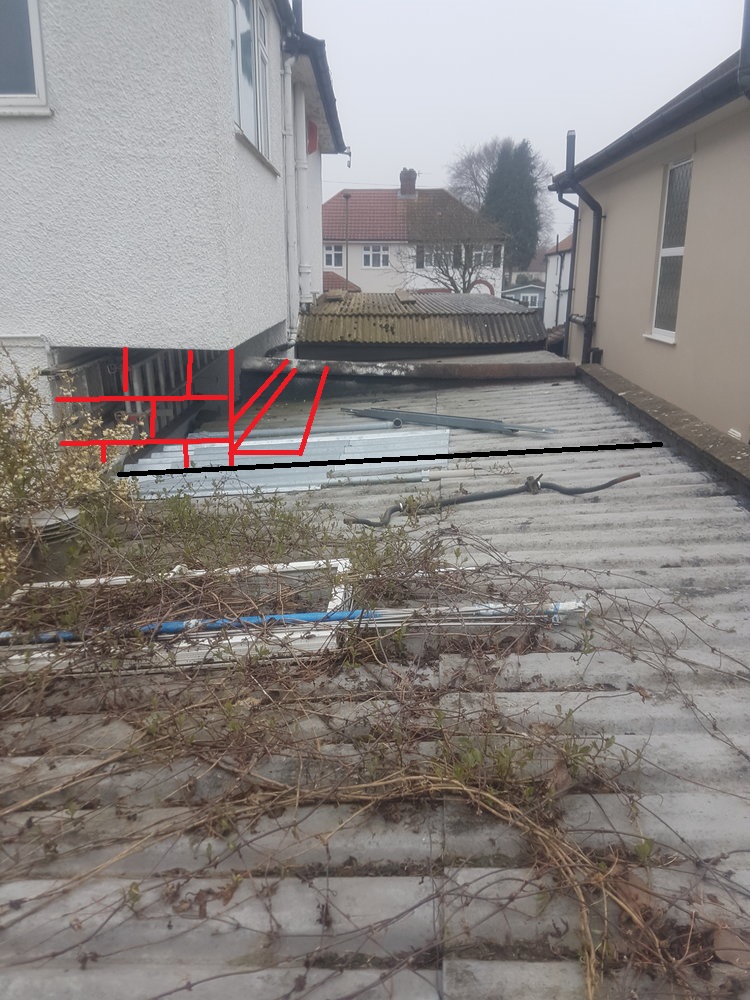

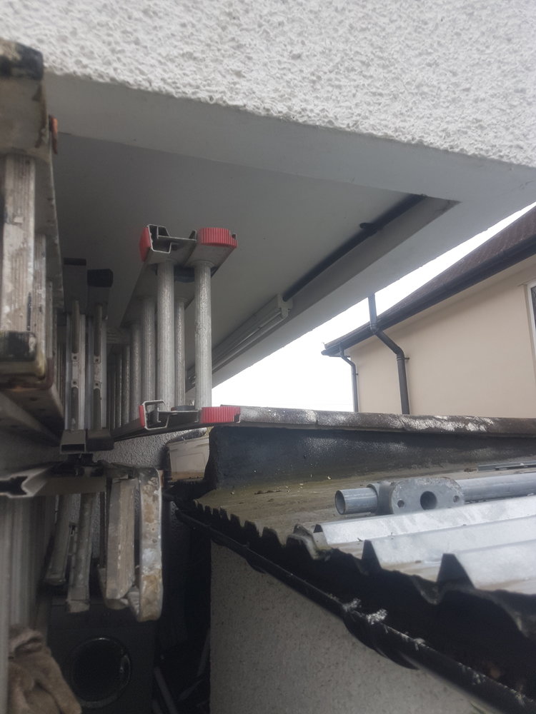

we have no plans to move. The thing is the fixings move in the roof too so I am sure with a kit like that it would leak again. I have got a 25kg tin or something I purchased to do similar but I am keen to do it properly and stop making repairs that only last a few yearsi mate did have a asbestos roof that was leaking he paid for a kit that you wash the roof brush it to get all the loose stuff off a stuff that he painted over to kill any growth then panited over with a sealer/rubber coating it did work
not my idea id do better to reroof but it depends on where you are staying there for years to come
Yep, I think that has not helped the roof me with a ladder on the garage roof up the side of the house clearing gutters and painting soffit and faciasYou will need to bear in mind that either property may need a scaffold for roof repairs in the future, whatever you build will need to be able to support this. Thats a long way down that alleyway, just saying.

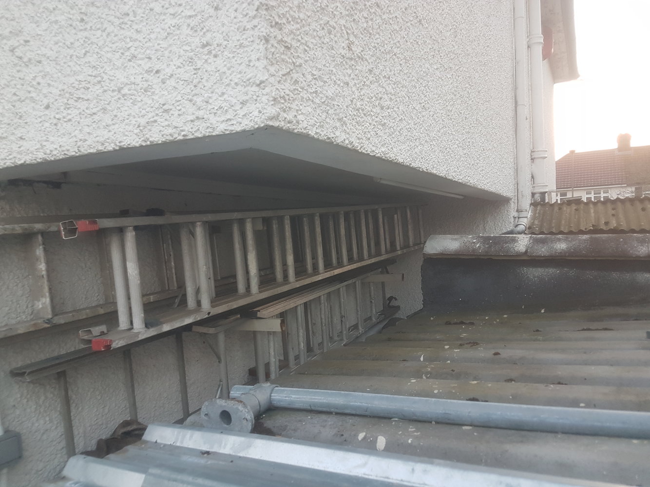

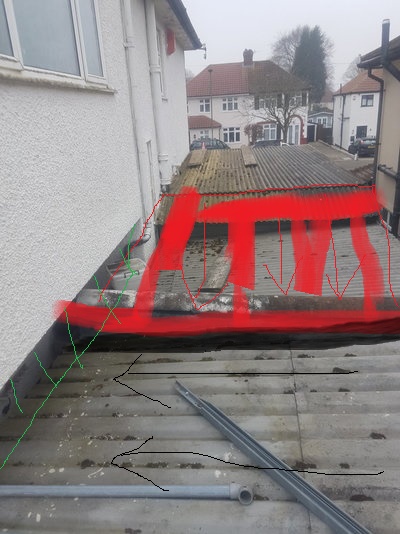

ok then hear me out this is me
that part under the house id remove all of the ladders from there build a wall up rear side and then shelv under the house area as its a great storage area
then its sort out your roof area in the middle for me
no matter which way you choose your going to have to use a gully at side of the house all the way down
is the loner red line a gulley?ok then hear me out this is me
I can move the down pipe that is no big deal, I would like to do the soffit and facia anyway so good time to re route the gutterive edited the post above and added a pic so you can see where i mean

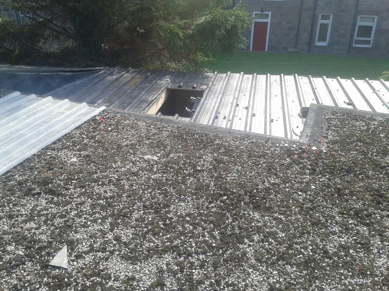

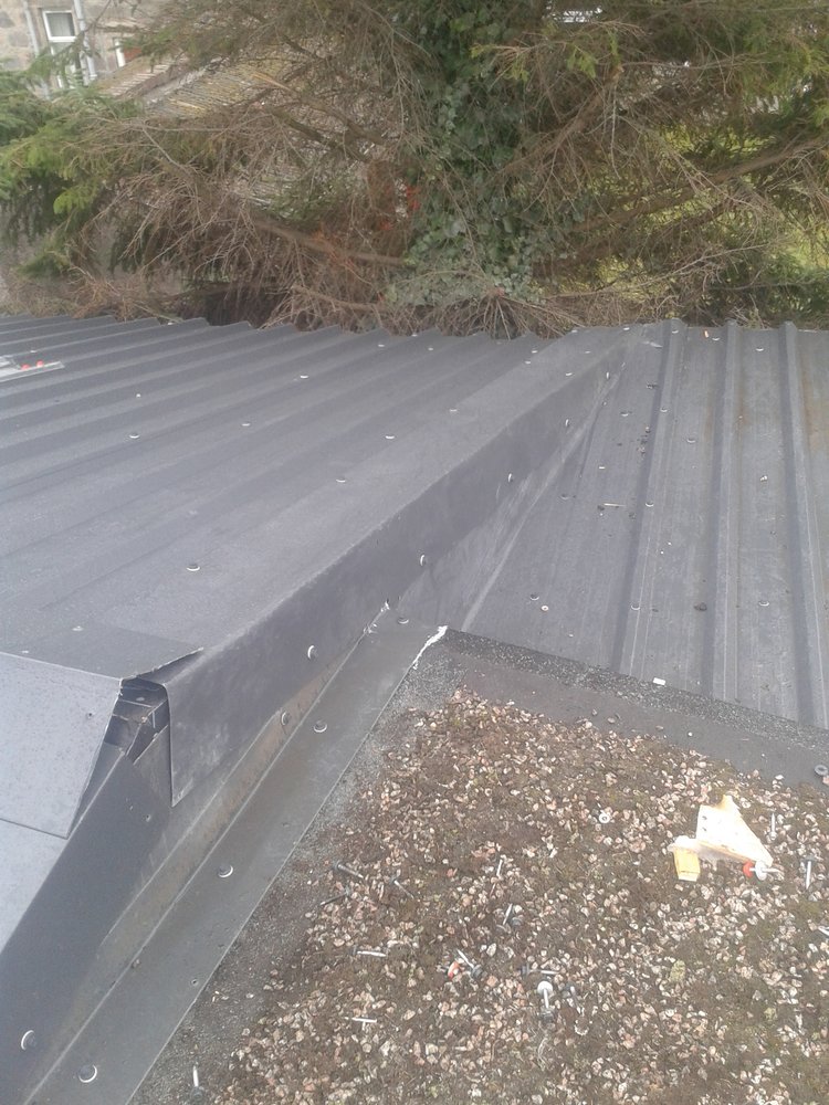

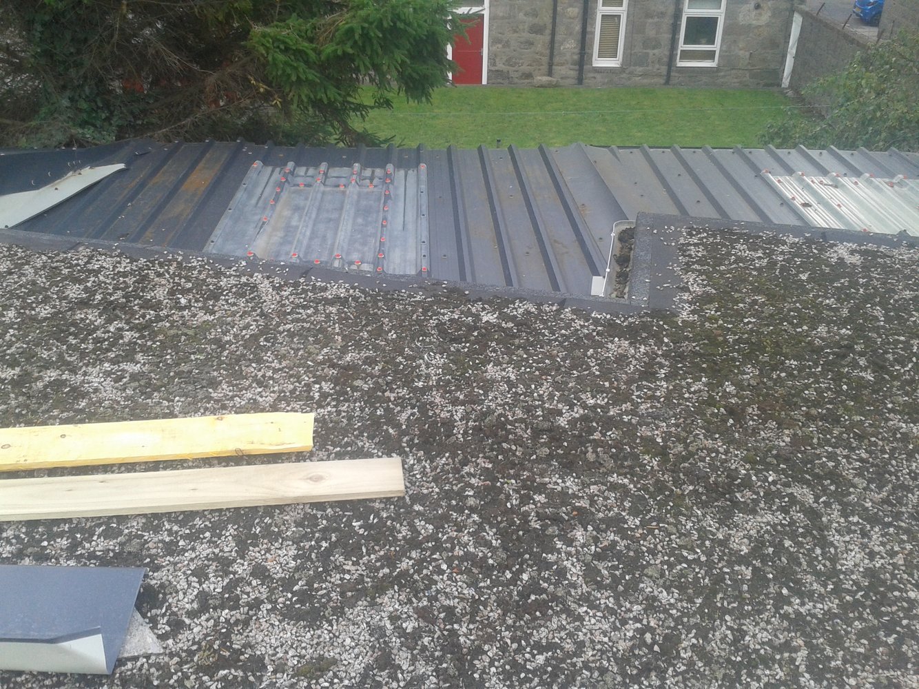

yes you could use lead but get near that downpipe and it will give you trouble
you can do it with the tin roof itself in a long length
by making sure the ridge is after the soil pipe and cover over the long run
yes but needs to go below your roof as you need a fall into it before you create the gully aboveO
I want to do it right and do a good job I do not want to be re doing it 5 or 10 years down the line
