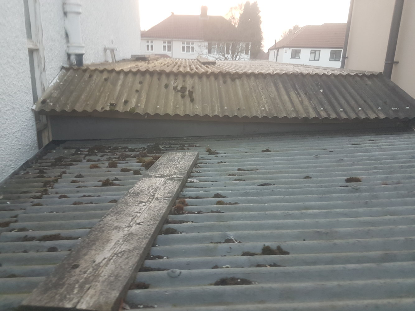

As much as i would like to help, the glorious County of Kent is a bit far to expose my skills and be home in time for the 6.o'clock news. My advice would be to do it in sections even if you make it one level, that way you can minimize trying to keep it water tight during works
it is bad aye. not sure about doint it all to one level either though. What are my options?Wow that's a car crash initAs much as i would like to help, the glorious County of Kent is a bit far to expose my skills and be home in time for the 6.o'clock news. My advice would be to do it in sections even if you make it one level, that way you can minimize trying to keep it water tight during works

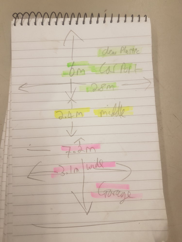

what money would you/ can you play with
what improvements would you like if you could do ?
rip the lot of and start again
Yes, could you reroof it section by section?In my unskilled/untutored view, a bodge will always be a bodge and ultimately unsatisfactory.![]()
though possible you'd end up with joins, keeping it watertight between the old and new would be more effort than starting afreshcould you reroof it section by section?
answer these for me

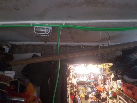

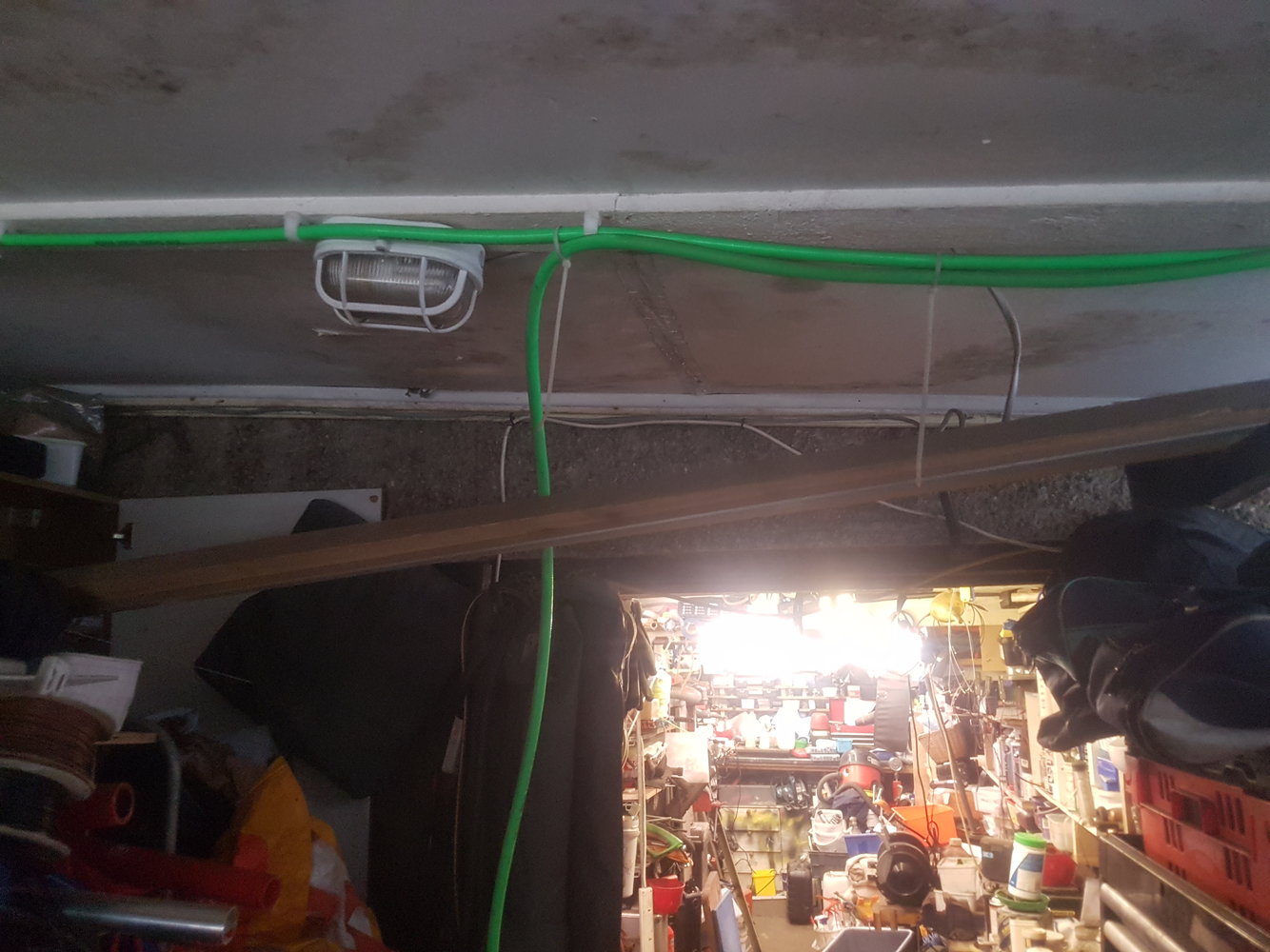

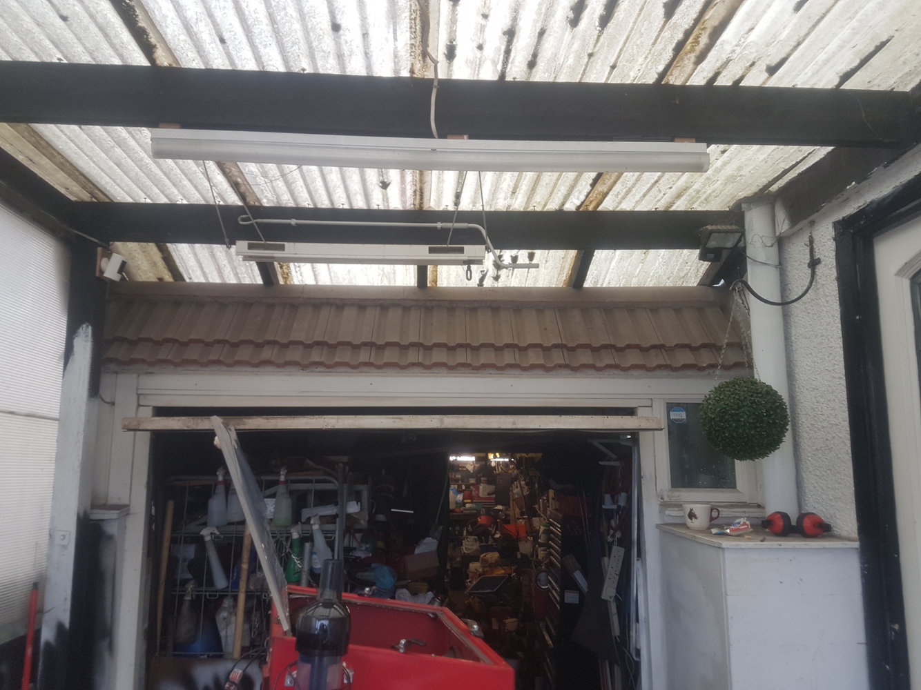

i presume original garage front design NO, IT WAS THE ADD ON BY LAST OWNER MADE TO LOOK LIKE A GARAGE
is that wall where door is a prefab concrete garage NOT A PREFAB GARAGE NO THAT IS THE ORIGIANL GARAGE NOT THE BEST OF WORK PRE FAB WOULD BE BETTER!
YOU CAAN SEE ONE OLD WOODEN DOOR TO THE LEFT BELOW LIGHT FITTING
as this would be the part above on the roof wall THE RIDGE TILES ARE ABOVE THE ORIGINAL GARAGE DOOR WHICH WAS DOUBLE WOODEN DOORS

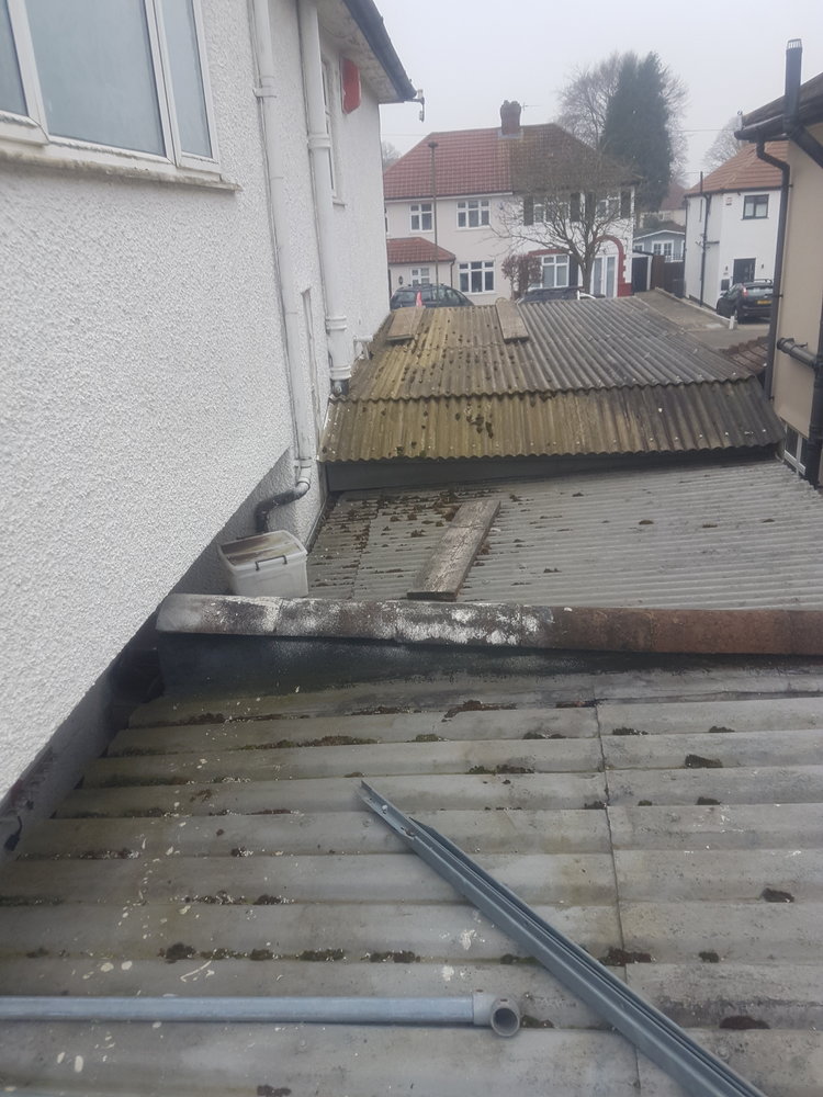

IT AINT THAT BAD THB, well when it leaks!It must be a noisy sod when it rains heavy![]()

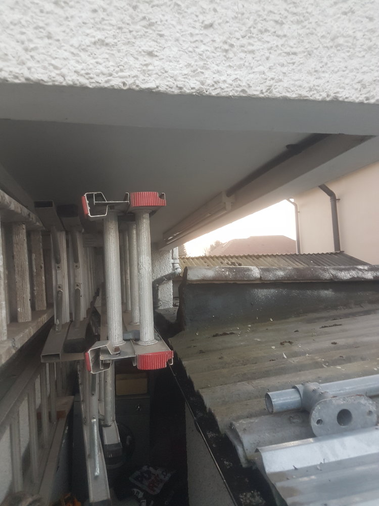

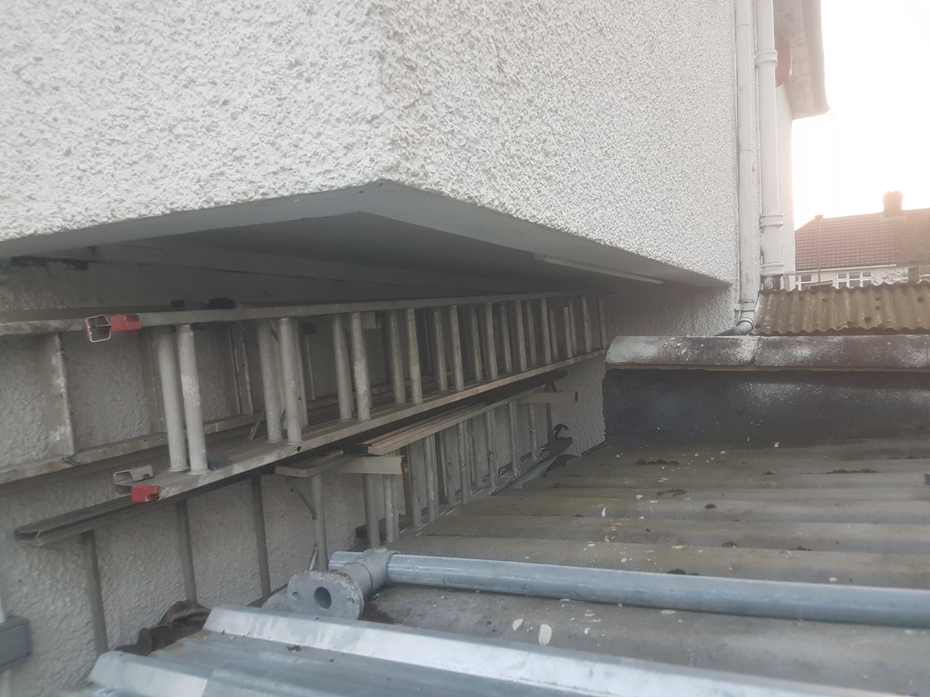

So are you saying to re roof it from the car port as 1 roof and slope it from front to backfirst off you may/will have an issue with next doors right to light in the window of theres at side front
so the height maybe a problem from the very start
you can do a recover or maintainence of the garage roofs replace whats there due to wear and tear

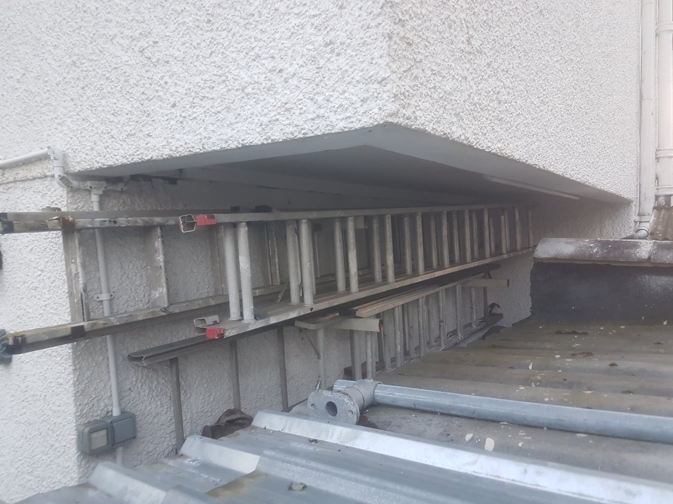

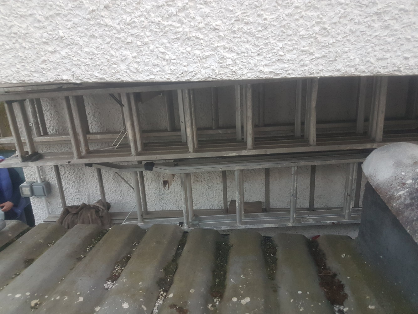

the side wall to the house can be built in and up underneath the house but i wouldnt advise drilling too many holes there it will be a concrete

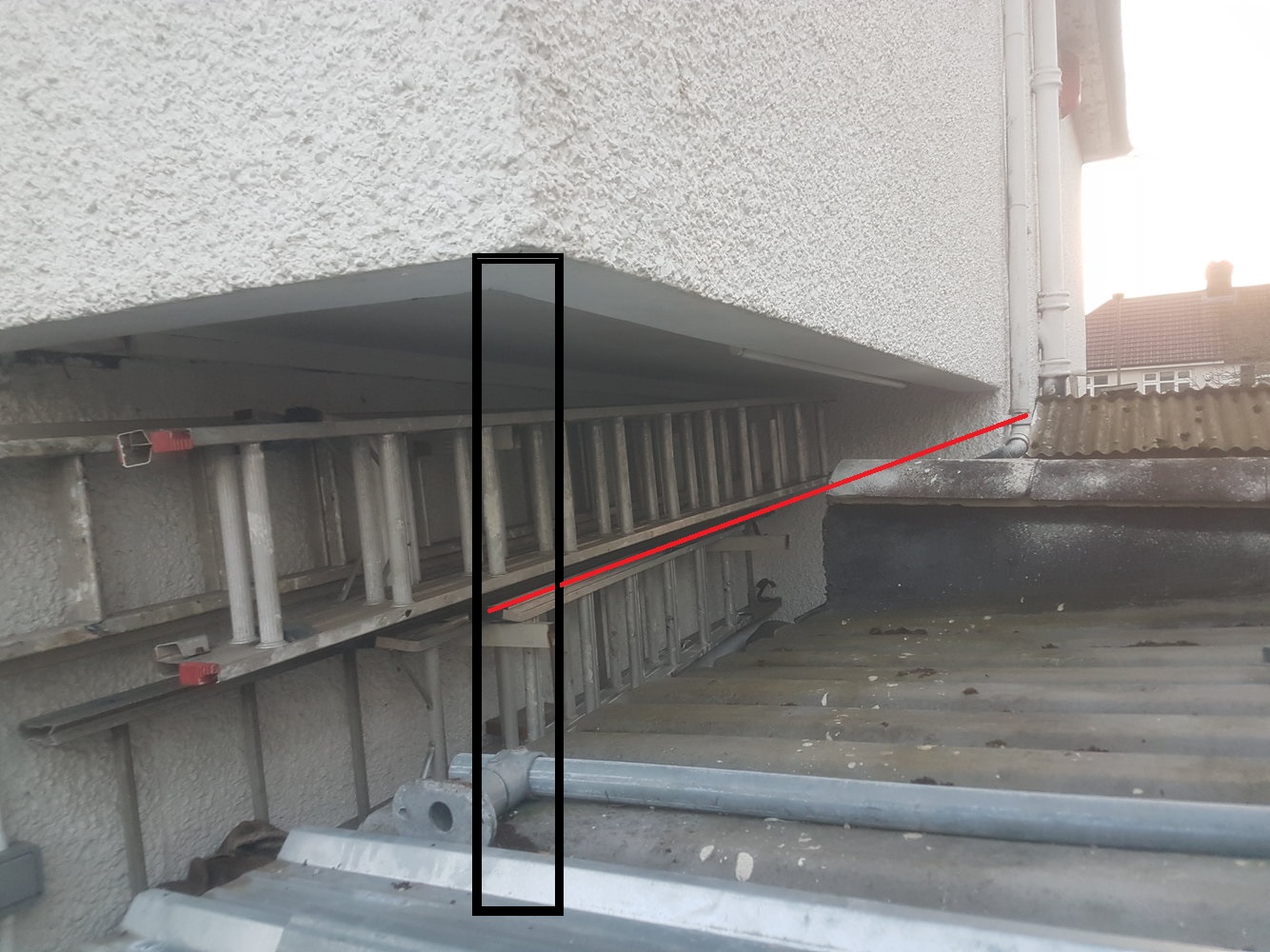

if you changed the fall of the roof which you can do and slope it towards the rear instead of towards the house
but i would advise the lowering of the wall frame
the wall could really be lowered if you didnt want it so high and just a sheet put over from one roof to the other however the other roof would have also need to be matched up as well

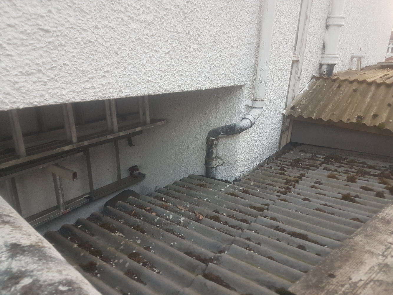

your downpipe will want moving though higher up as well as more into the corner of the house its bad enough with a soil stack but drain pipe can be moved
