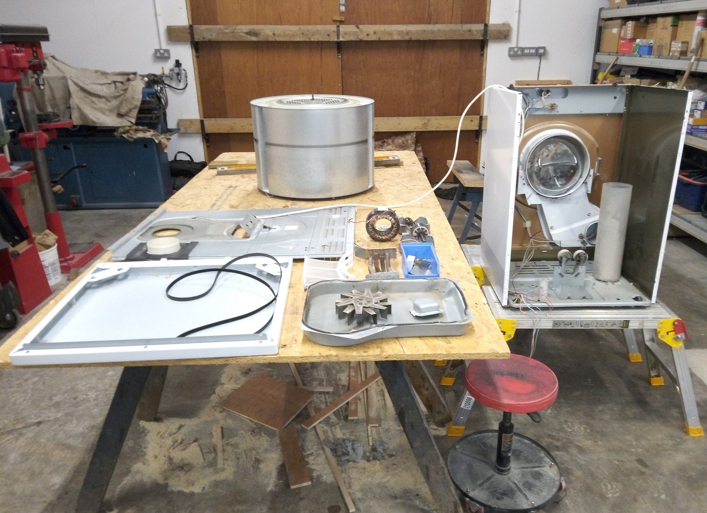

) which comes to about £100.We bought a Creda one from Rumbelows, remember them? When my son started secondary school to dry his rugby kit, he’s 46 now, both he & the tumble drier are still going. He’s a bit quieter, the tumble drier is a bit noisier now though!Of little help to you @Brad93 but coincidently I have a tumble dryer (a Creda) in bits at the moment too.
It's been a bit screechy for a few years but the other day it developed another noise so I decided to take a butchers. It turns out the new noise was motor bearings (well, one of them) which I've ordered for the princely sum of about £3.50 each. As long as the motor still works when I fit them, I'll splash out on some new felt seals, a drive belt, drum bearing kit and a heating element (I managed to break the old one by standing on it) which comes to about £100.
22 years old and UK made. Not bad really.
