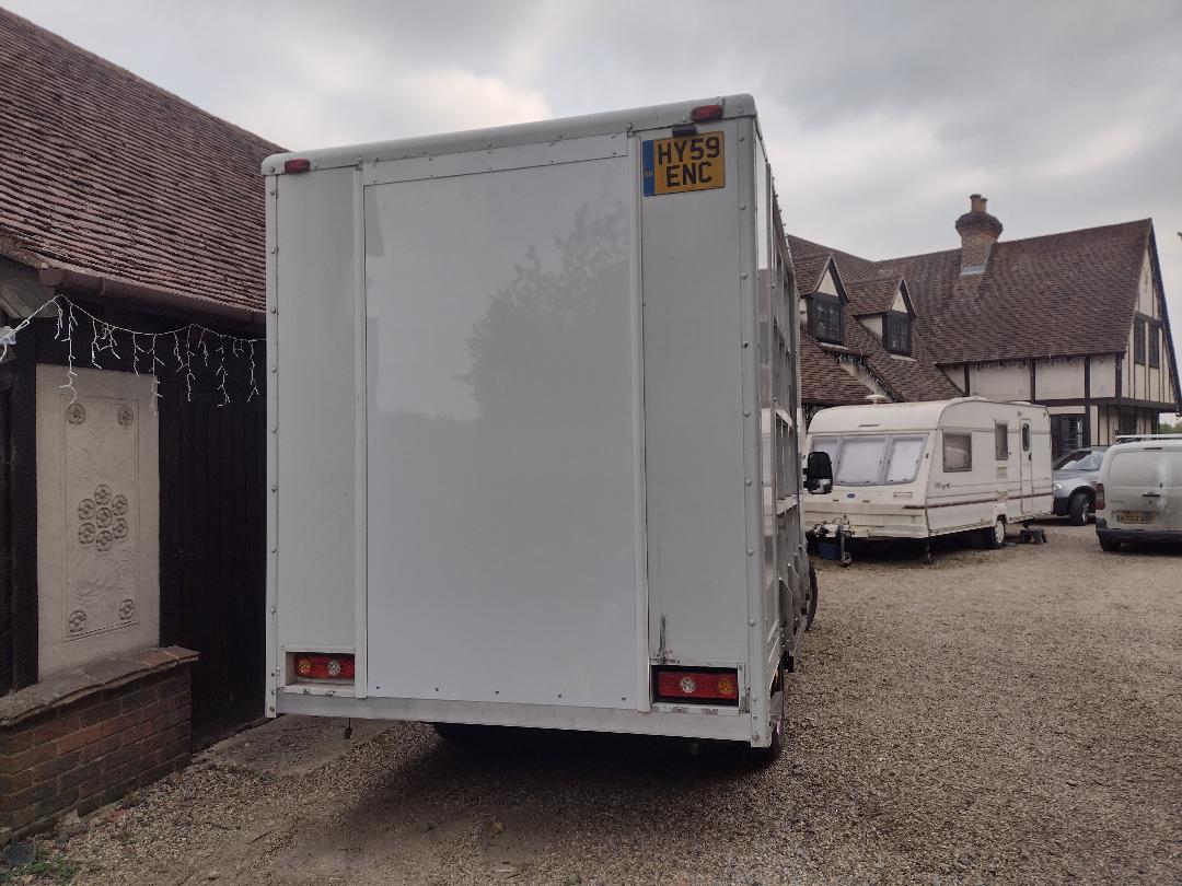

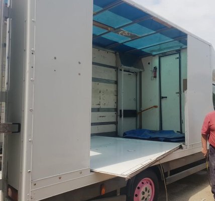

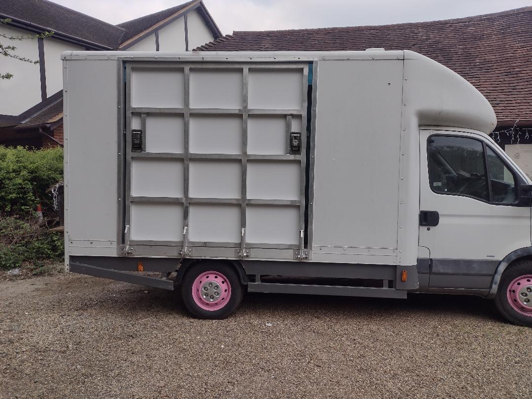

Passed class 7 MOT today, and I weighed it, gross, 2200kg (3500kg) front axle 1200kg (1800kg) rear 900kg (2240kg) 1/4 tank of fuel and me (not light), the side ramp will be square over the rear axle, if/when rear ramp fitted it will not weigh any more than the substantial rear doors already there, need to allow for partition, floor covering, side ramp steelwork, etc. etc. but to my untrained mind all looks ok?
I weigh the same as the owner and daughter combined, the bit cut out of the side with form part of the ramp so not all new material, has 1/4 tank of fuel, no real need to fill to the brim if you are loading up to the limit, take most water on board as you get to the destination, not shire horses, should be ok, if close, suggested driver to wear a low cut dress, her not me,That's only leaving you 1300kg for all the modifications, the horse, tack, feed, water, passengers, fuel, etc! It will be a close run thing!
