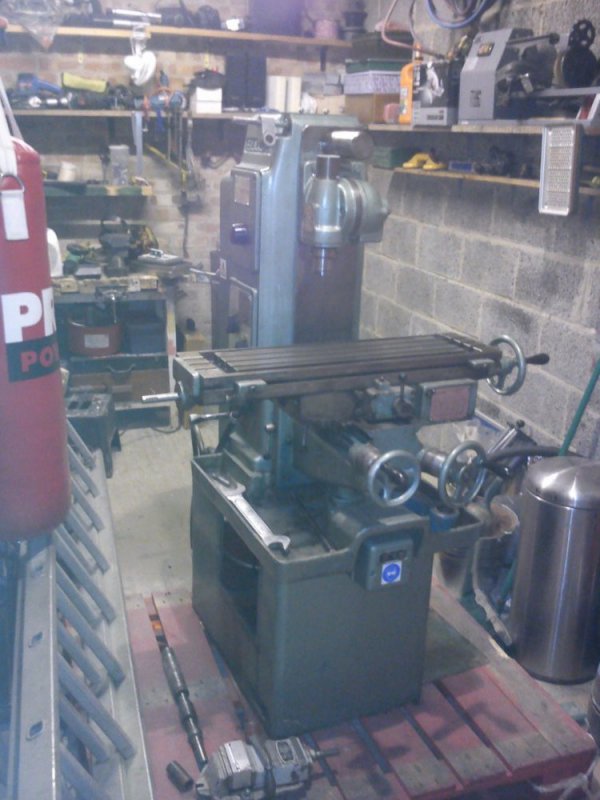

No, not by hand. The table & knee would have lifted off the top of the column which I probably couldn't do. Then the column will unbolt from the base but if you pull out the overarm you can see it's around 2" thick at the top.this is true but the mill was put together by man....could you not dissasemble it to the point it can be moved easily in sections and rebuilt on a steel box section frame.
I don't have an engine crane and I can't afford one but I'm confidant I could do what Shedfull said with blocks of MDF without it falling overThe safest way to move it is with an engine crane and some lifting straps, is it worth risking dropping it and braking it or worse having it land on you?
You will be surprised how easy it is in reality.Now that I like. We've got loads of paving slabs destined for the tip, I could stack them up and shimmy it onto them, then pull the pallet out and replace it with a lower stack of slabs, then take one off the first pile again. Easier said than done.
That was if the pallet wasnt in the right location, I did say if it was in the final room you can pinch bar it round on the pallet still. I really wouldnt leave a machine on a pallet as a long term plan myself, theyre not as stable, sooner or later if its big enough the pallet might give way, you cant level the machine off properly on one (yes for a mill I rough level so at least the suds goes down the table drains properly), they get in the way, get swarf stuck in the dead space etc.Why do people think he needs a pallet truck? its getting it off the pallet thats the problem....well he thinks it a problem.![]()

Leave it on the pallet and work it towards the wall the area it in now and rearrange your shed/garage.
Or still leave it where it is and rearrange the crap thats in the way like your ladders and punchy.
I like that idea, I might have do do that some time in the future.Rather than use a pallet, I made a quick frame out of 50mm box so I can get a pallet truck underneath it and move it around. I did this for my rapidor, that way you can leave it on permanently without tripping over the pallet and its more stable than a pallet plus some machines are a bit on the low side. Works well in small workshops. Before I moved into the barn I had a tiny workshop where I had to move the bandsaw to line up with a different window to feed material in and out![]()
A long crow bar, normally around a 1500mm length of 32mm tool steel with a point forged on one end and a chisel on the other.The punch bag is not there any more, I don't know why I ever wanted it TBH. The ladder will hopefully be going back to my nan's soon. There's no way I could leave it on the pallet, it's a trip hazard, it rocks about and it makes the whole thing 6" higher & I'm well overdue a growth spurt

I might get flamed for this and I probably wouldn't do it to my machines as I don't think I'd be happy with the stress I'd be putting on it, but...
How about making a couple of temp trestles from box section. Place these either side under the ends of the table.
Then use the knee Z axis to lower the table onto the trestles I.e. Raising the whole machine. You can then remove the pallet and then lower the mill to the floor.
All in a controlled manor.
It's a nice idea but it would put shear stress on parts designed for a compressive load and vice versa.I might get flamed for this and I probably wouldn't do it to my machines as I don't think I'd be happy with the stress I'd be putting on it, but...
