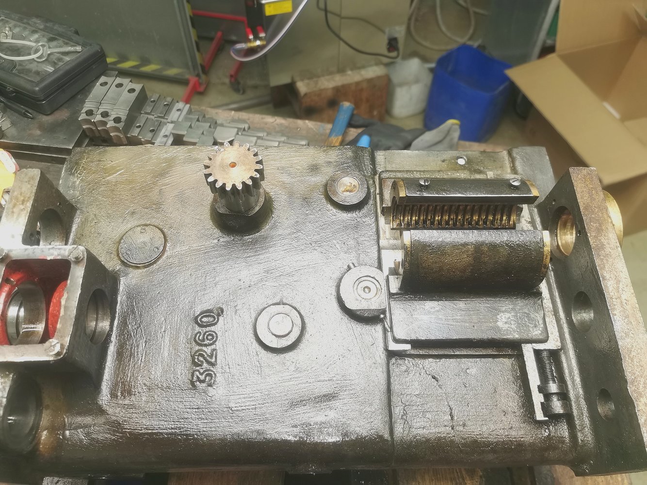

Peter, here is a sneak peek at a bushing I have already done - it is part of a compound gear that lives in the apron feed gear train. The oil enters the bearing through two holes in the root of the gear teeth. The mating gear acts like a pump and forces the oil through the hole into the oil...
