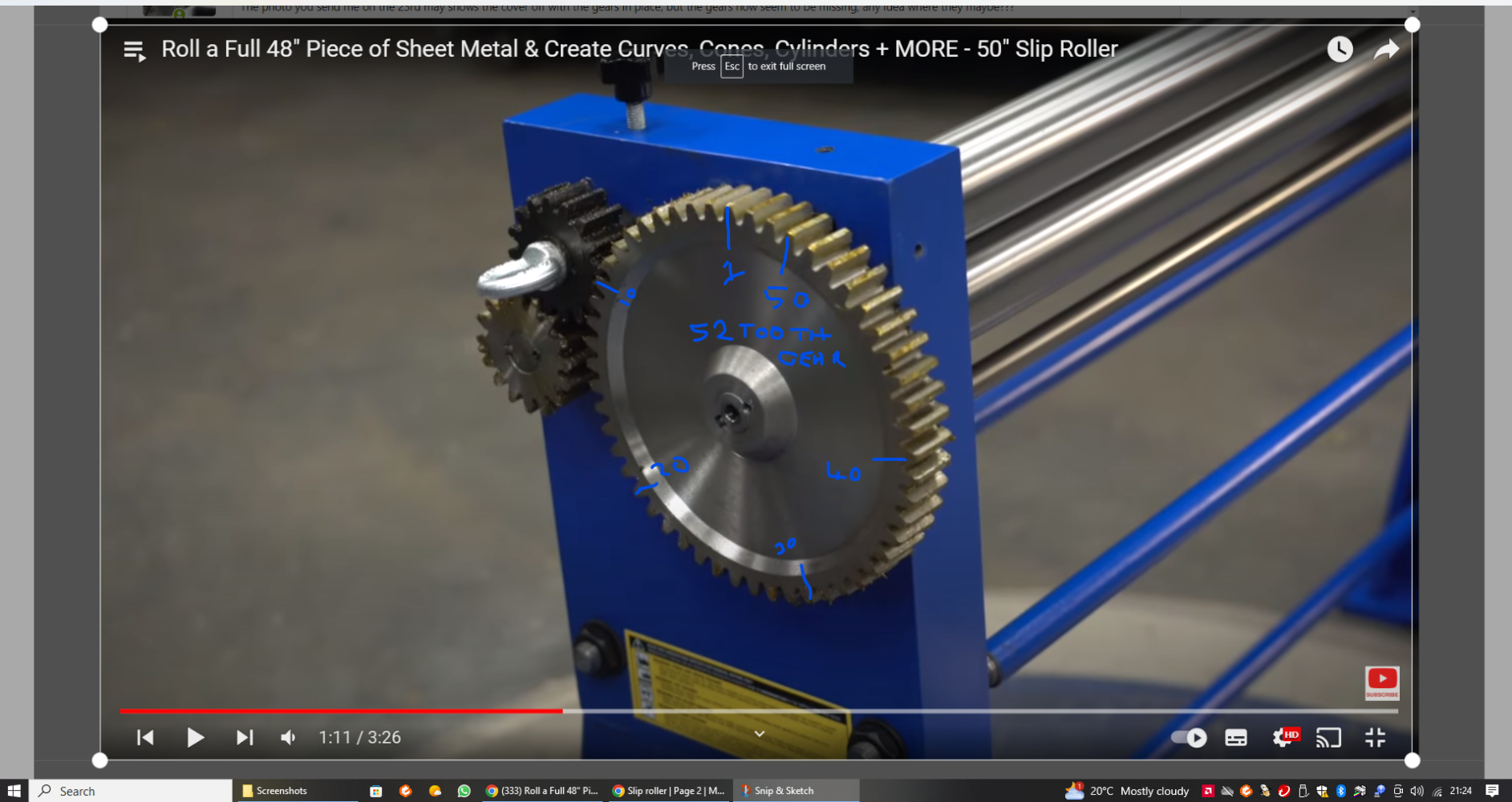

I'll have to dig out my sheet metal roller and do a bit of measuring, l need a large reduction gear making.No but it could be. What is it you need?

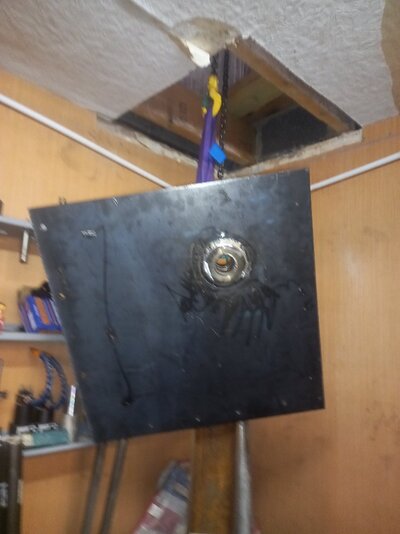

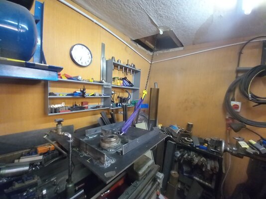

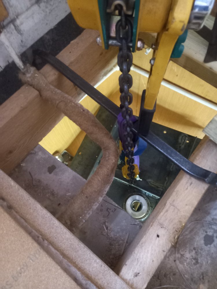

It only needs to lift 250kg max

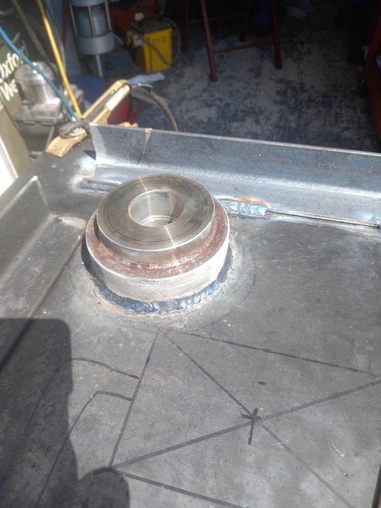

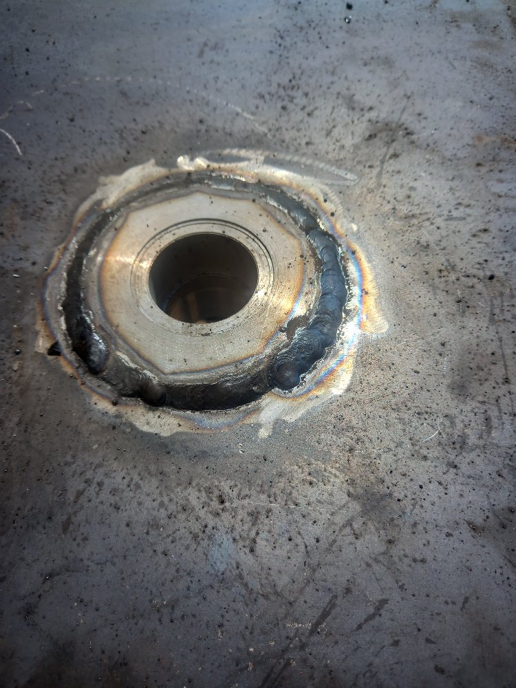

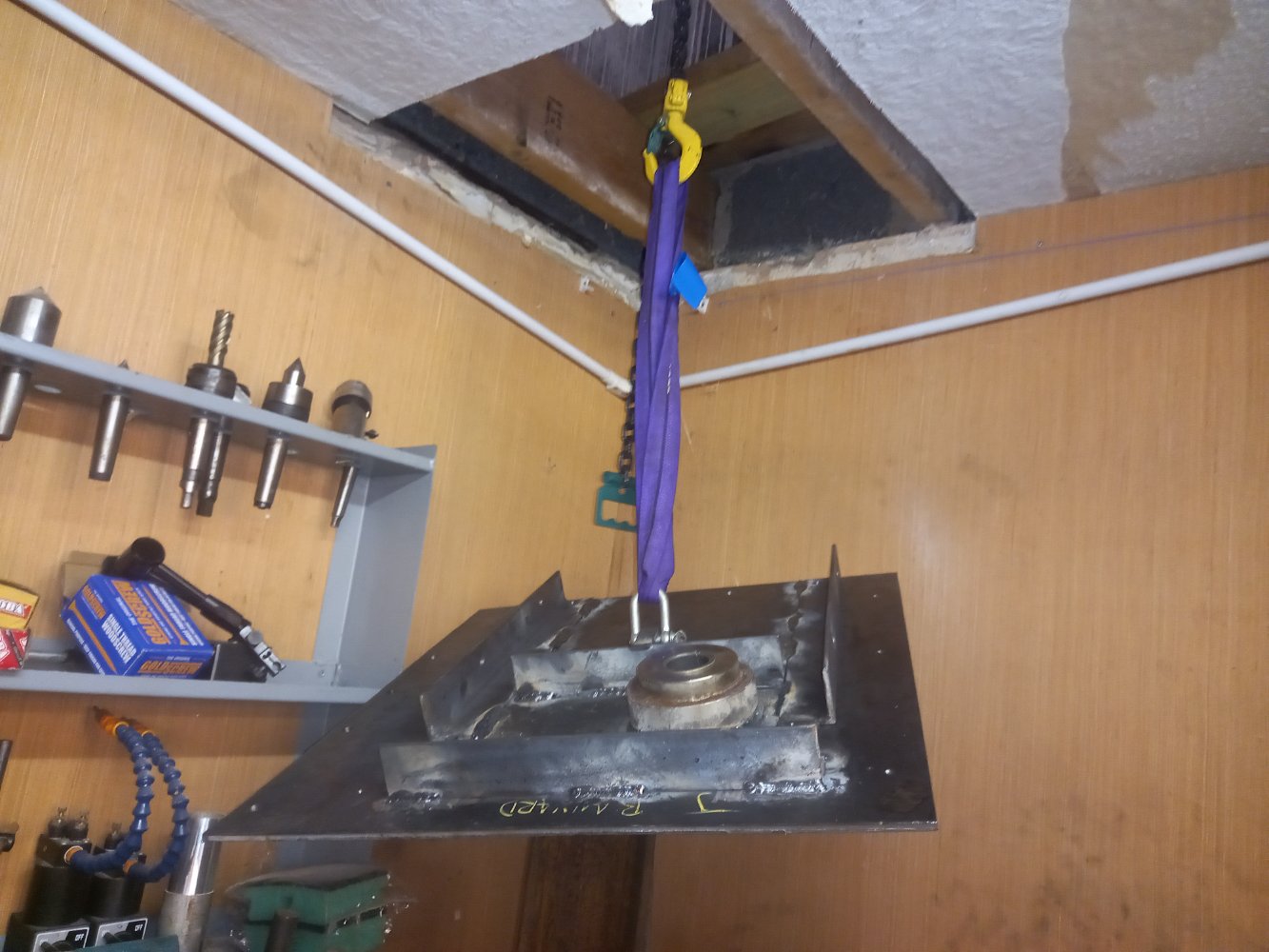

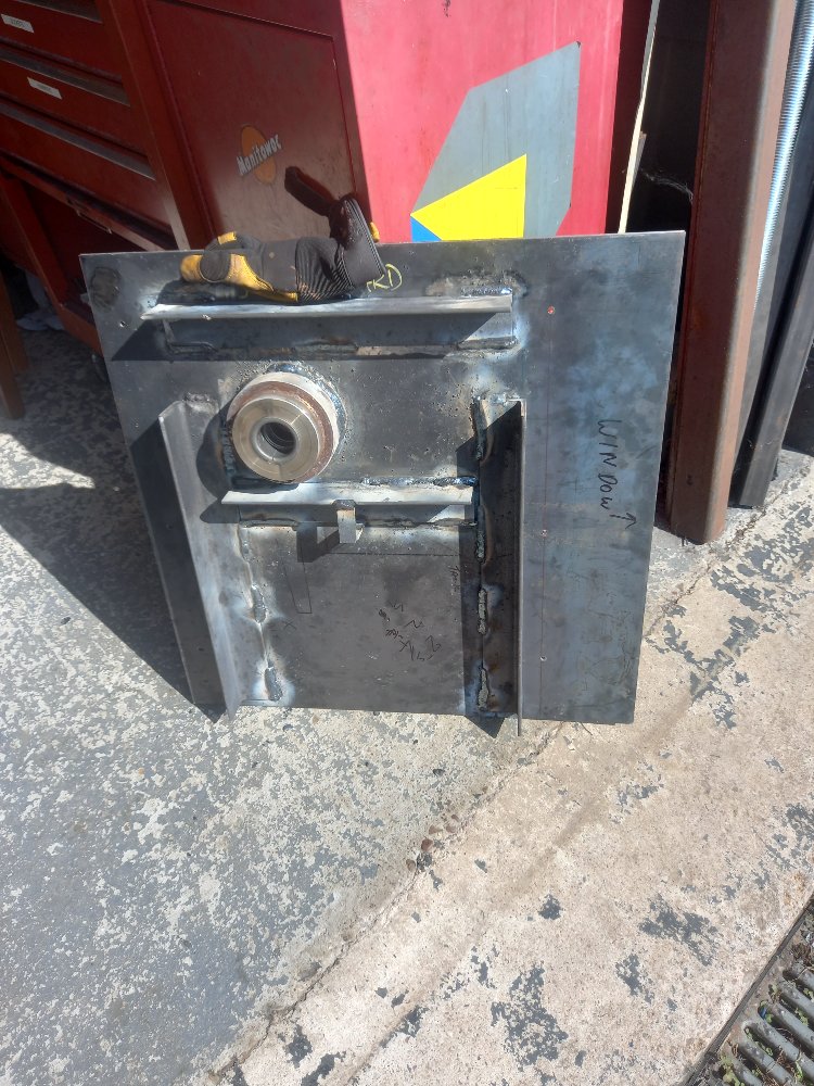

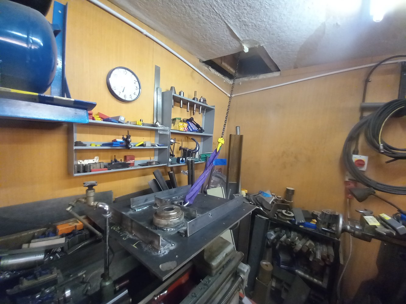

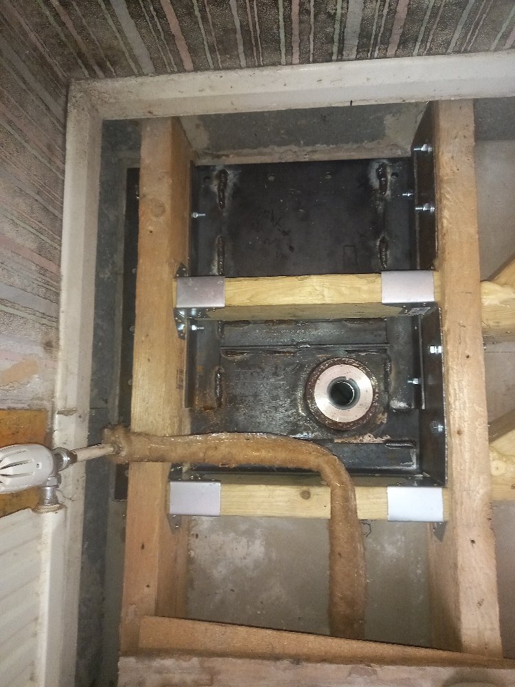

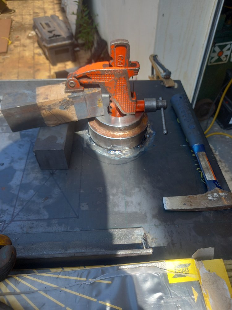

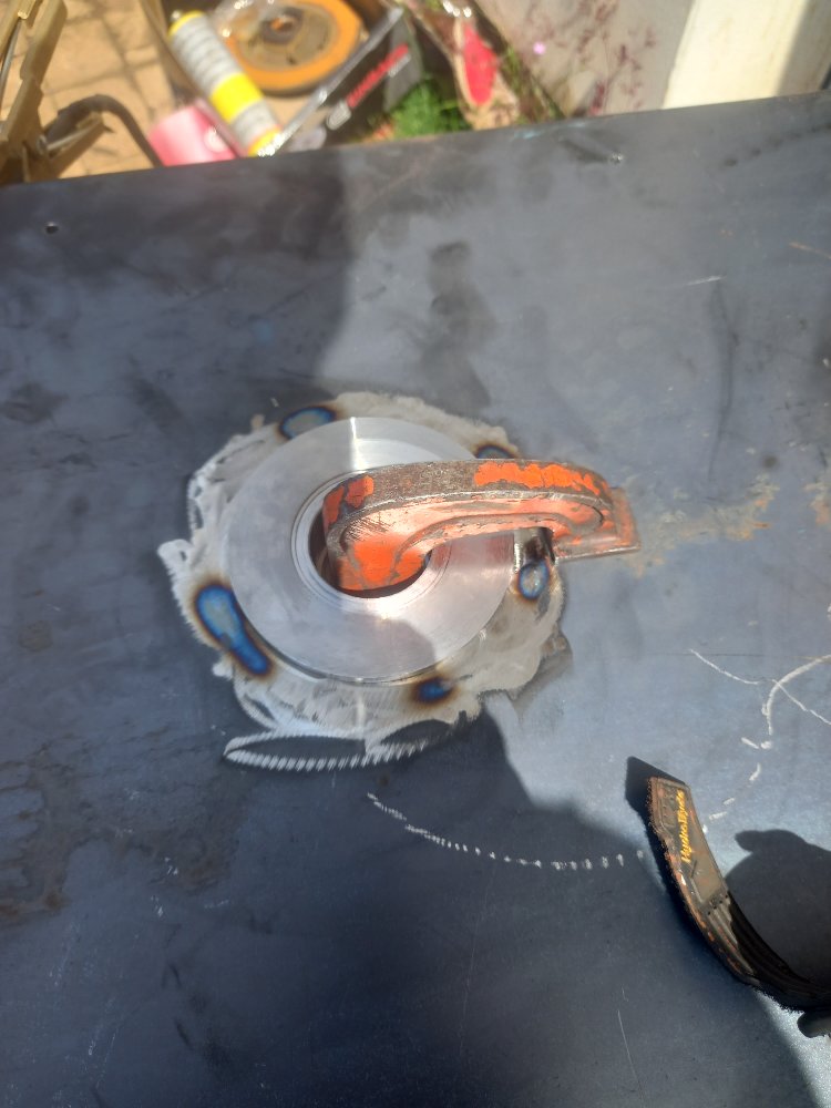

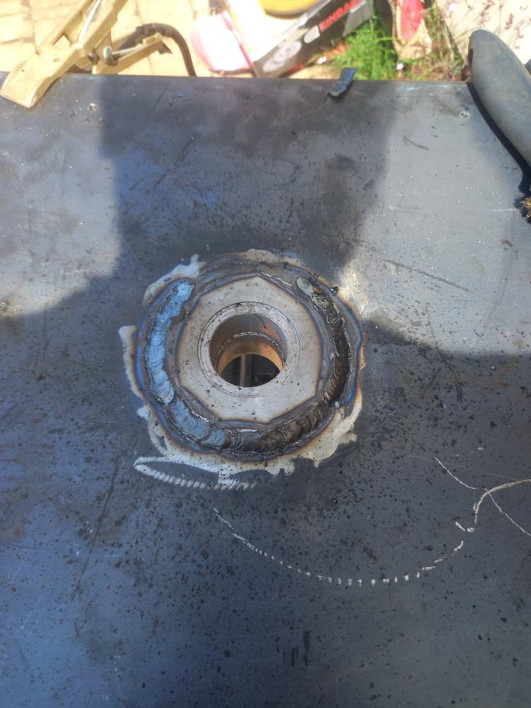

Done a bit more today turned up the bush for the top mounting pivot pin and cut the locating hole in the top plate for the bush, just need to weld it in later.

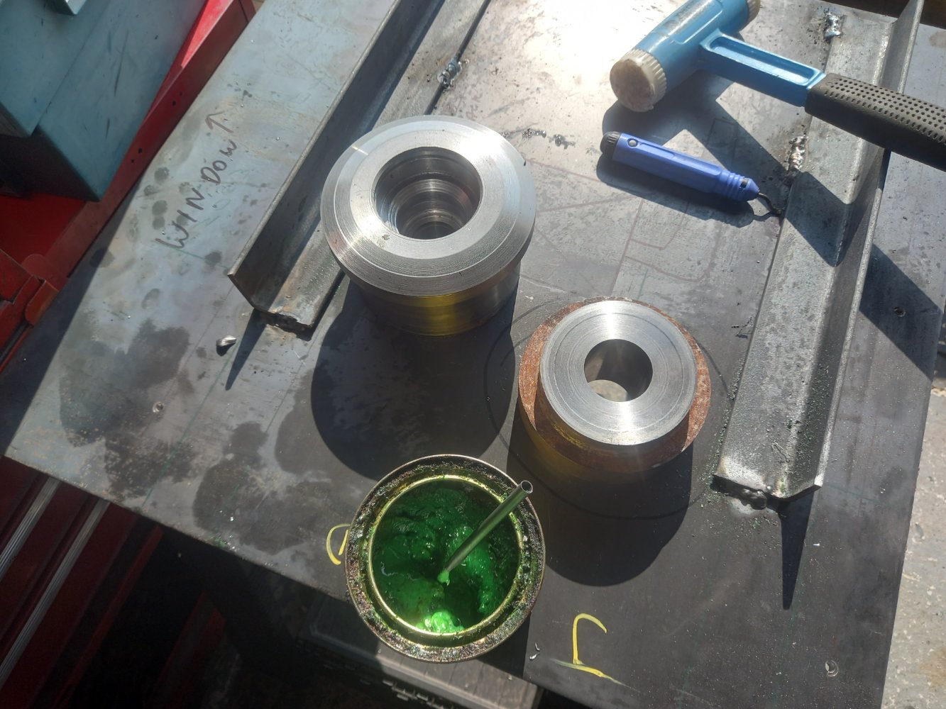

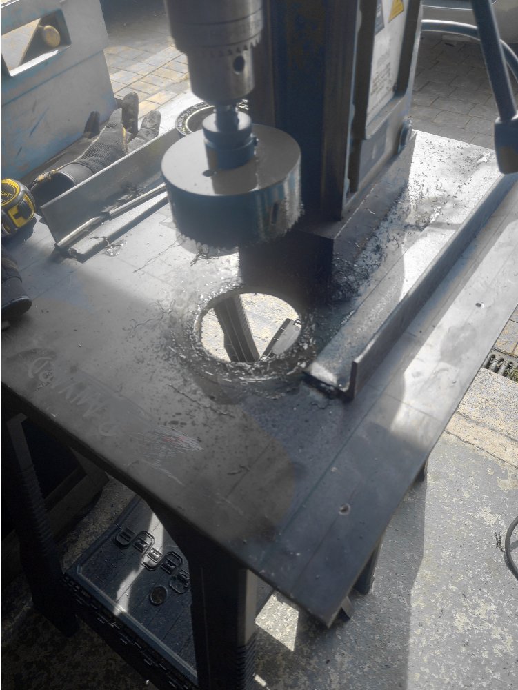

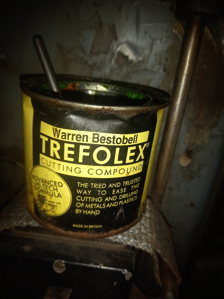

It's a cutting/threading lubricant jelly, I find it works well for drilling in the lathe and holesaws in the mag drill.What's the green stuff in the tin?

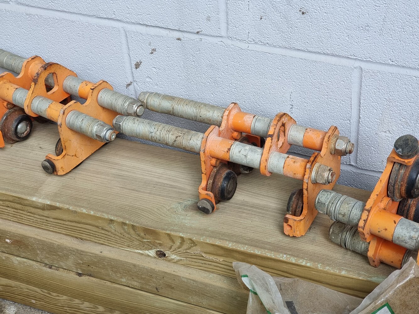

Thats true but I think its very rare someone would use a UB i cant remember seeing one used for that purpose , RSJs tend to be more commonly available second hand tooYou really need to make sure that the carriage roller profile matches that of the I beam! As in if an RSJ with taper flanges or a UB etc with parallel flanges.

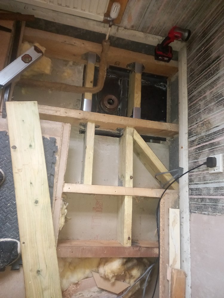

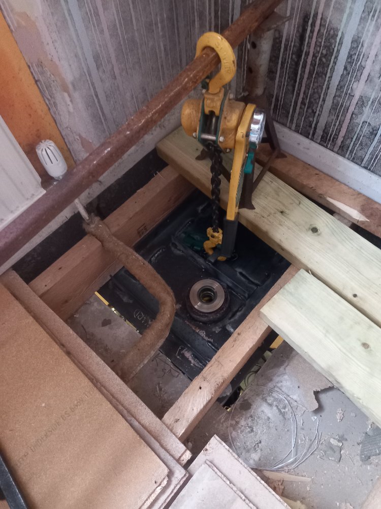

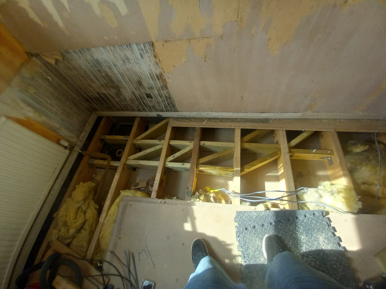

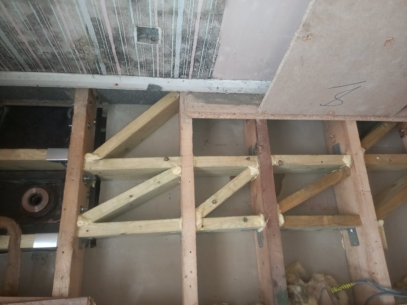

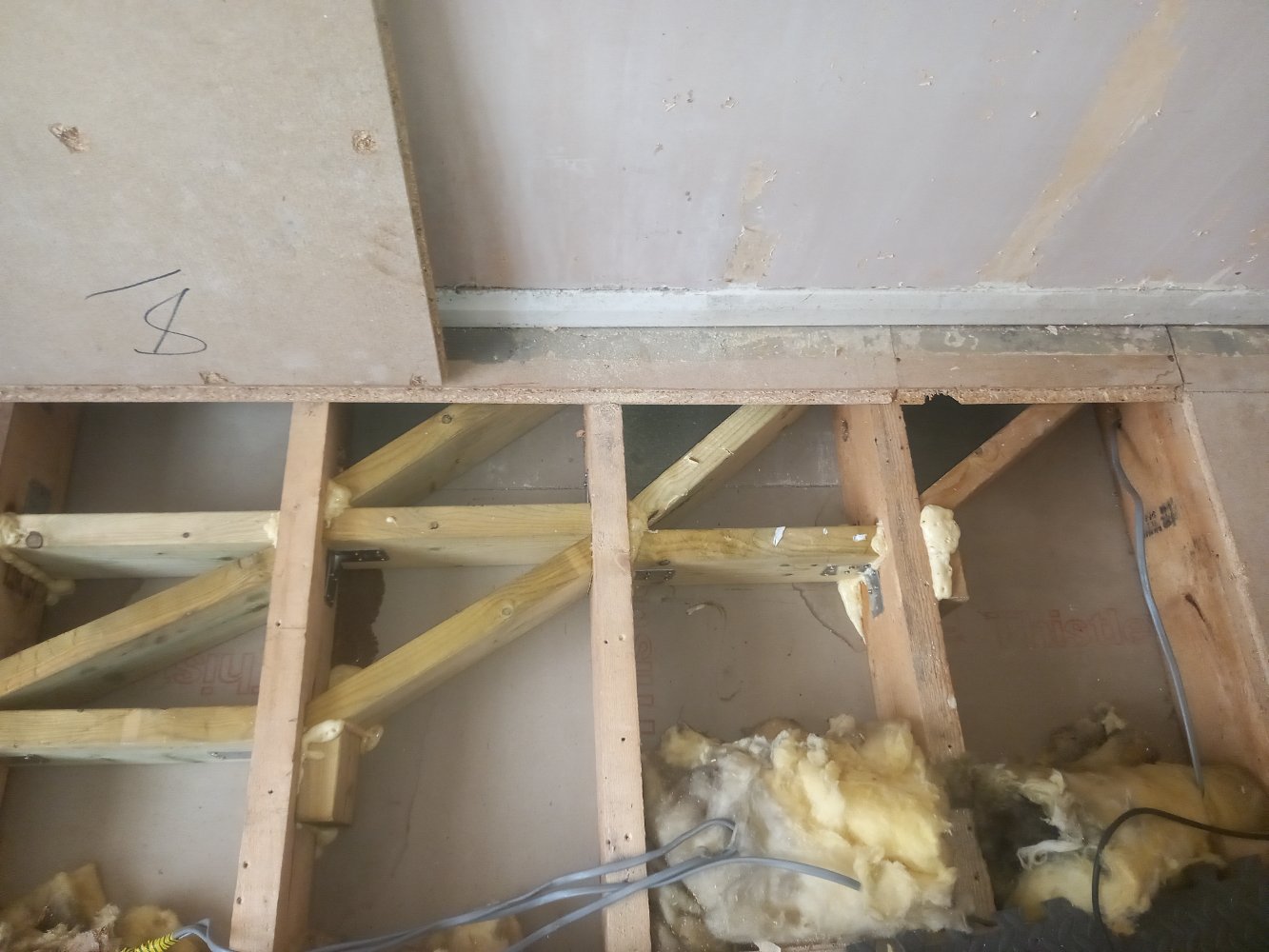

It's now down to the wood bothering bit next, strengthening the floor joists for sideways loading tomorrow......Looks well engineered that...![]()

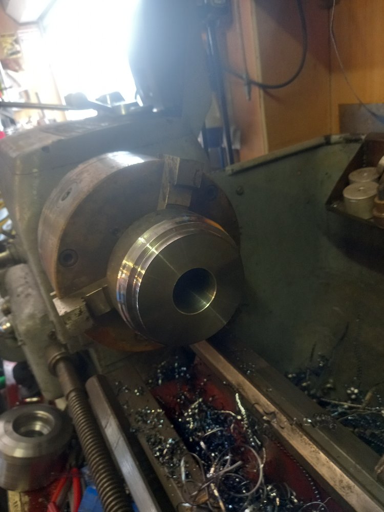

Are you keeping that lathe nice and cleanDone a bit more today turned up the bush for the top mounting pivot pin and cut the locating hole in the top plate for the bush, just need to weld it in later.
