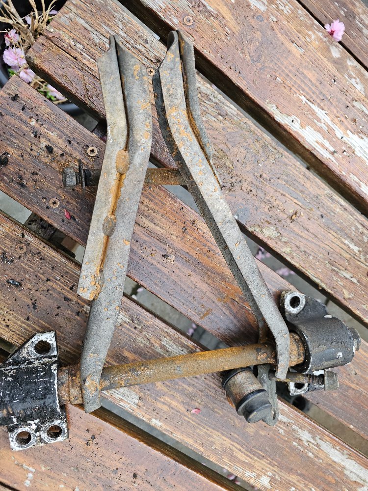

What are the bush housings made of?it's not aluminium
I can't see it's terribly critical, but just to avoid any misinformation, the original recipe was 40g of washing soda (=sodium carbonate), or 30g of caustic soda (=sodium hydroxide).1 litre water, 100g citric, 30g soda crystals.
I'm surprised there's any aluminium left.
Thought I'd give this a try, I usually just use citric on its own.
Test spanner. As found in the scrap
