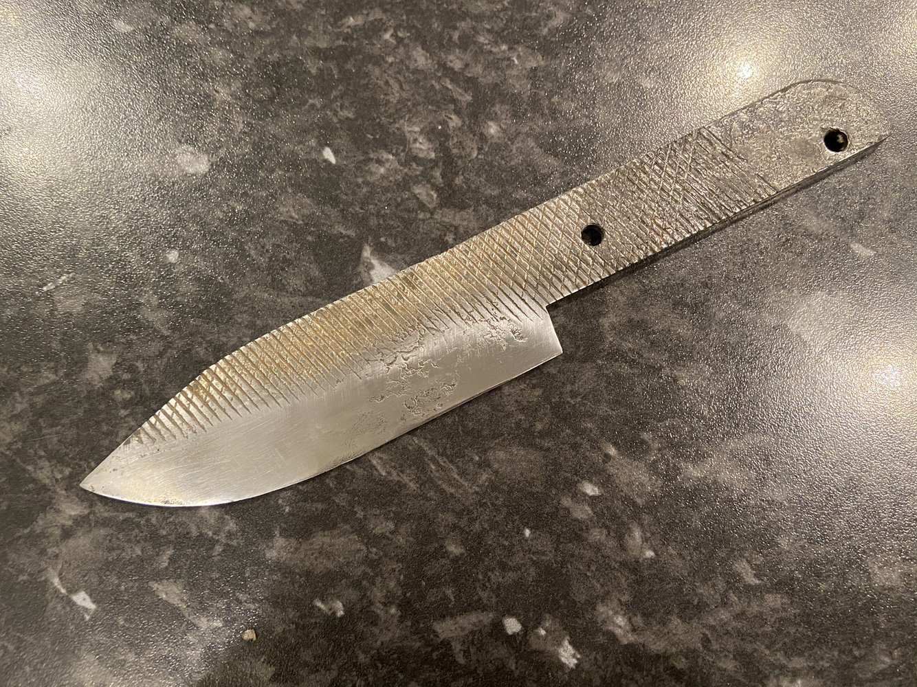

It’s not going to plan. The chopper blade is getting curved during quench. I’ve heated it up a few times and straightened it out then tried again. Same issue each time
what can I do ?
It was non magnetic each time, tested with a magnetic. I dropped the temp to 900 and it’s worked a treat. Currently tempering in the house ovenHow hot are you getting it to quench ? Have you tested it for magnetism again before quench you might be getting it too hot.

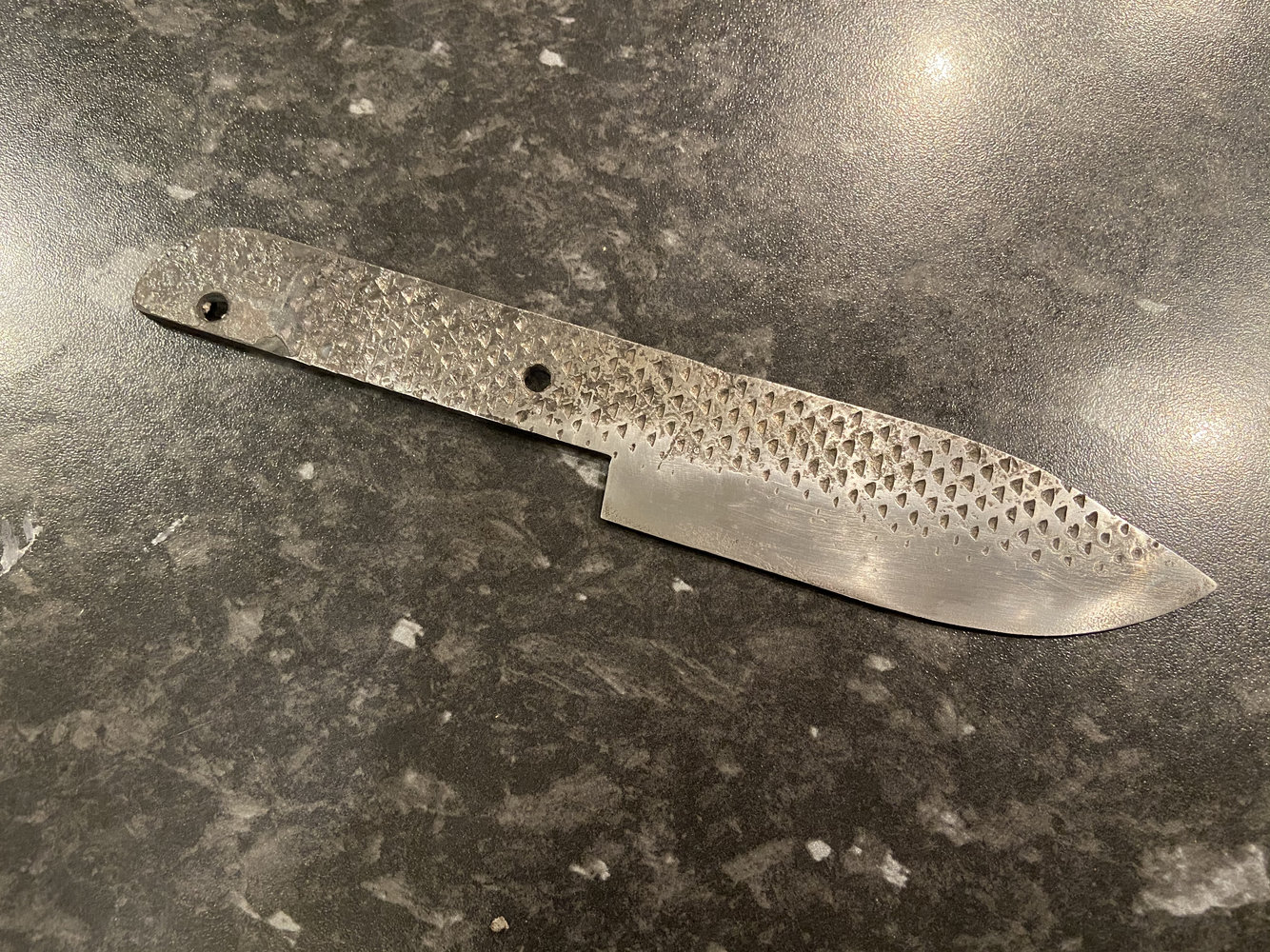

the rescued file blade has been tempted and a very quick going with 120, 320 and 400, then a quick buff.
View attachment 325142View attachment 325143

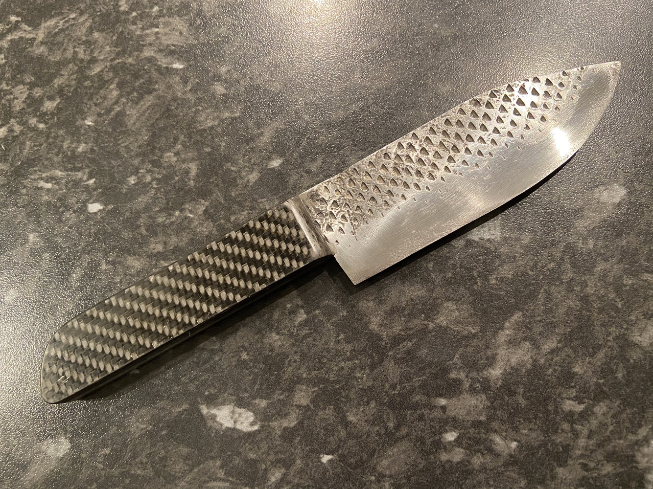

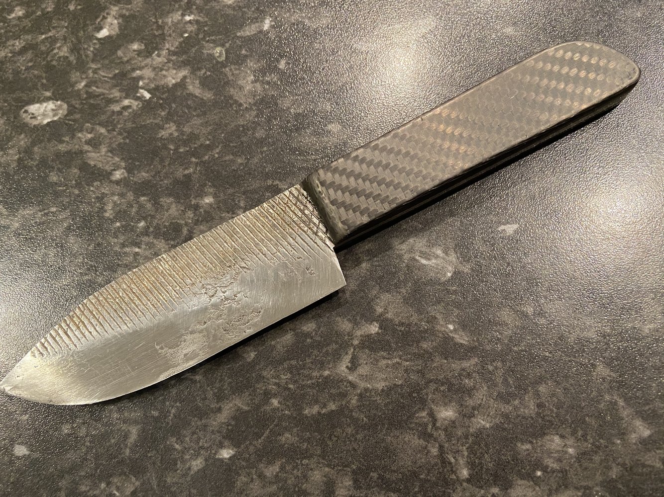

it’s by no means perfect and it’s rescued from a disaster. I’m happy with this so far and learnt a huge amount. Most important lesson is to leave some meat on the edge then grind off after heat treatment, it allows for removal of those imperfections.
While it’s not perfect, I’m happy with the results as this is the furthest I’ve ever got with a knife.
Ive got several boxes of farriers rasps so will have another go at making a camp style knife with a shallower and shorter bevel so it’s a bit more sturdy
2 part epoxy from the pound shopWell done.
How is the handle glued?
