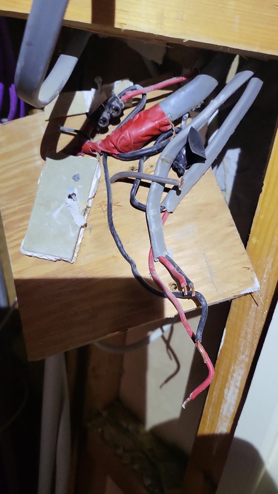

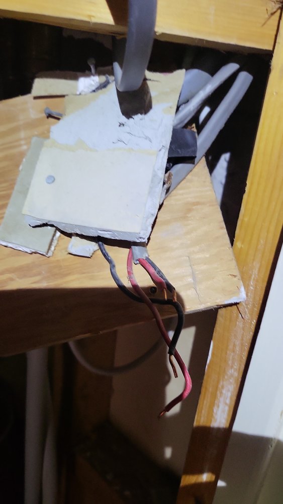

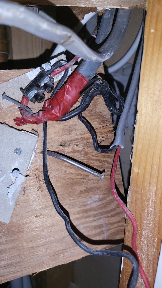

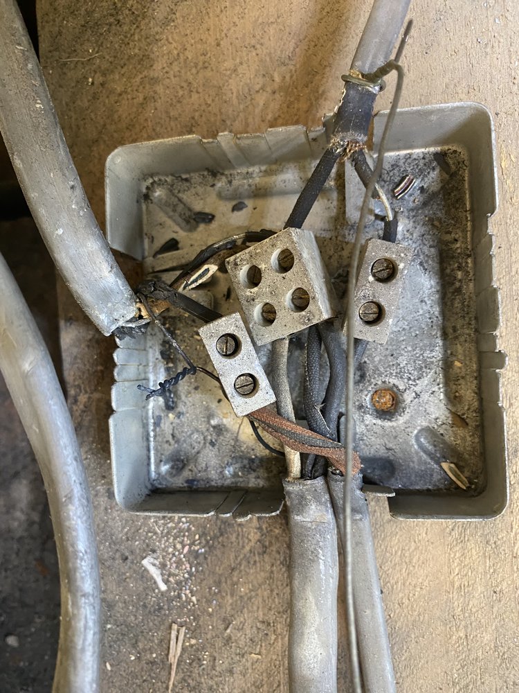

Ooh fun! They are some busy joint boxes, I bet the one in the second pic is a right squeeze inside!!
Ok so top pic, top left all reds = permanent live
Top right terminal all blacks = neutral
Bottom right with the two reds and one black = switch live.
So the black (should have red sleeve or tape on) with the two reds is the live coming back from the switch it's red core will be live to the switch so label that one as switch outside the joint box!
Also just noticed are there two earth's cut off in the cables on the bottom right!!
