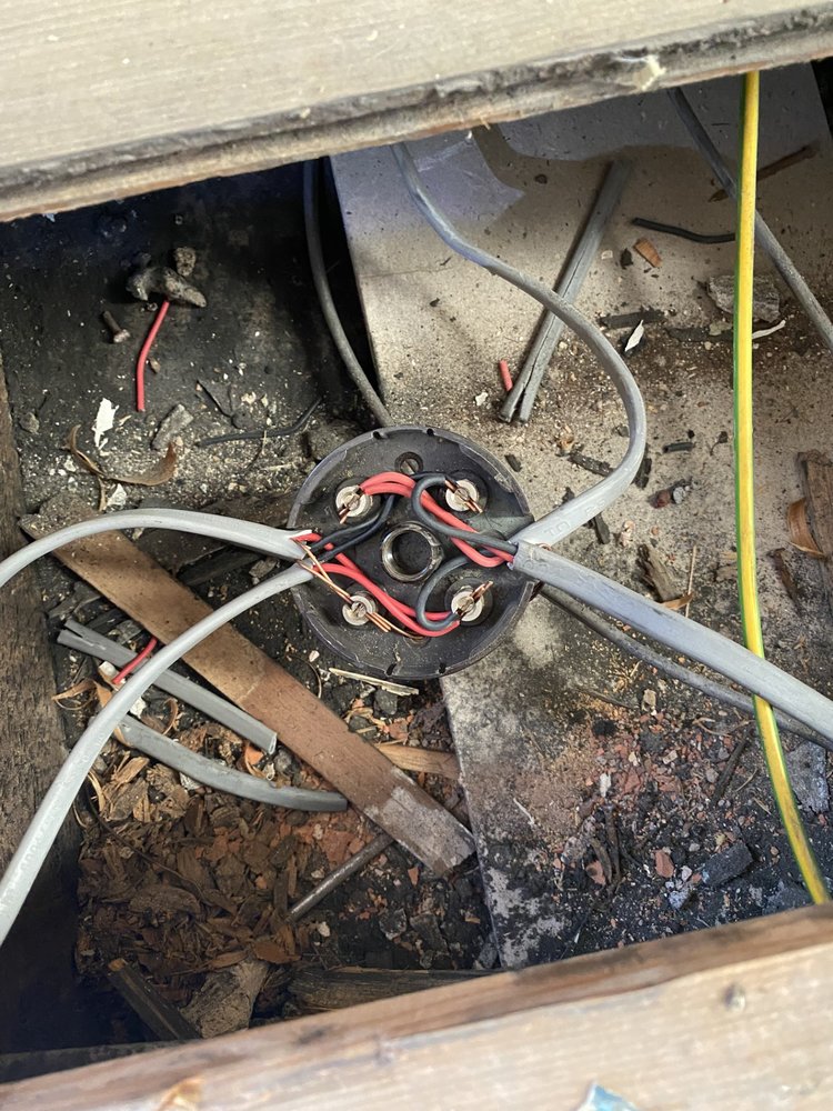

The old method of wiring lighting circuits with millions of junction boxes hidden away is pants.
So my pea brain can understand this, ahead of fiddling on Friday to put in new switches runs to somewhere sensible, this is the feed to two wall lights, each with a separate cable.
If the two cables on the left are feeds to the lights, is right/bottom the feed and right/top the switch cable?
