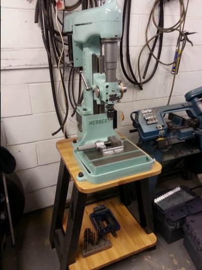

I'll have to pass on that one, I like the look of the quill feed being separate from the top of it but that's well out of my budget

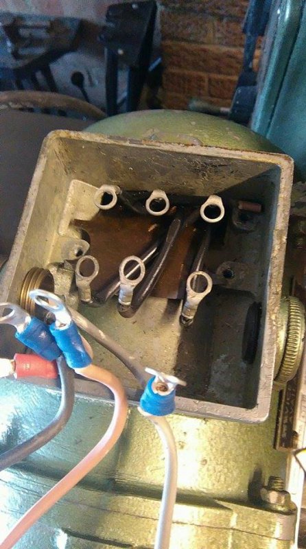

. It made a high pitched noise, then the inverter stopped and the display now shows "E.LF". I'm trying to find the fault codes but if anyone knows what I've done wrong, please help
.All wired in, I turned it on and...
It didn't move. It made a high pitched noise, then the inverter stopped and the display now shows "E.LF". I'm trying to find the fault codes but if anyone knows what I've done wrong, please help

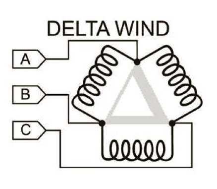

) but you don't have to change any values if your using different motor loads, windings or speeds. There was continuity between A1 & A2, B1 & C2 and C1 & B2. I think the connections for C1 and B1 are crossed over. I think swapping them back will sort it. There was no continuity between any other ones, none to the case and all the pairs are the same resistance.I must admit I was under the impression that the size of the motor doesn't make much difference, a 2hp motor will be drawing a fraction of that 2HP with no load. I guess there could be some optimisation if max load is known but I wouldn't have thought it would stop it altogether.
You can check the motor with a meter, make sure you can see continuity between A and B, B and C and C and A. You should take the metal straps out that converts it from start to delta otherwise you will also see B to A via C when measuring A to B. Also the resistant of each winding should be similar and if you have the straps out there should be no continuity between windings. Also check they don't go to earth i.e. the casing etc.

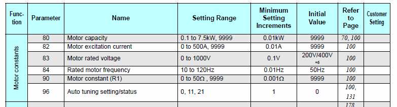

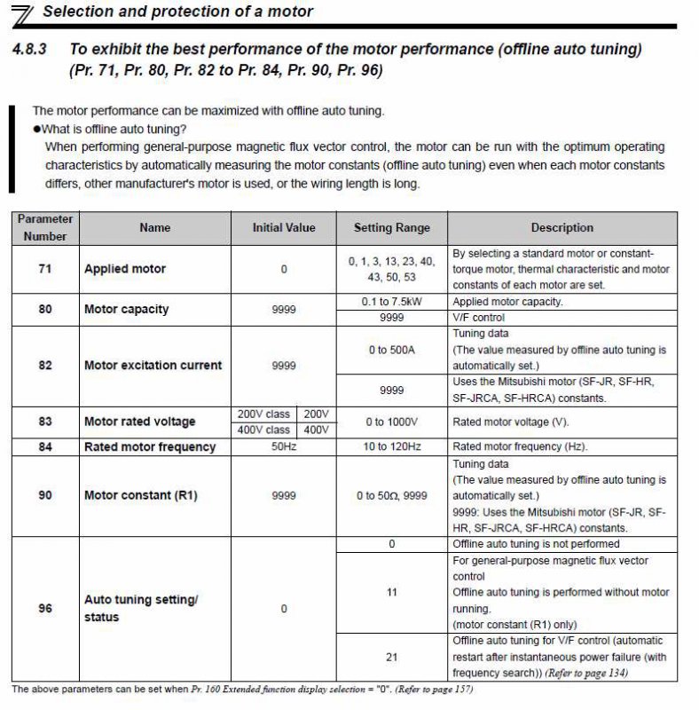

. I haven't touched the settings in the inverter, just sorted out the motor and it came straight on. I'm reading the instructions to see if it can hold settings for more than one motor as it will also be used to power my lathe and hopefully another drill.If I had a three phase mains supply, would it have this protection?The power rating won't (shouldn't!!) stop it working but it will provide protection for the motor. It prevents the drive from overloading the motor in the event of a stall or fault.
