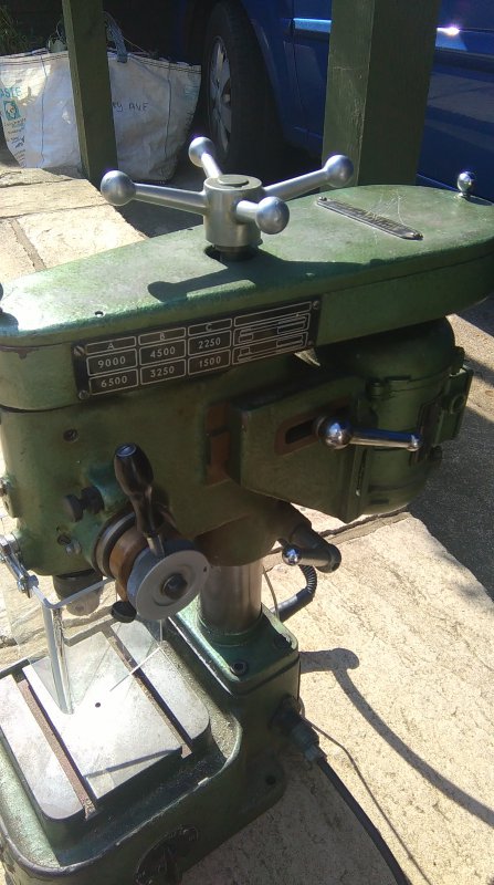

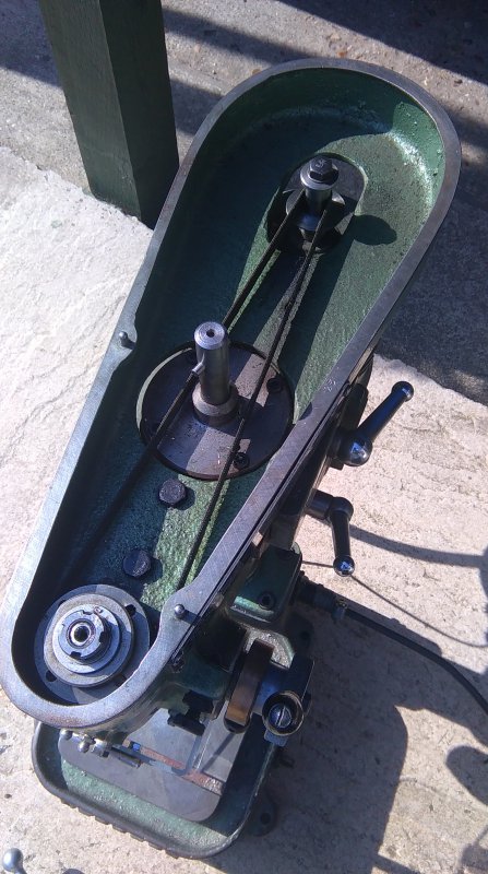

Have a look at a raglan vertical mill, that uses variable pulleys, but without springs etc. One half of each pulley is connected by a Z bar so when you open one you close the other. Operates with a lever with a lock. Brilliantly simple and super quiet too.
or has the thread gone that long ive forgot half.
