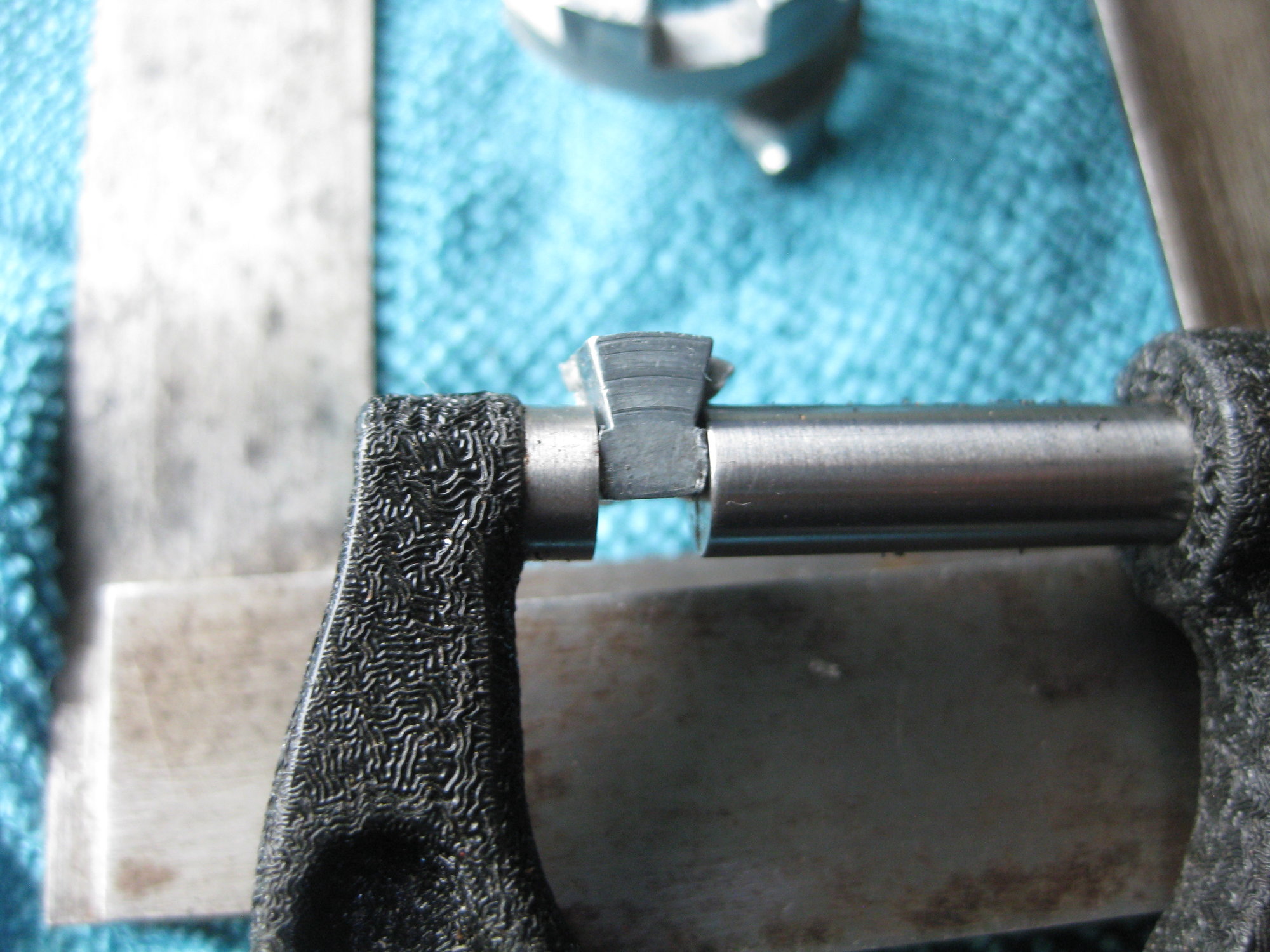

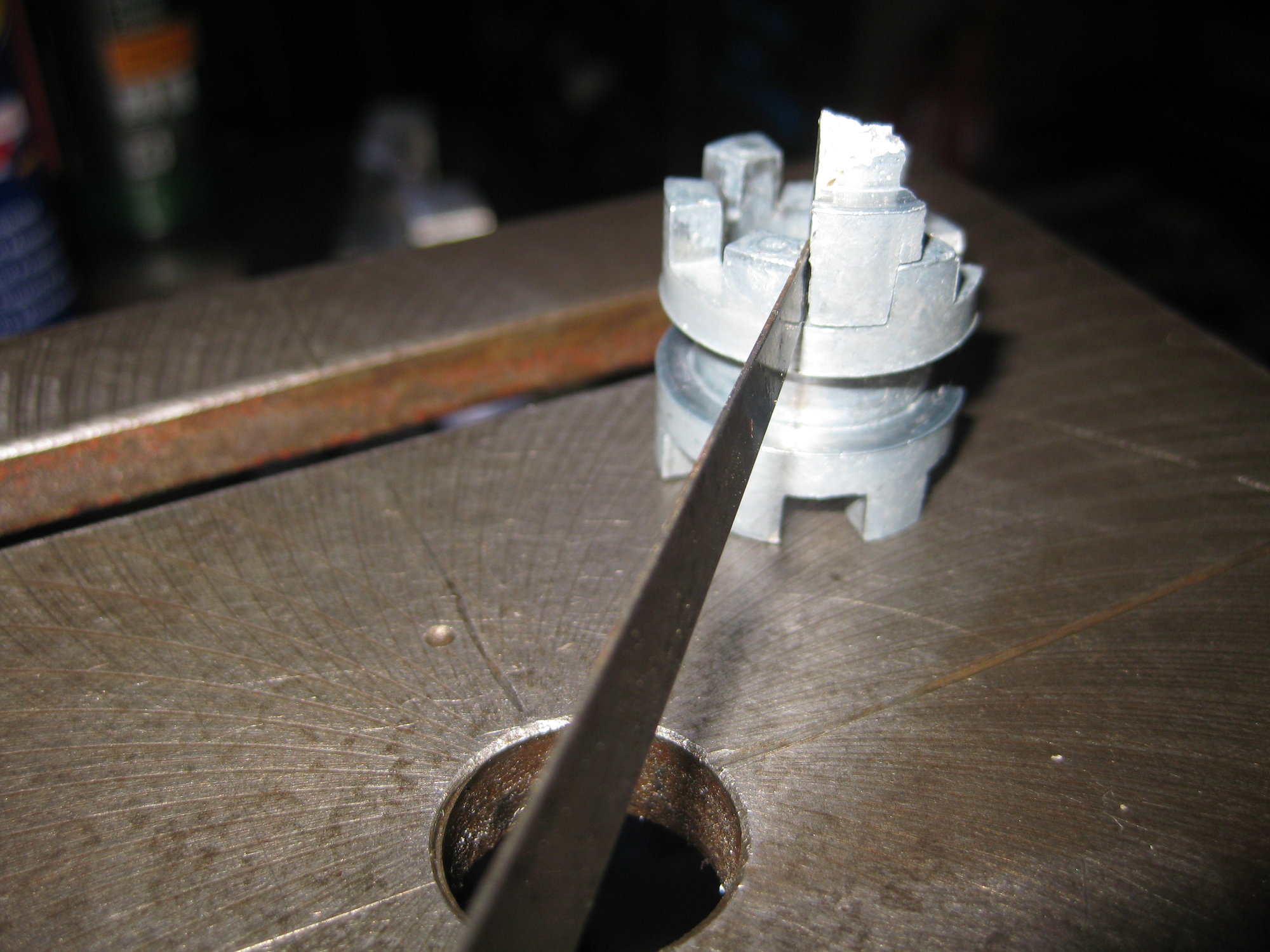

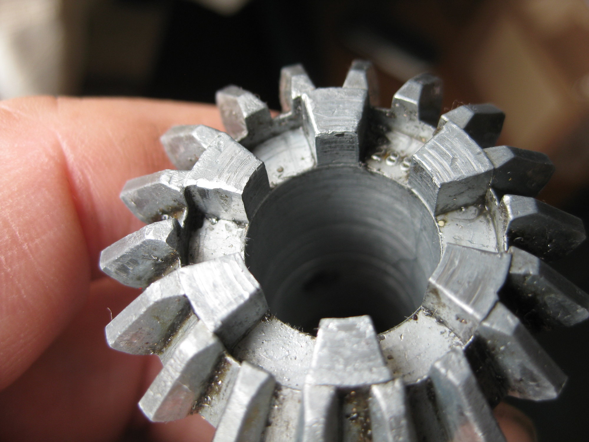

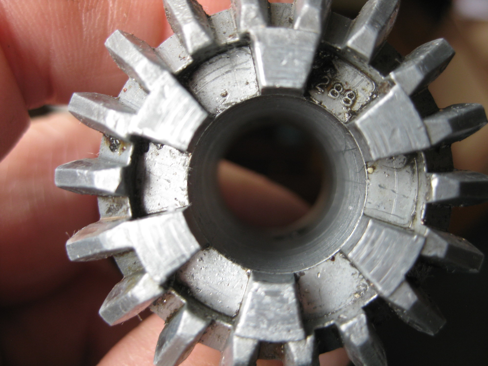

Hi . I've taken a series of pictures to show hte clearance of an inverted broken tooth between two still fixed teeth I can push a 20 thou feeler tip in so it cones out the other side ..suggesting each tooth is a tad smaller another picture indicates that as I've said the teeth sides are not machined verticals but have a tiny slope inwards to give a bit of meshing lead in when the parts are moving .

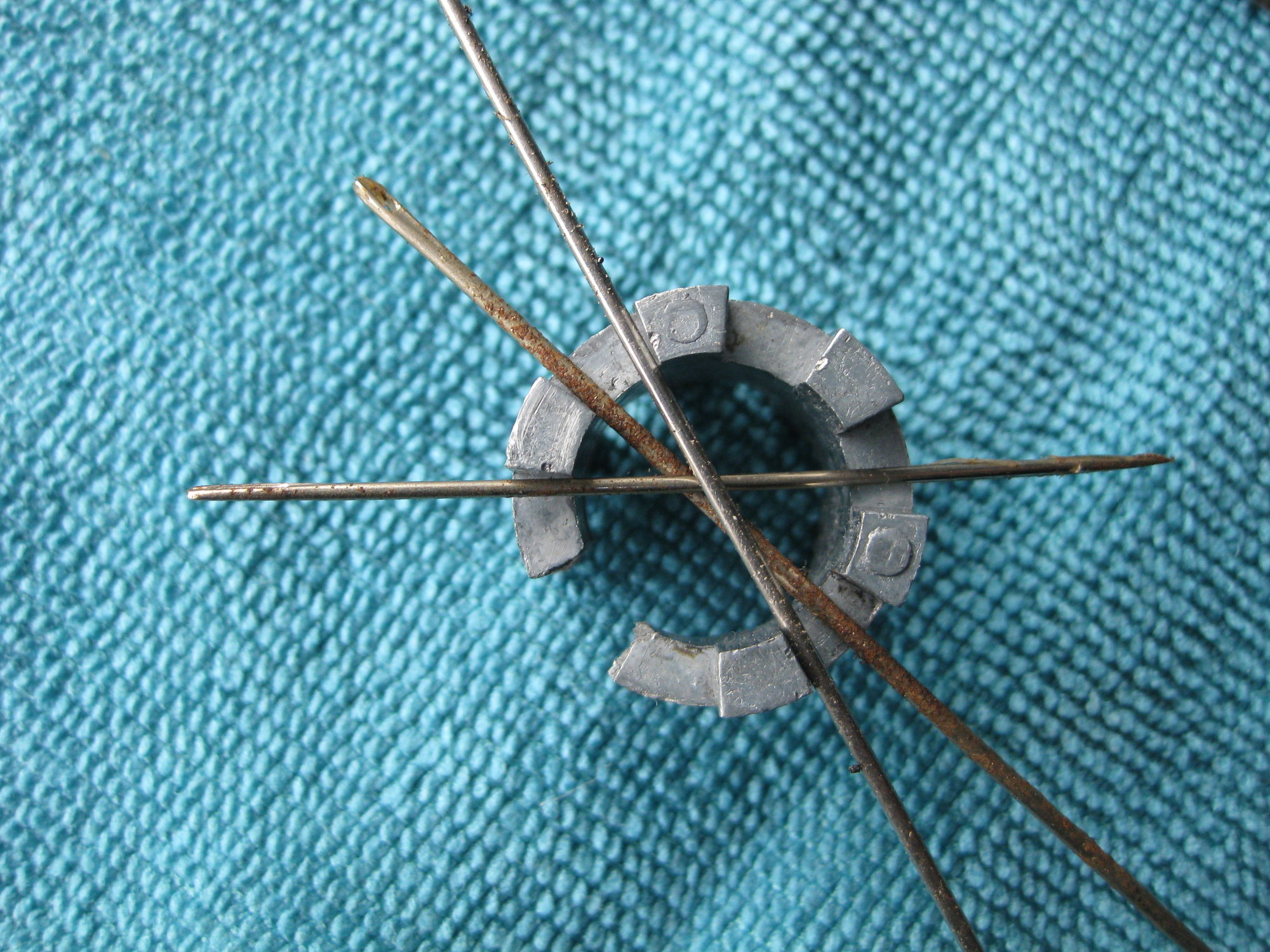

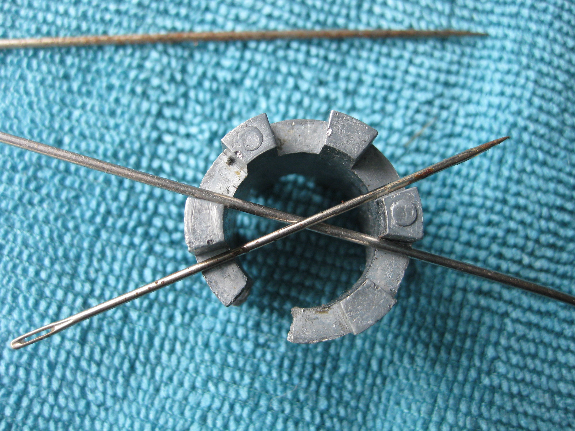

The picture with the rusty needles is a bit misleading for the broken body is more like a badly drawn 6 than a perfect circle .
See what you think .. had hoped for some sunshine for better pictures but had to give in and take them just inside the garage door whilst it's mizzling & very over cast .

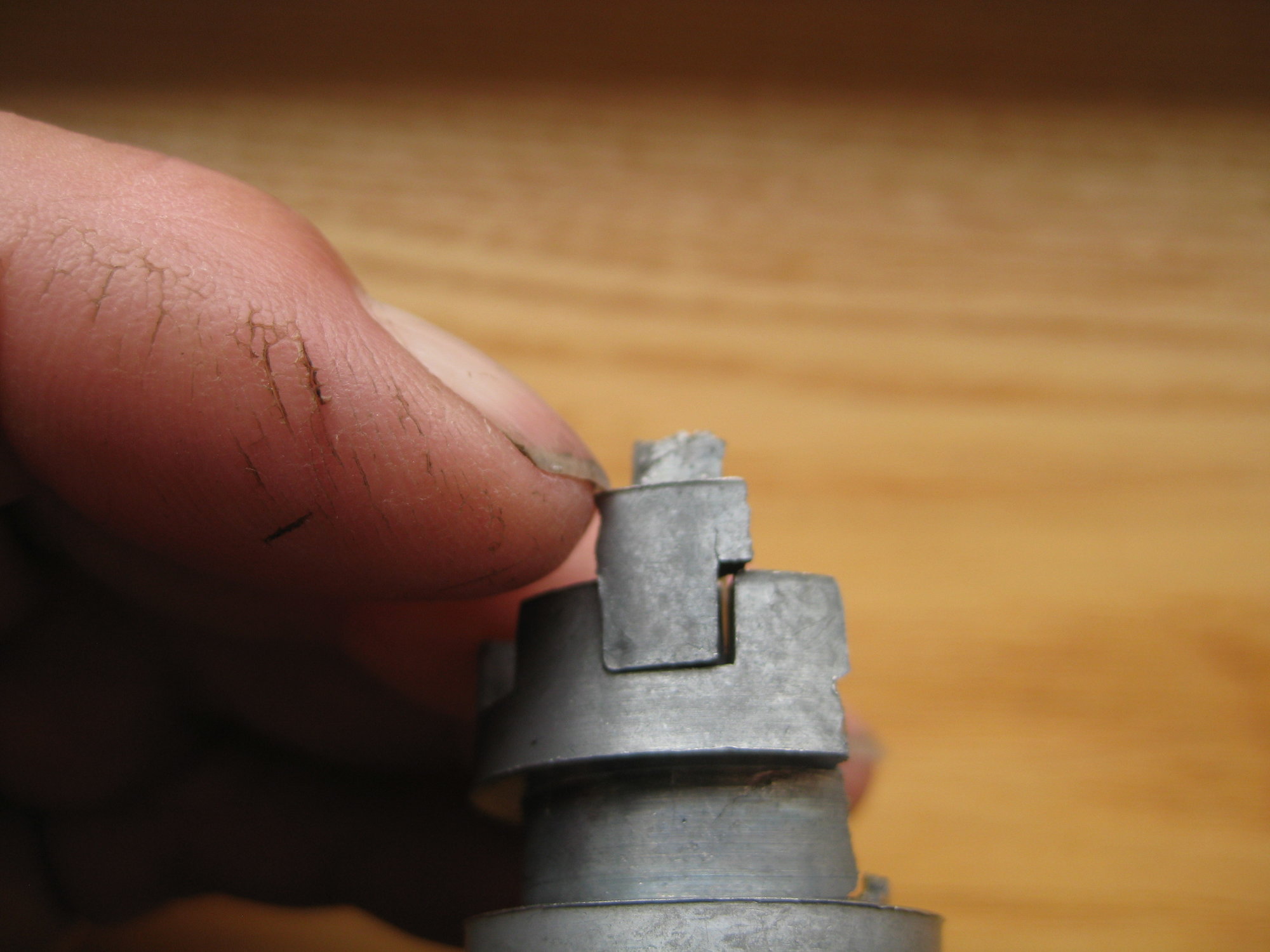

Pictures Top 1
broken tooth between two good ones shows a gap .
2nd
A 20 thou feeler just slips through the gap.

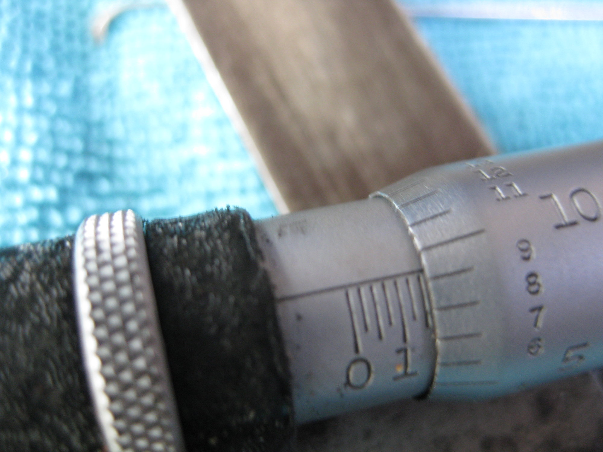

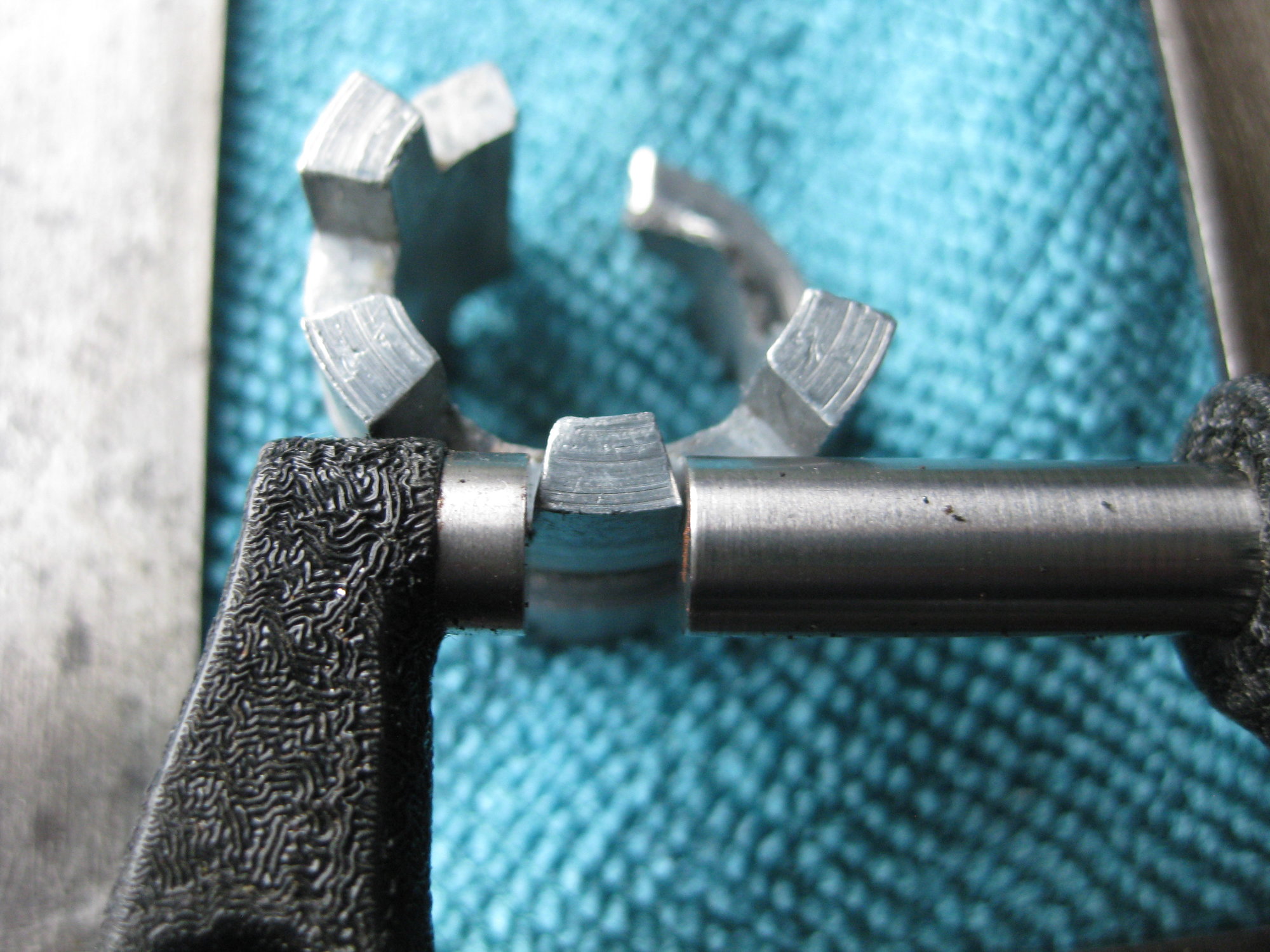

3rd & 4th
Mic'd the tooth at it's widest point , note top of tooth to root is not quite vertical .

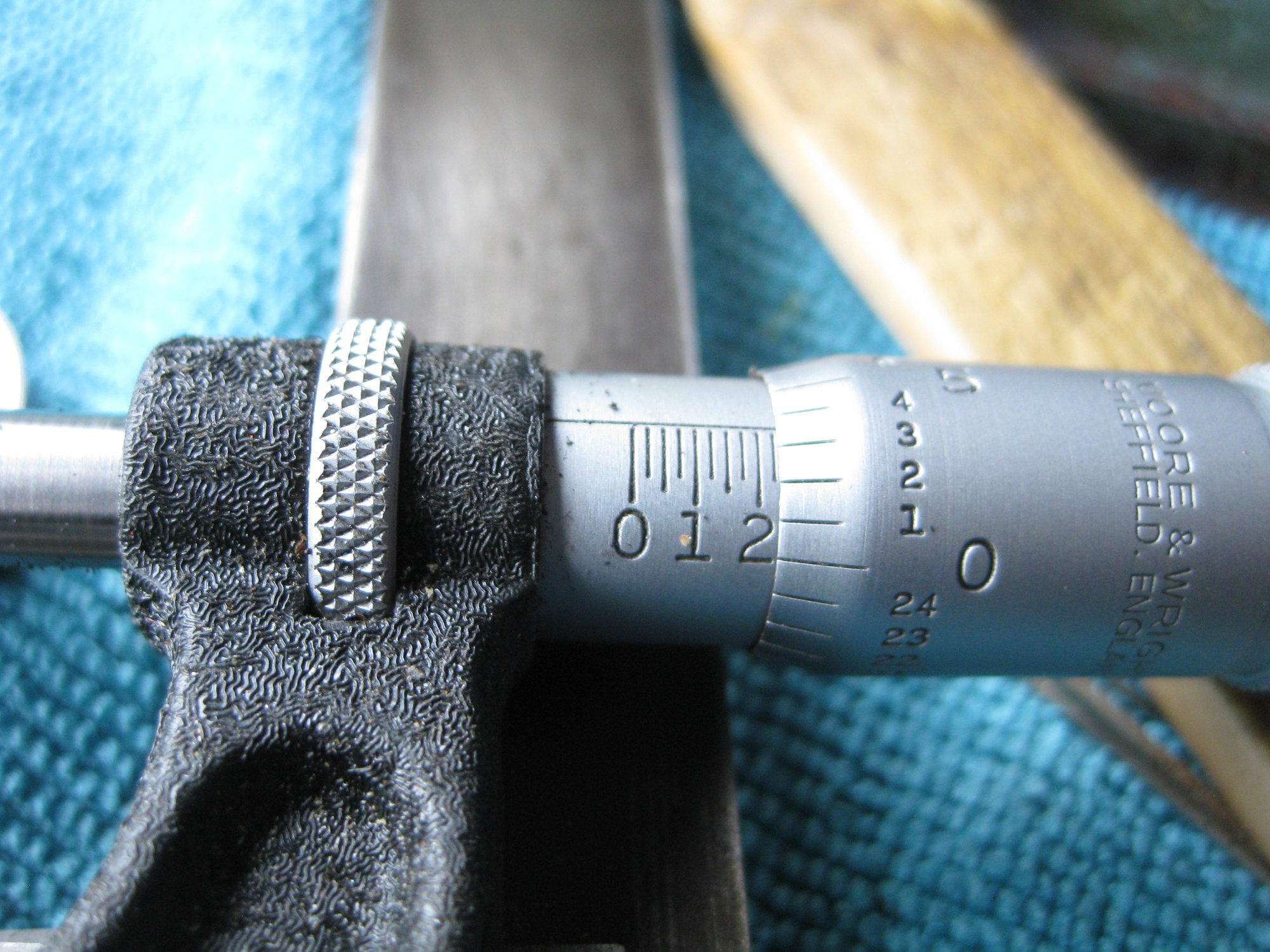

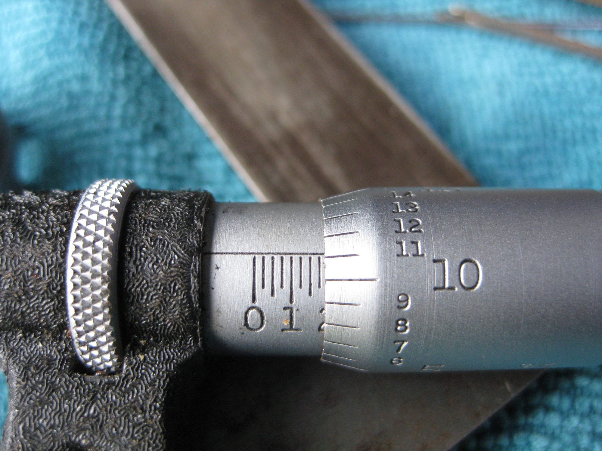

5th & 6 th
I can't quite get the narrowest width .. I thought the driving spline had sheared off clean at the base of the tooth , the measurement would be bout 10 thou less than indicated on photo 6 a micrometer reading of 0.186 "

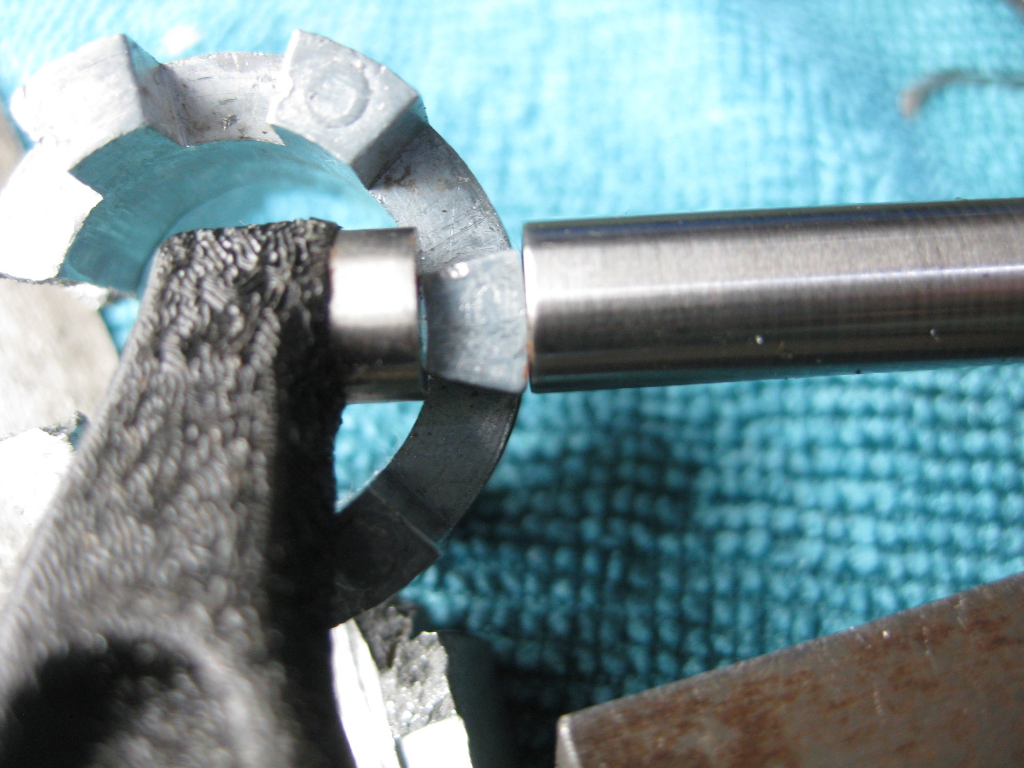

7th & 8th
Final reading for wall thickness best I can get with a simple frame micrometer .
