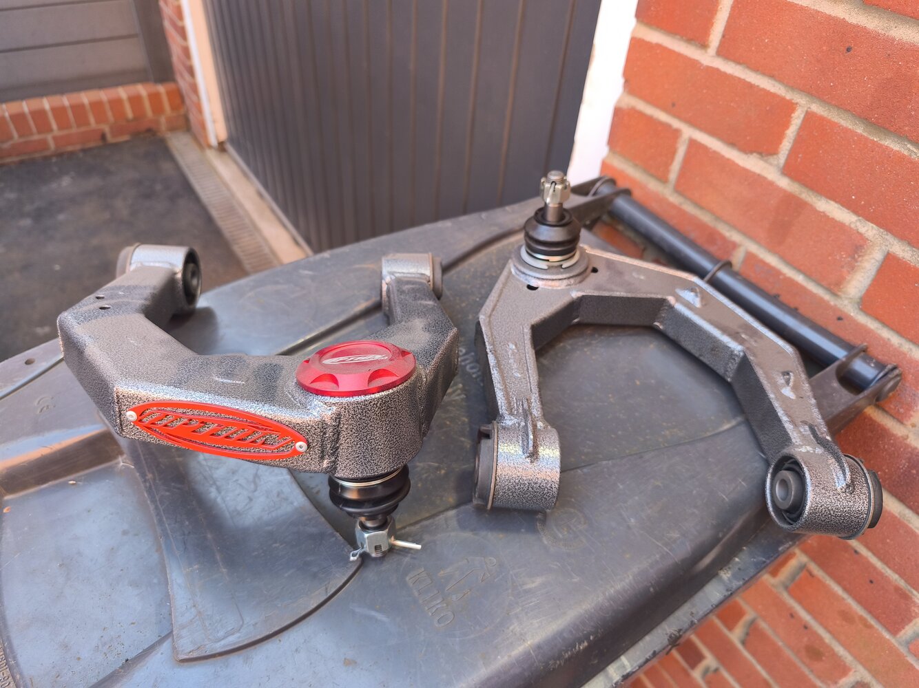

A few years ago, I installed a 2" spacer lift kit on my Ford Ranger. As many know, spacer kits increase the angle of the upper control arms, putting extra stress on the joints. While in Thailand, I picked up some aftermarket UCAs specifically designed for lifted suspensions, but never got around to installing them.
Fast forward to last week: my Ranger went in for its MOT and came back with advisories on both sides—worn upper suspension arm bushes. Perfect excuse to finally swap in those new UCAs.

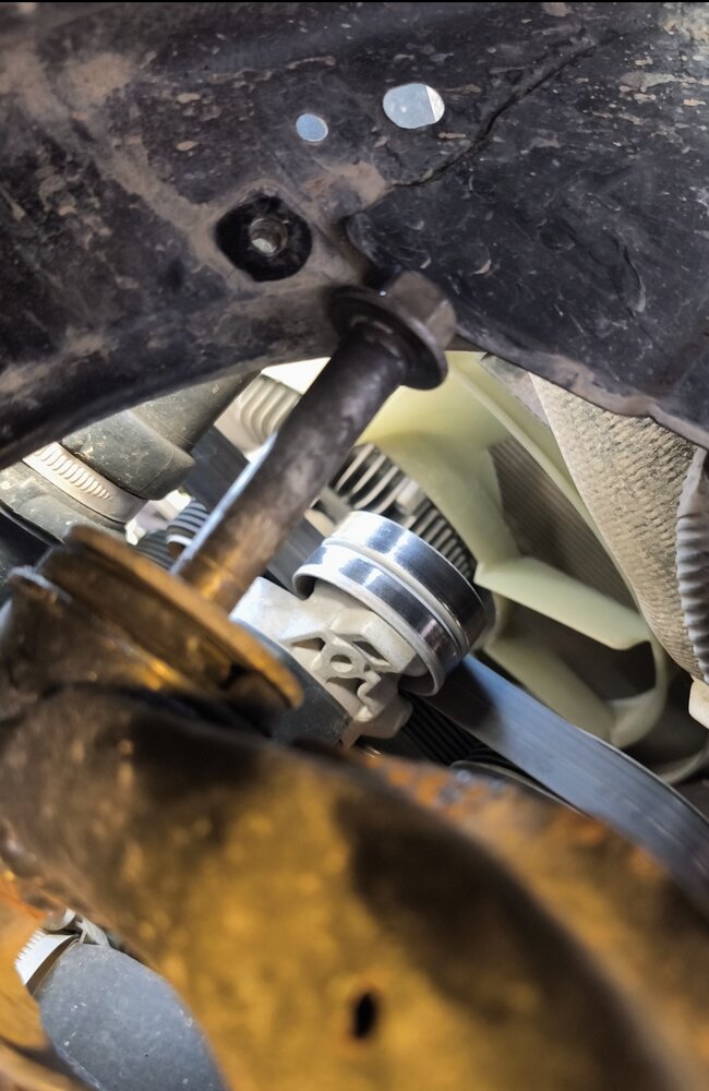

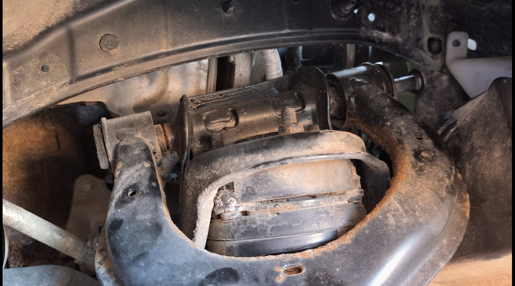

I got everything prepped, jacked the truck up, removed the wheels, and started loosening the upper control arm bolts.
Only to find I couldn't actually remove them. The bolt hits the bodywork and can't be fully withdrawn.
After watching a few YouTube videos, I realised these bolts are typically installed from the opposite direction—away from the body. If the bolt is installed from the opposite side the bolt can be withdrawn as it slides behind the body. So how did mine end up the wrong way around?
Here’s my theory: When I bought the Ranger new, the chassis rusted quickly (especially at the welds). I complained, and Ford agreed to strip and recoat the chassis. During reassembly, I suspect they installed the suspension while the body was off, mistakenly inserting the bolts from the wrong side.
Now, my options are:
- Lift the body (major job, not practical).
- Cut into the body (definitely not doing that).
- Cut the bolt in sections using a grinder, remove it piece by piece, and replace it.
