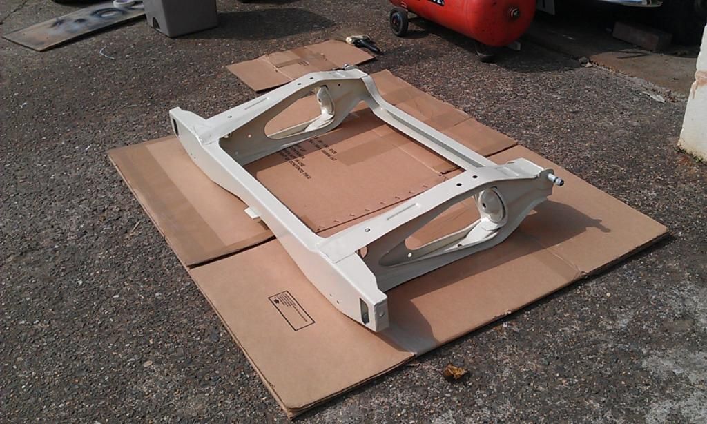

The Jotun is good stuff, I was happy enough with it, until I tried the Lechlar.
I'm not sure where you getting things like "brush hammered" from mate, I've never heard that before, I just lay on a light grabber coat and then normal coats 10 mins apart, 2 hrs later you can flat it, this is with Lechlar epoxy, Brushing the first coat on is gonna make any further coats as rough as a bears **** !!!
At the end of the day I don't know of any painter that uses this Jotun stuff which tells me something.
