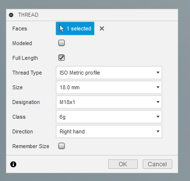

it does fit it its just a carp photo its just hard to hold the phone and hold both the unit and the thread cheakerIf you zoom in on pic, the gauge, does not fit into the thread correctly. I would say it , will be m18 x 1.5 . That is a common size used in hydraulics.
If you have a hydraulic hose shop , or an Agricultural Engineering place around you, they would have adapters from metric to bsp. Or a hose end insert, that you could just push your hose onto.
Search ebay for m18 hose barb , or. m18 to bsp adapter. That will let you see whats available.I

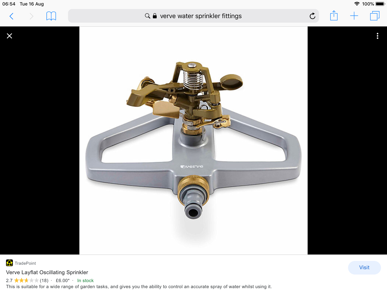

will do on these barbs but realy need to go to somewhere where they got a few to try as im not going to order 20 differant ones id might just buy a new watering unit as there only 18 quid
