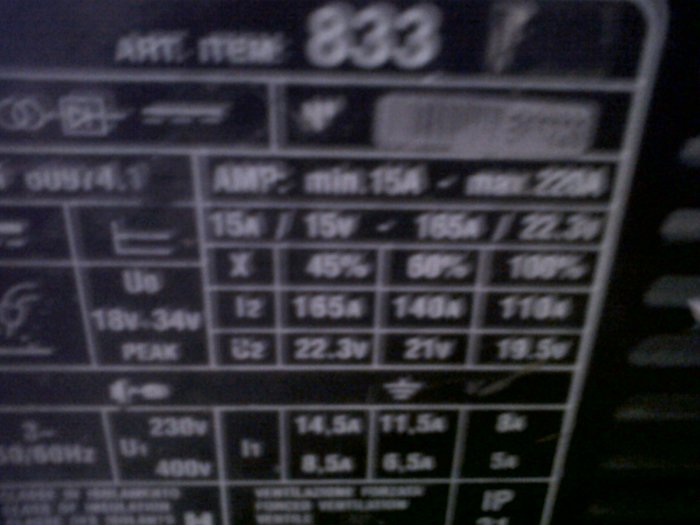

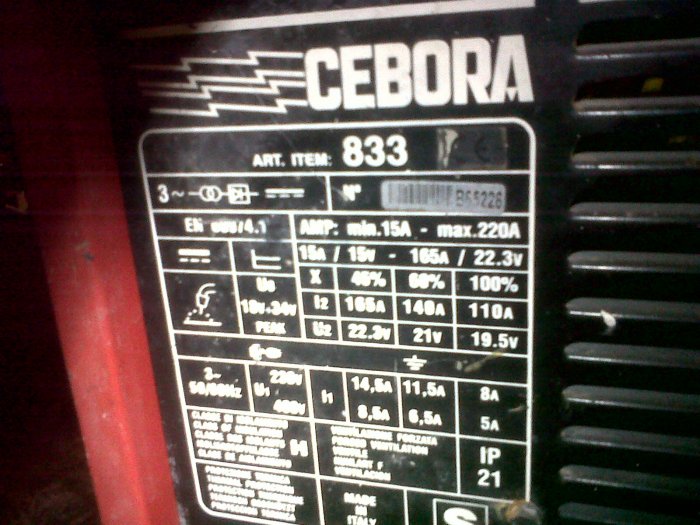

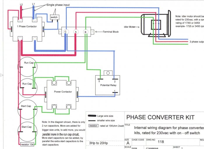

Not sure what make it is.but its the complete tig setup without the bottle.I was looking a b uilding a phase converter,but I can't find any parts in sa..how does the rotary converter work?do I need all the caps and that?or can I get the 3 phase out of the 3 phase motor only?
Get rid of it and buy a single phase machine. Simple as that.![]()

Has anyone got the owners manual for the 883. Thx Steveyou must be meaning another mig 883 is a pocket mig never 3 phase
not many 3 phase migs will wire up to 240volts AC
they use single phase of the three phase
some one will be along to tell you better but 883 is a small mig see pictures
