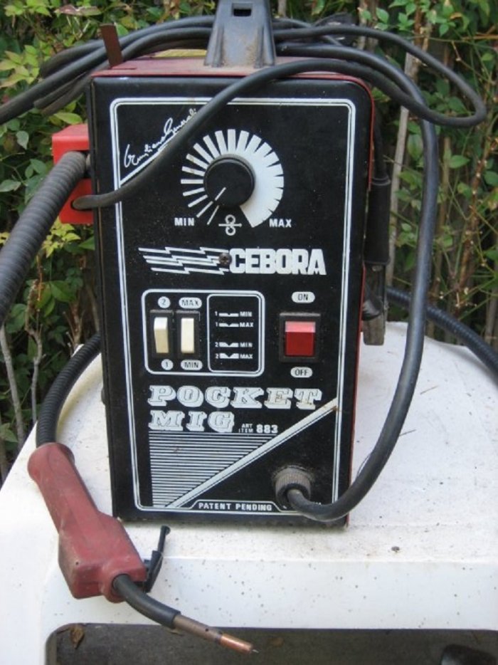

    you must be meaning another mig 883 is a pocket mig never 3 phase
    not many 3 phase migs will wire up to 240volts AC
    they use single phase of the three phase
    some one will be along to tell you better but 883 is a small mig see pictures

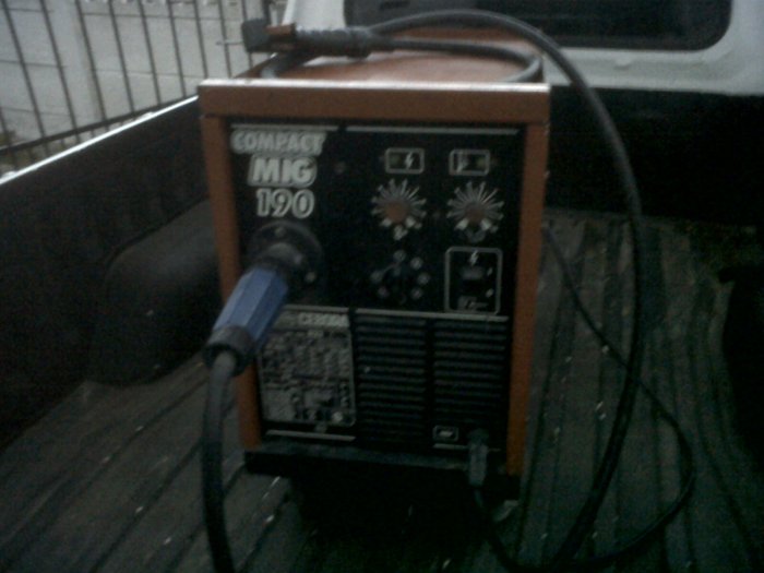

    Ok.thanks.ill put a picture of my one on?

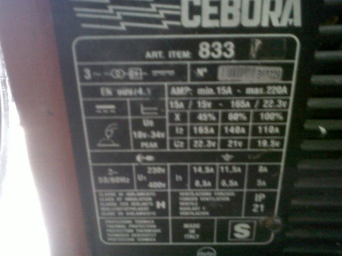

    have you got any better pics of the data plate on the front and has it one on the back any switches that say 240 380 415volts any thing like or not

    the short answer in No its only 3 phase.
    this is thee 833 the 834 was single phase.
    you would need to replace the transformer and contactor to make it 1 phase or and 834

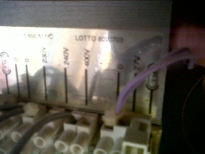

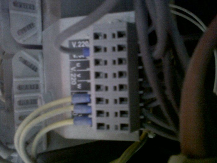

    Got a few pictures of the voltage box.for 220v it also takes 3 wires

    Ref your pics of the connectors. I think it's to allow that part of the machine ( the fan and circuit board) to be used for both the 240 and 400v but the main transformer ect does not seam to have any jumpers to switch.
