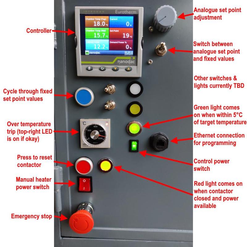

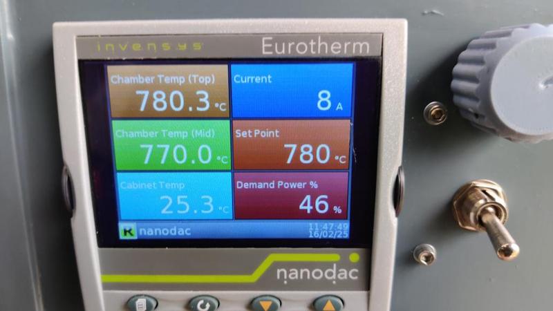

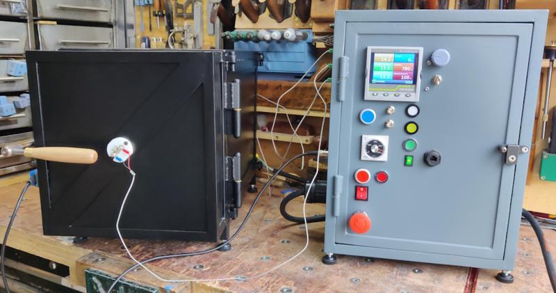

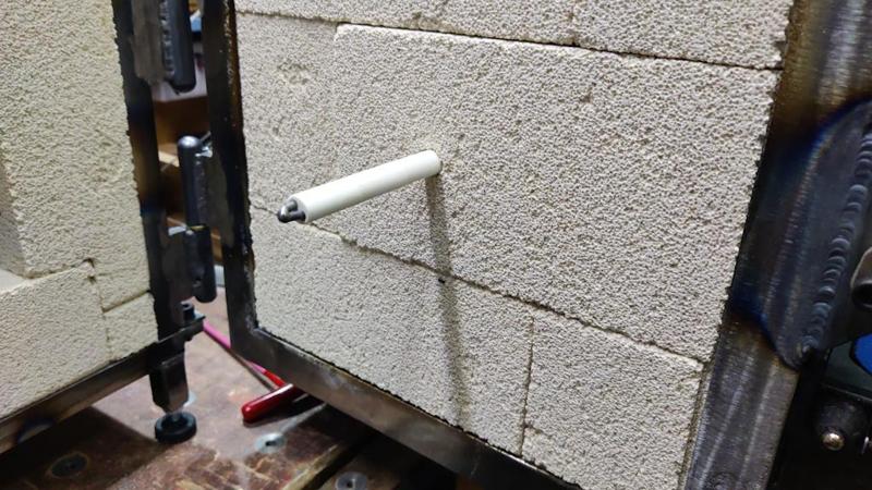

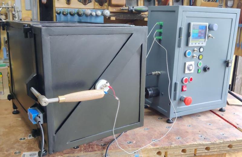

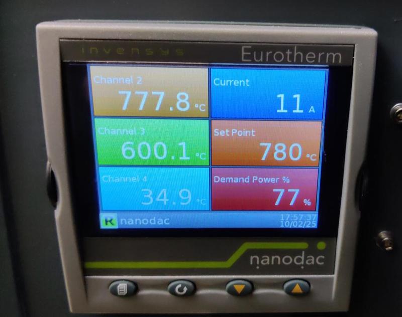

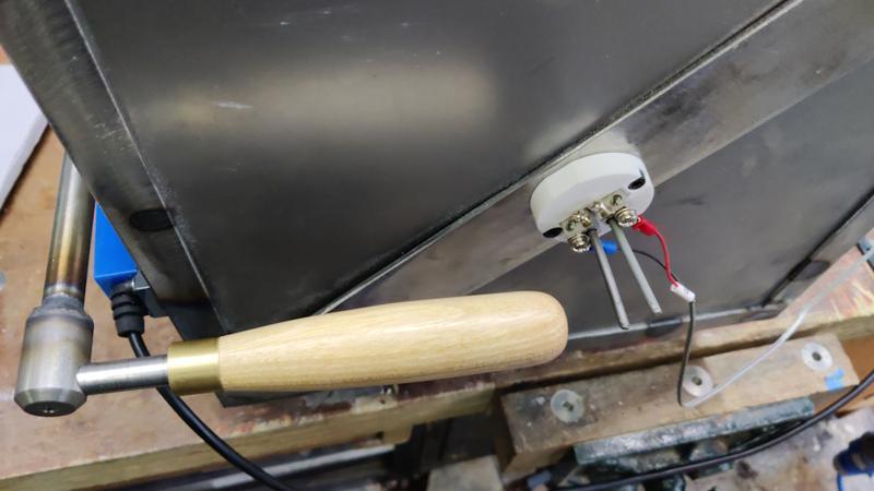

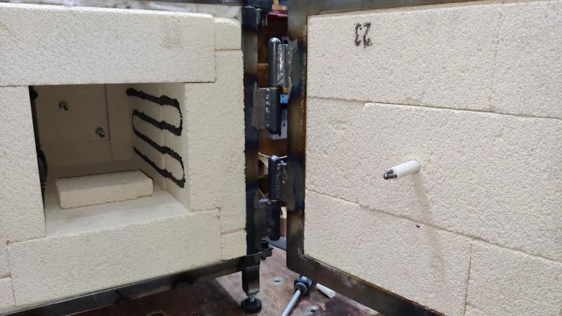

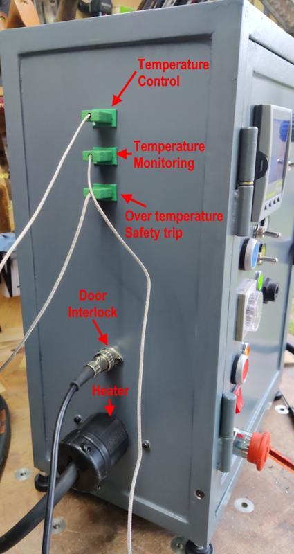

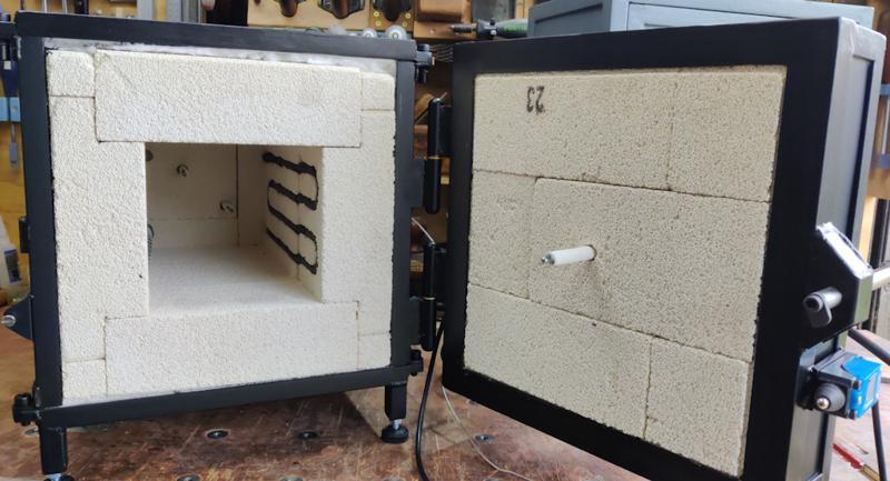

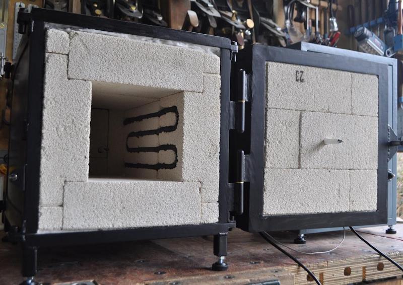

I would expect to see the TC junction at least -50mm from any surface in that sort of oven.
For decent temperature uniformity, you would probably need some sort of air circulation.
No, no vents.Does this have a top vent with a restrictor in it ?
) to be standing in the garage running multiple auto-tune cycles at the moment, so I think I'll leave it all until a warmer day anyway.
