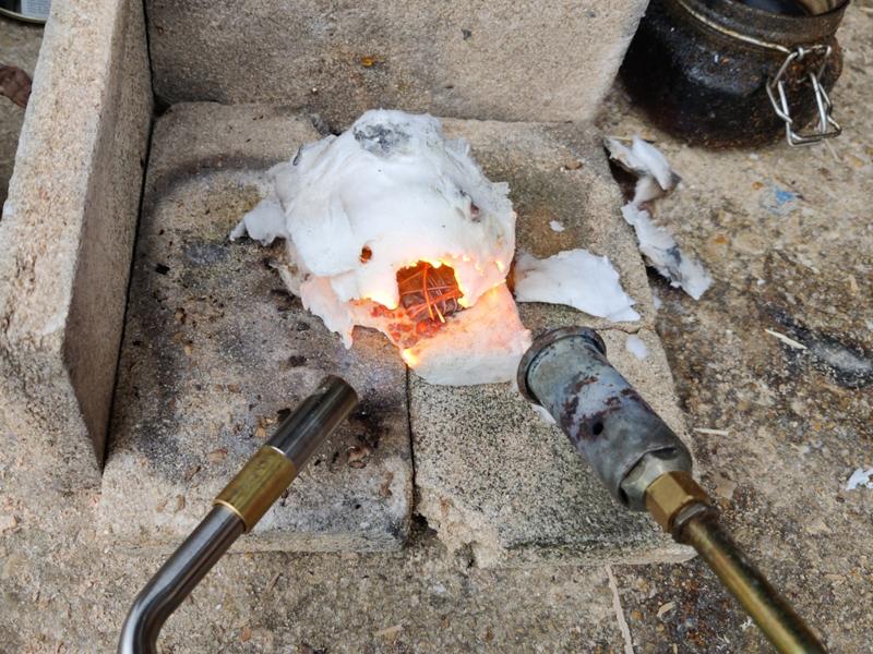

My usual approach to heat treatment is to do make a little tunnel from ceramic wool and use one or more blowtorches to heat the part. You can see an example of this in the following photo:
Judging the blade temperature is a combination of looking at the colour and testing it with a magnet. After testing, I usually stick it back in the flame for a bit to compensate for the temperature loss when testing it: it cools down quite quickly. All of that introduces quite a bit of variability.

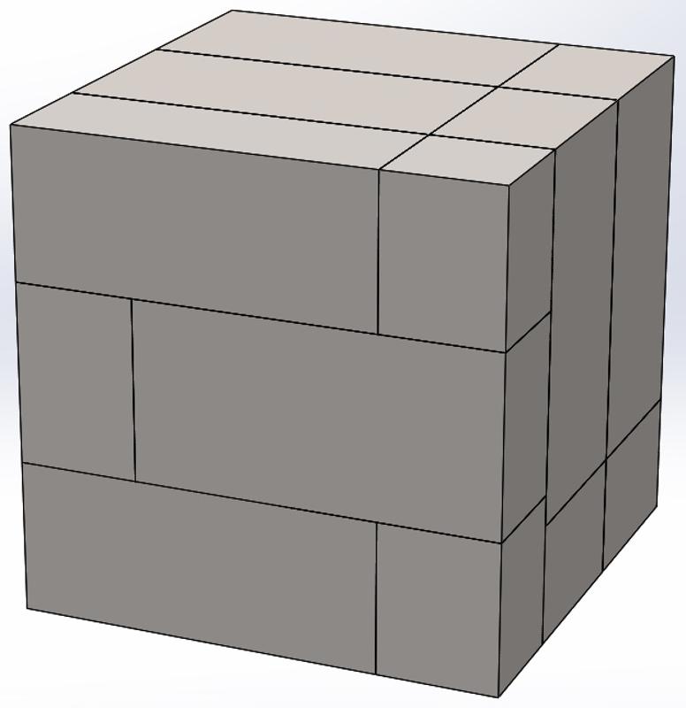

This CAD model image shows my current plan for the brick layout. The insulating fire bricks I'm expecting to use are 230 mm × 114 mm × 76 mm, and this layout gives 154 mm × 154 mm × 228 mm interior dimension. The door (not shown) will probably have a protrusion that goes into the opening a bit to improve the heat seal, hence the fact I'm expecting the internal volume to be slightly smaller.

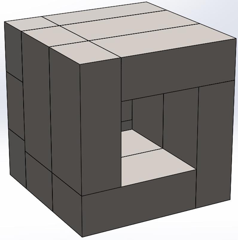

This CAD model image shows my current plan for the back face layout. The door will probably be laid out in much the same way. In theory, I can cut the three small bricks out of one full brick, but I'll buy extras in case it's necessary.
