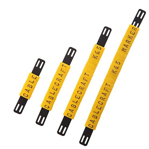

I have similar for larger stuffAnother option for bundles, big cables etc. is a tie on marker system I've found them useful where I have a load of multicores going through gland plates.

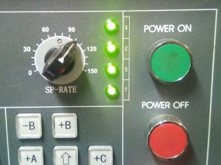

Yes, you get loads of different tapes for them, here you can see clear with white that I added to the side of the LEDs.Just googled them. They’re sub £100 at the moment.

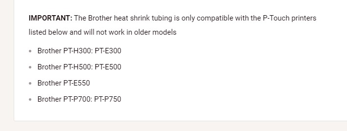

Do they do heatshrink labels for the
Brother P Touch TZ
Ah Ah so mine is no good. I just checked and its a PT 1000.
Ah Ah so mine is no good. I just checked and its a PT 1000.![]()
Oooerrrr that's worth trying I guess. Is that on Amazon?The aftermarket seem to supply heat shrink for the pt1000.

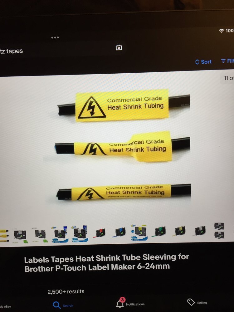

I misread your post and thought it said they DO do heatshrink tapes for the P touch TZ. So I went on Ebay to look.Do they do heatshrink labels for the
Brother P Touch TZ
