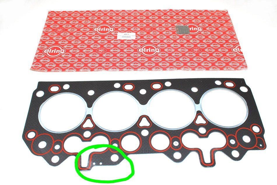

I think ive got to do a head gasket. Bubbles in the coolant. I cant see where else they would be coming from.
Anyway, the gaskets come in different thicknesses to adjust for tolerances.
The procedure for selecting the thickness always seems to involve measuring piston protrusion....
...but thats not going to change at all.
Noone (from my casual looking) seems to mention measuring the distance from the head face to the bottom of the valves.
Depending on how the head is skimmed (if its just the face, or if the valves are reground to match) it is surely this distance that is the one i need to be paying attention to?
Ive got a head in the garage, wrapped in oily cling, that i got re-faced and tested years ago, so it wont be the same head going back on.
Im guessing i need to take off the old head, measure that one, measure my replacement, and then adjust the gasket to suite (using the old gasket thickness as a starting point)?
And pay zero attention to the piston protrusion that everyone is telling me i need to measure?
