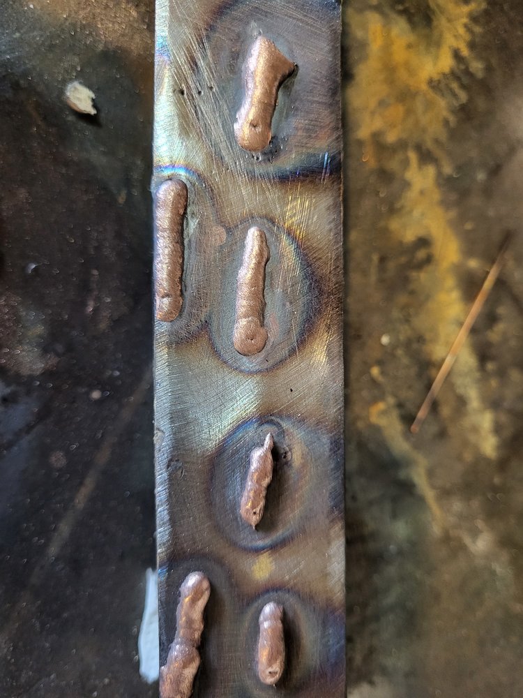

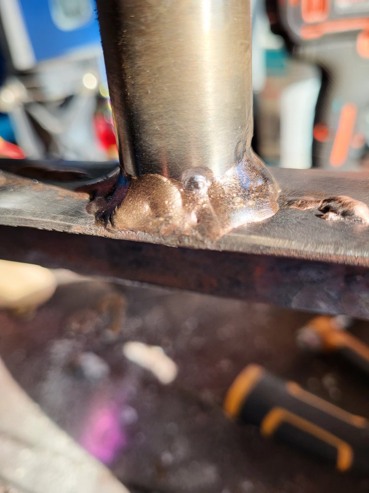

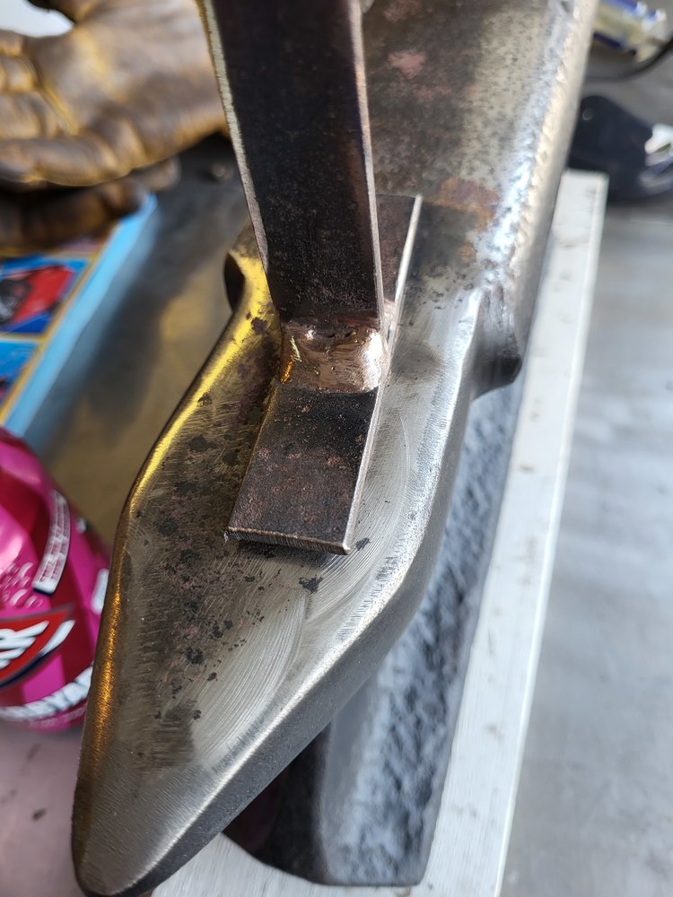

They grey stuff on the weld just brushes off. It doesn't look that much different to when I had a go. I don't think I had the black soot at the periphery. What does it look like cleaned up?
Quick attempt at Tig Brazing.
Thought I'd have a go with some bits of scrap. Brazing wire isn't cheap and my pet peeve is that the small volume sellers cuts the wires down to 300mm, I think to convince people that they are getting more. I'd rather buy fewer, longer rods. Anyway a few pics. It is a nice process. 60amps dc...
