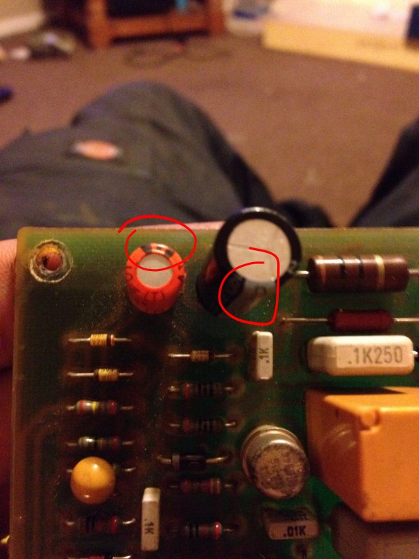

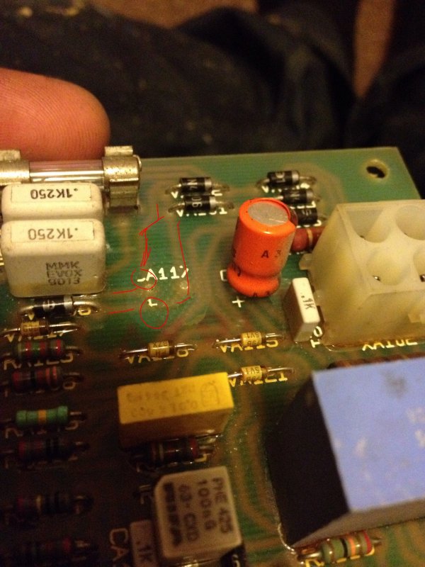

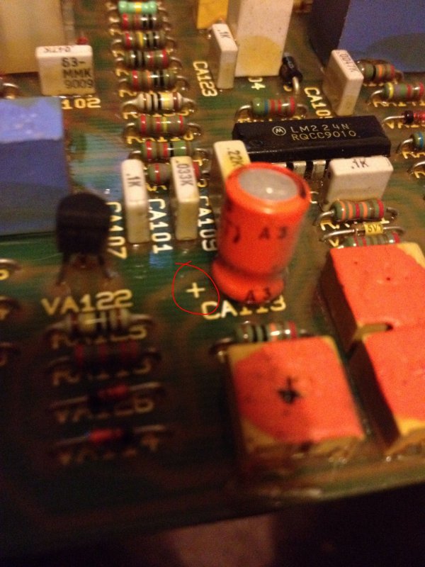

I reckon that should be CA117.yeah first one is right , if all the other caps have that + then you can assume that one will also, do they also have a - sign looks like one at the end of tha A11
you are right, its a bad print on the board :dI reckon that should be CA117.
just use the + sign forget the rest, wendel has cracked the enigma codeI reckon that should be CA117.

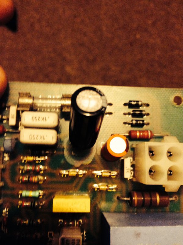

You want the cap orientated the same way as the existing orange cap with the neg on the right and the pos on the left looking at your last photo.So there looks like a + and a - on seperate lines so does the + go on the line it's on or does the + go on the side of the symbol??
So it's heat relaQuick update boards on fired up but one thing I never mentioned before just before the capacitor went the welder stopped working anything above 20 amps but if I fire it up the next day it's will weld fine for about 5 mins then stop working again I am still having the same symptoms any ideas thanks
how long before it cuts out, check the thermal cut out, do any light illuminate of the front when this happens ?Quick update boards on fired up but one thing I never mentioned before just before the capacitor went the welder stopped working anything above 20 amps but if I fire it up the next day it's will weld fine for about 5 mins then stop working again I am still having the same symptoms any ideas thanks
