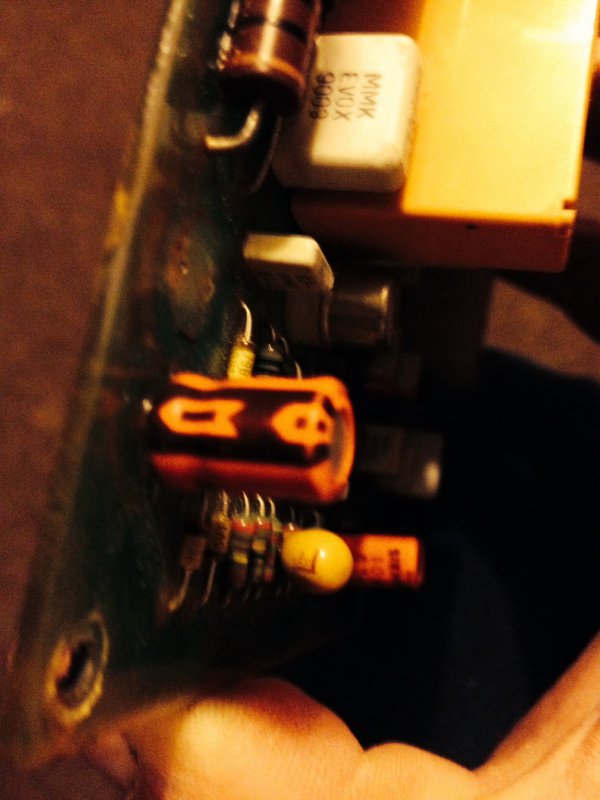

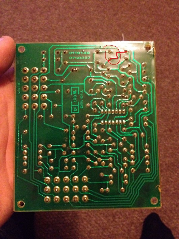

could be a case of power up and test polarity of connectionsI had a look but not a sausage....

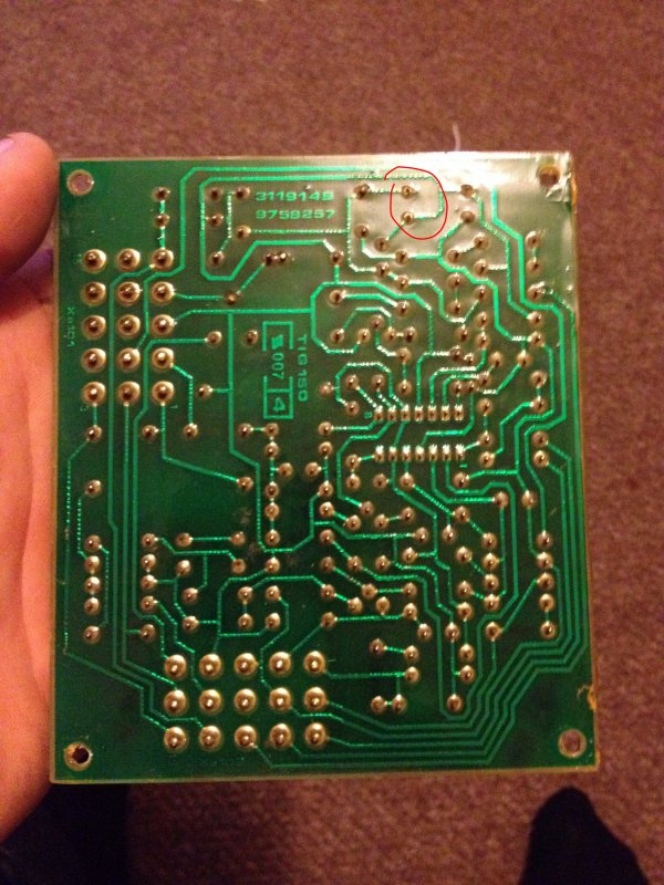

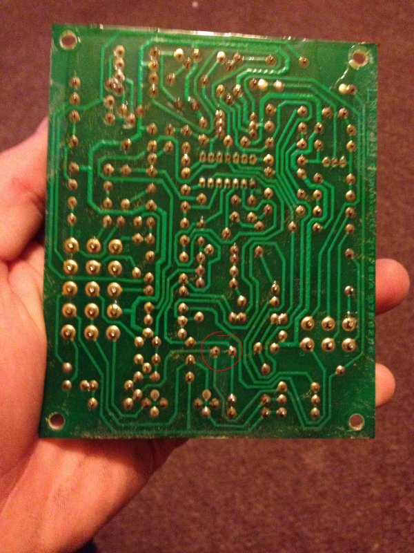

post a picture of the rear of the boardI'm also a novice on testing polarities as we'll sorry lol iv just had a look at the back off the board but no idea
Yep.So I take it these negative lines mean that the strand comin out of it is negative I know it sounds completely stupid but I just wanna be sure thanks
just make sure you set the meter to DC and make sure the voltage range at least equals the voltage on the capacitorAnd yea I have a multi meter will give it ago tommoro night so if u don't gear from me by Friday iv turned into a ball of ash lol

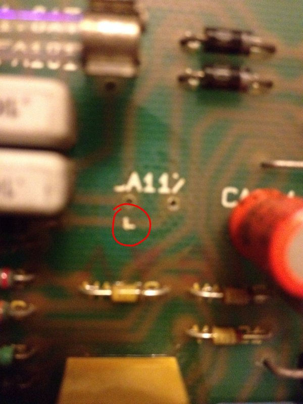

it could only be a misprint as there would be nothing to wear it, you could remove another cap from the same board (noting which way round it goesOn the board iv seen afew positive symbols on other caps on opposite side to negative now does this look like a worn posative sign
) and look for markings the same
