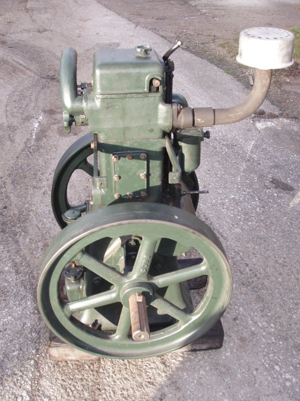

thats the one i put up seems to be lots on fleybayI wouldn't mind a Lister genny
