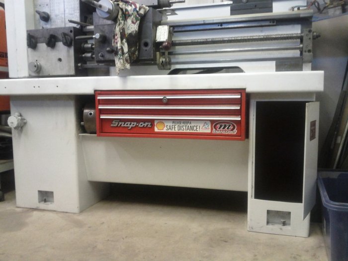

just bypass all the wiring and run a direct supply to the motor from the converter . take readings of voltage and current with clamp meter of each phase then its either the converter or the motor . it would be easier to take the motor in and have it checked after u have tried the direct wiring aproach if u are having no results
