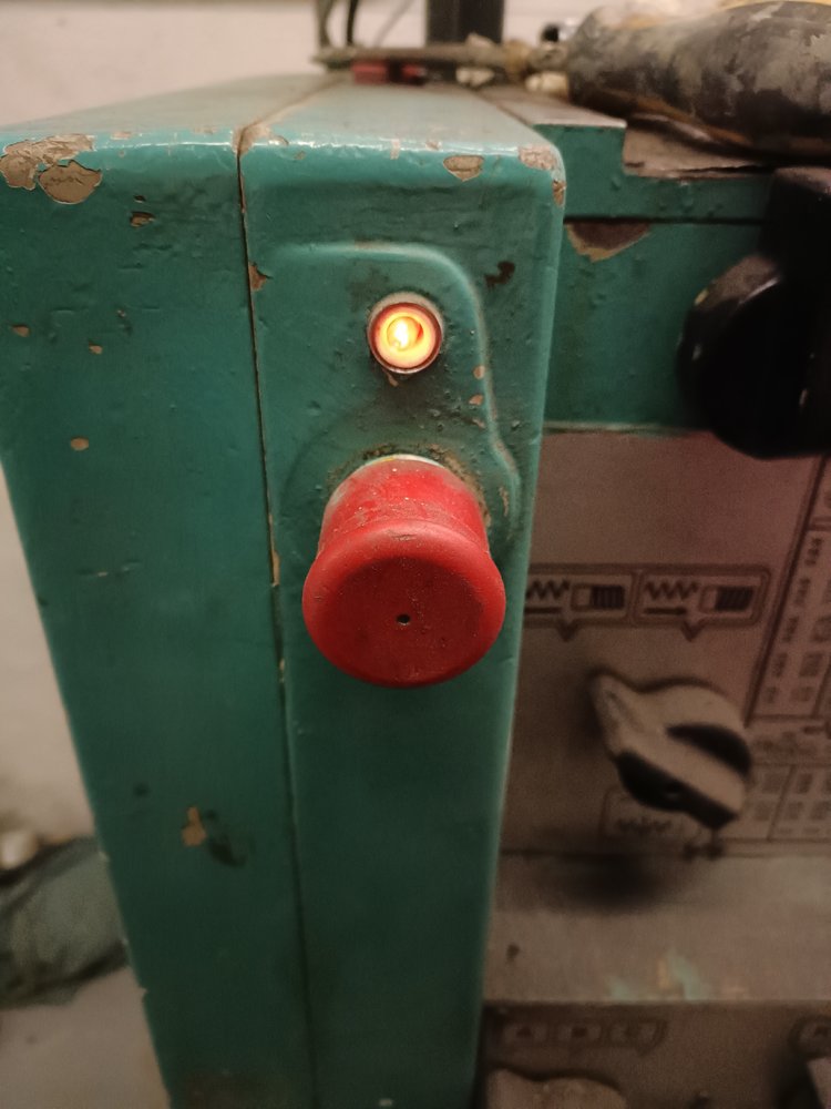

Don’t need to take it apart, the isolator contacts are easy to access.Id not start taking things to bits until you've established where the fault is. Its unlikley all three phases would be faulty. If its was working and just stopped, your looking for something that stops everything.
