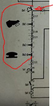

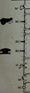

Thanks guys. Electrics aren't my thing. Will a continuity test be what is needed at the switches?
A continuity test will tell you if they are working or not. I rebuilt the control circuits for a M300 so know the electonics inside out.
The limit switches are all the normally closed type so if you get open circuit they may be faulty or need a clean up of the plungers. The limit switch for the foot brake is round the back just above the suds tank so likely to be bunged up and sticking. Mine was.

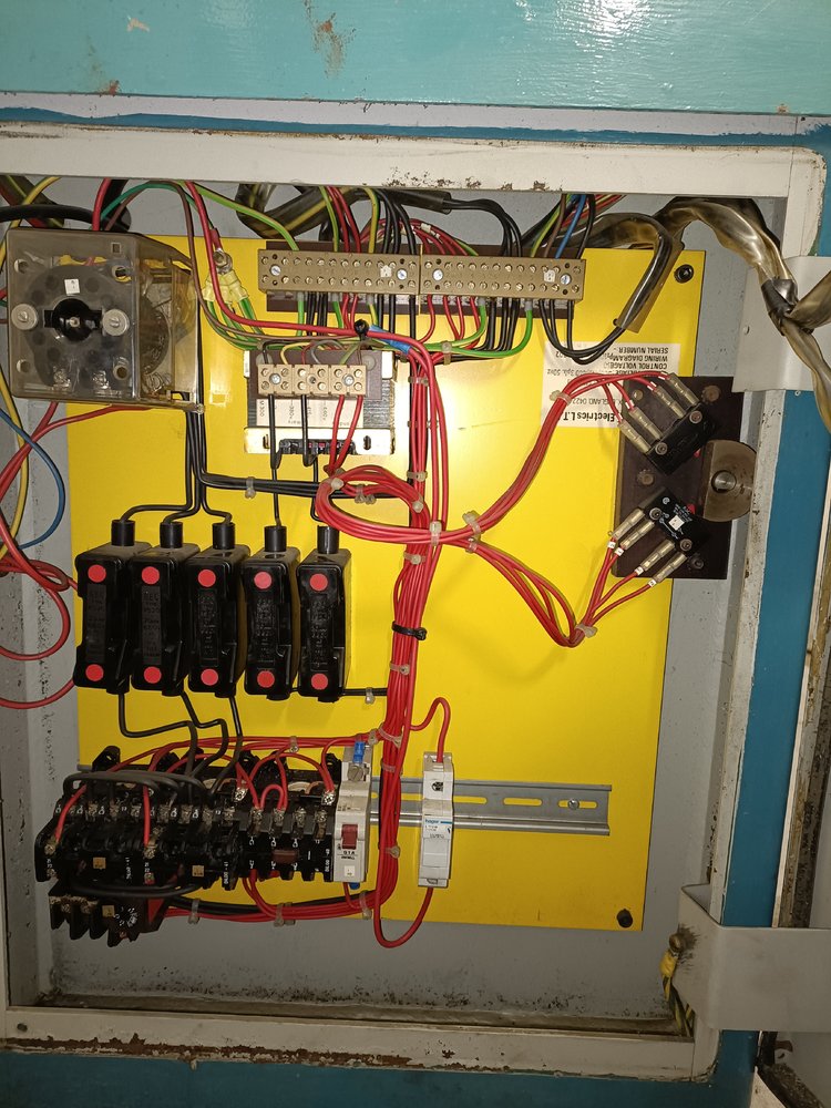

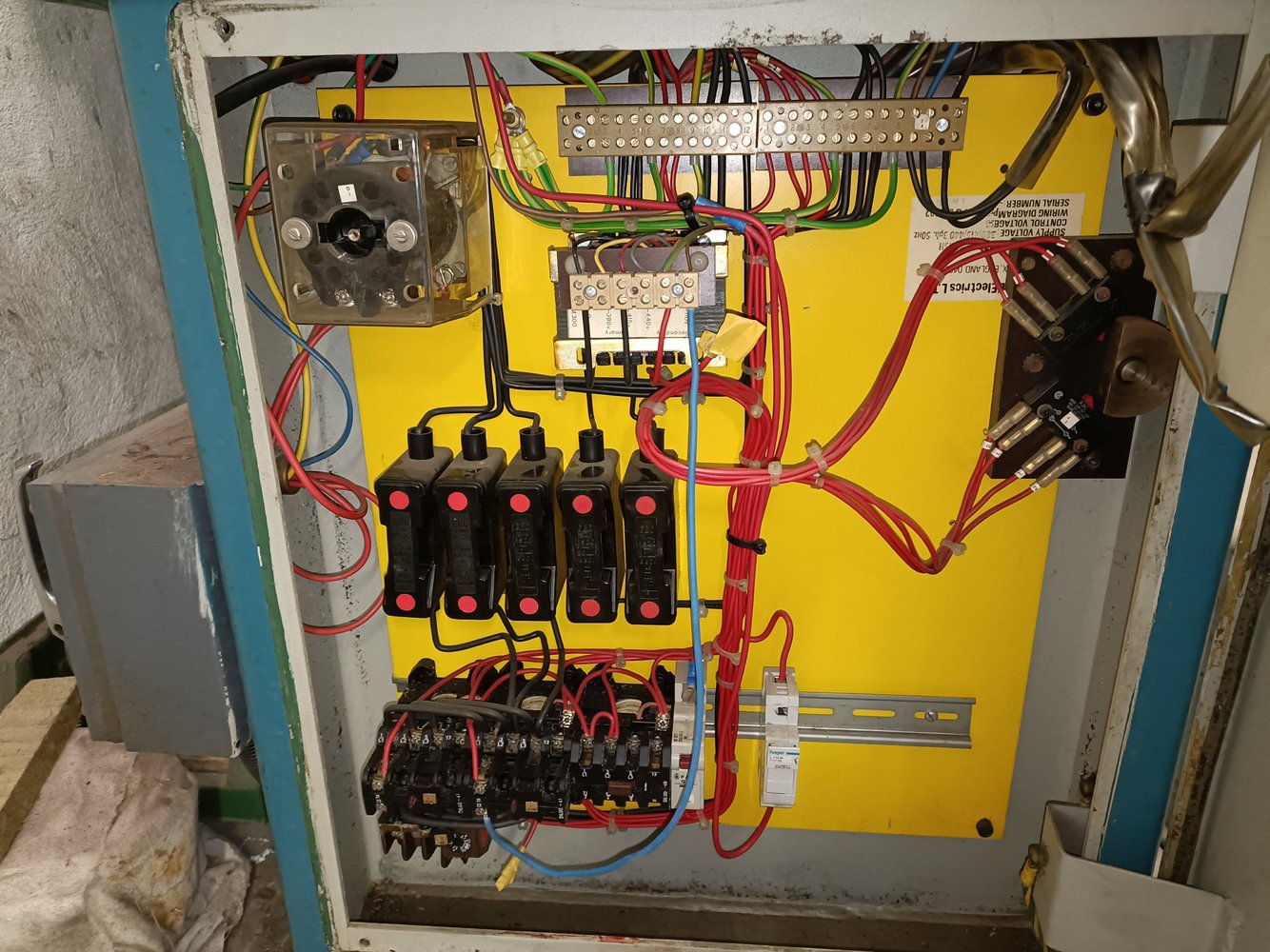

Have you got a photo of inside of the control cabinet. It could be a number of things that are at fault tbh.
