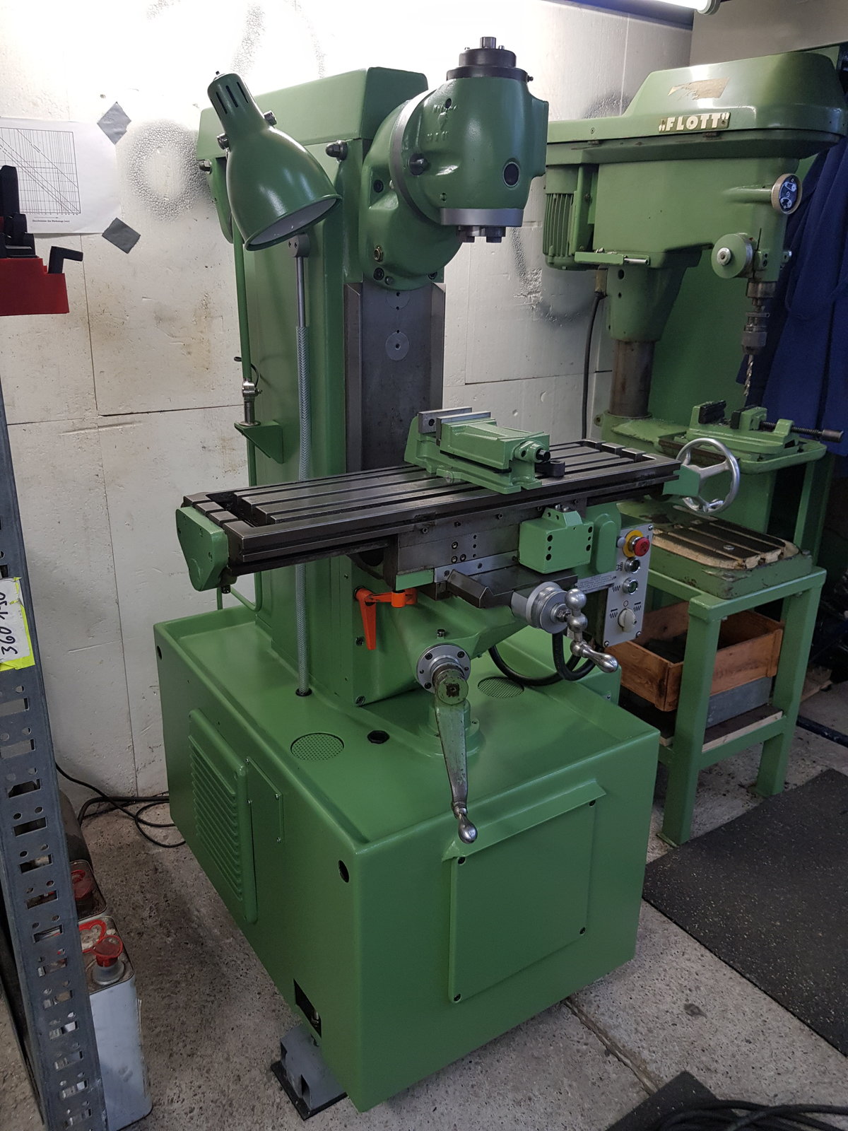

Fantastic job, I just hope mine looks as good. I will try to get back to you on the oil question.
...But I can't see the level on the vertical head because of the dirty glasses.
I only hope mine looks that good when I finish it.
Really nice. My one doesn't have the clutch either. It was an option. The Harrison mills used L5 lathe mechanical parts and I'm told it is possible to retrofit a clutch from a Harrison L5 lathe to these machines. I do not know how true or otherwise that is.
Does anyone have a manual and partlist / drawings for it?
Anyone has experience with fitting a new motor on the table feed with a frequency drive?
Im hoping to wire it up to the current controls and limit switch. Should be possible as they are simple contacts I guessA good place to start might be to look at the Align power feeds commonly used on Bridgeports. I had a quick look and they seem to be infinitely variable from 0 to 160 rpm. That would tell you the gearing you need from a motor that does 1400rpm at 50Hz.
I think the Align ones are DC motors but that does not matter. They have a dial to set the feed speed and a switch for rapid travel (plus direction and E-stop).
You would have to think a bit about how you would control a VFD in the same way. Let us say that 0 to 50 hz represents the overall speed range you need. I think you would have to have a resistor in series with the potentiometer so that the dial would go from 0 to maybe 25 Hz or whatever the maximum realistic _feed_ rate would be. Then have a momentary switch in parallel that shorts the pot and resistor to give 50Hz for rapid travel.
You do not want to be able accidently to command full rapid with the dial. You will also need limit switches that work properly when you rapid into them. Having the limit switches or trip dogs repositionable* is also an advantage so you can go 10mm off the edge of what you are cutting and auto-stop the feed rather than letting the cutter drive into your coffee cup that you left on the end of the table.
* and also a fail safe at the extremes of travel so if the trip dog slips, it can only slip so far.
Definitely retro fit a Bridgeport one.A good place to start might be to look at the Align power feeds commonly used on Bridgeports. I had a quick look and they seem to be infinitely variable from 0 to 160 rpm. That would tell you the gearing you need from a motor that does 1400rpm at 50Hz.
You do not want to be able accidently to command full rapid with the dial. You will also need limit switches that work properly when you rapid into them. Having the limit switches or trip dogs repositionable* is also an advantage so you can go 10mm off the edge of what you are cutting and auto-stop the feed rather than letting the cutter drivdwfie into your coffee cup that you left on the end of the table.
