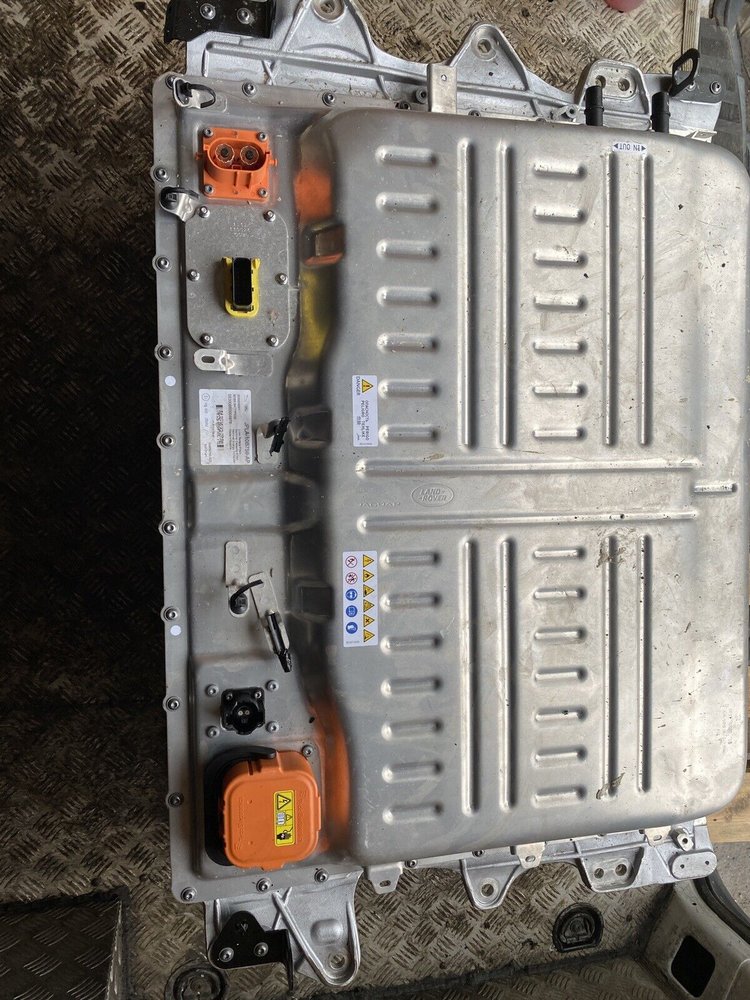

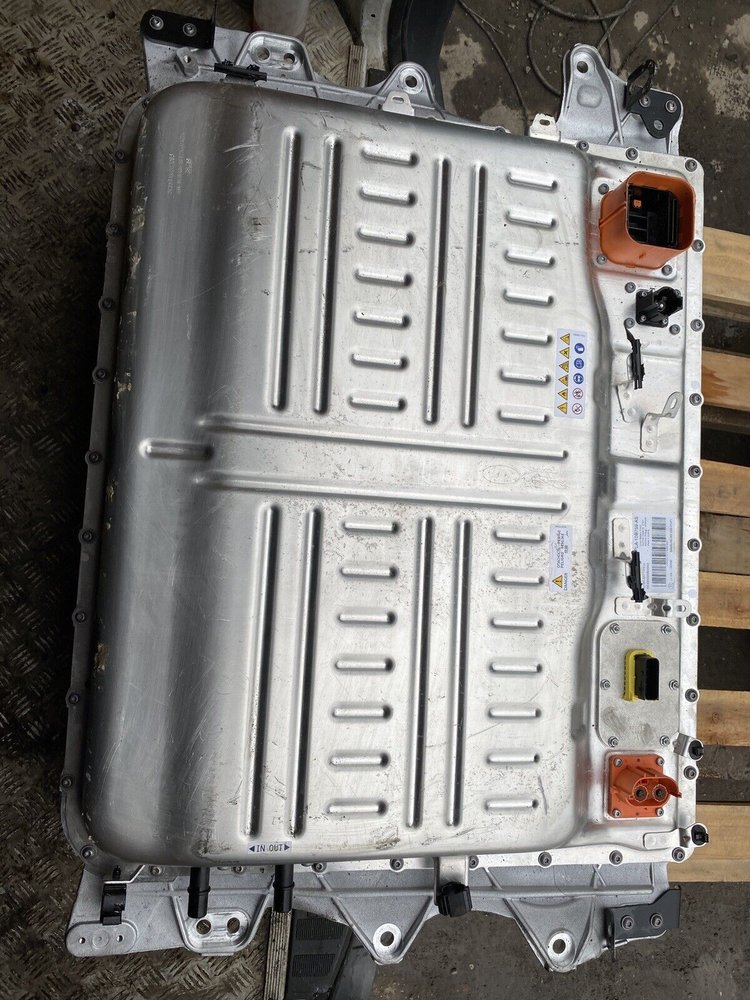

Range Rover? Do you reckon they'll work? Should have got some Toyota onesCourtesy of a Lithuanian Santa Claus, who arrived on a Mercedes Sprinter sledge, bearing these two gifts:
View attachment 378027View attachment 378028
Range Rover Sport P400E Hybrid batteries, which will provide 216 Samsung 37Ah cells to replace the failing NiCads in my 2001 Citroen Berlingo 500E "Electrique" electric van.

These batteries contain "NCM" cells with Nickel Cobalt Manganese cathodes, in place of LiFePO4. They are very energy-dense and produce 3.7v rather than 3.2v. The donor vehicles had only done 10 or 20 thousand miles.Range Rover? Do you reckon they'll work? Should have got some Toyota ones![]()

At 399.6v per pack, it's going to be quite scary to open them up. The Berlingo runs it's DC motor at 162 volts.
