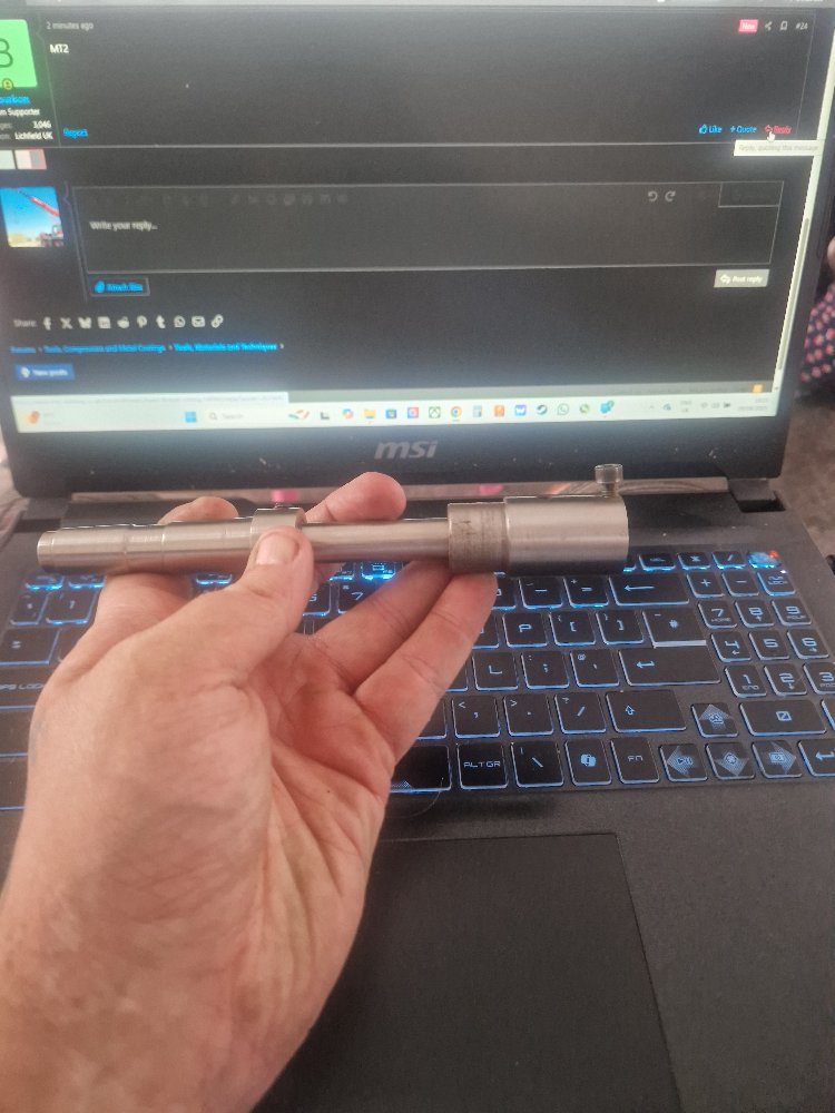

I do this all the time.Or you can use the end of a drill chuck (in the tailstock) with the jaws wound back so the die stock bears on the face of it.
what taper does your tail stock take?I was thinking of a tailstock die holder..... Then I saw the price of them!

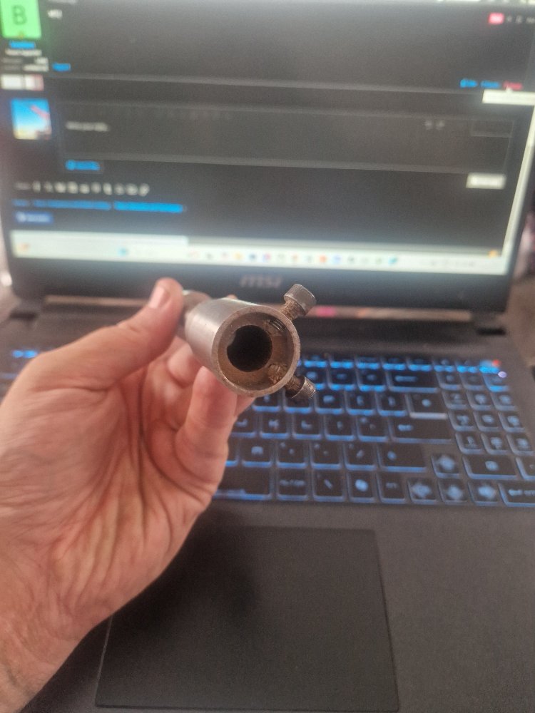

MT2 I've just had a youtube look and @Morrisman has got it sussed. I haven't opened the split up a bit and I'm trying to take off too much metal. I'm having my tea now and I'm working tomorrow So I'll crack it on Monday. If all else fails I'll get a decent die from UK drills.

Just make one...I was thinking of a tailstock die holder..... Then I saw the price of them!
