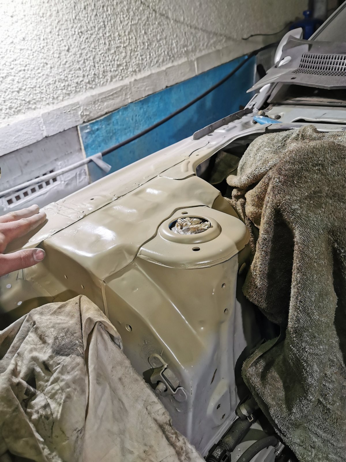

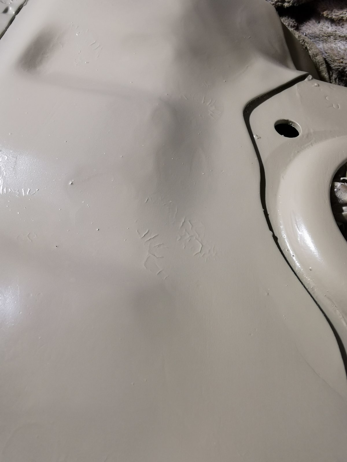

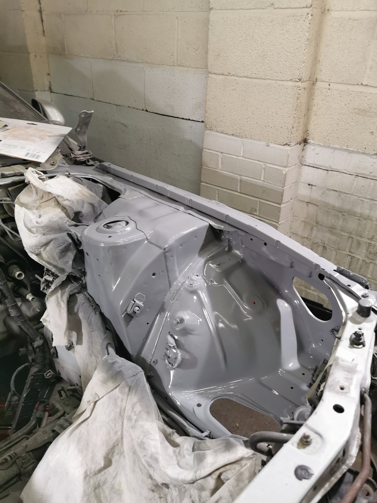

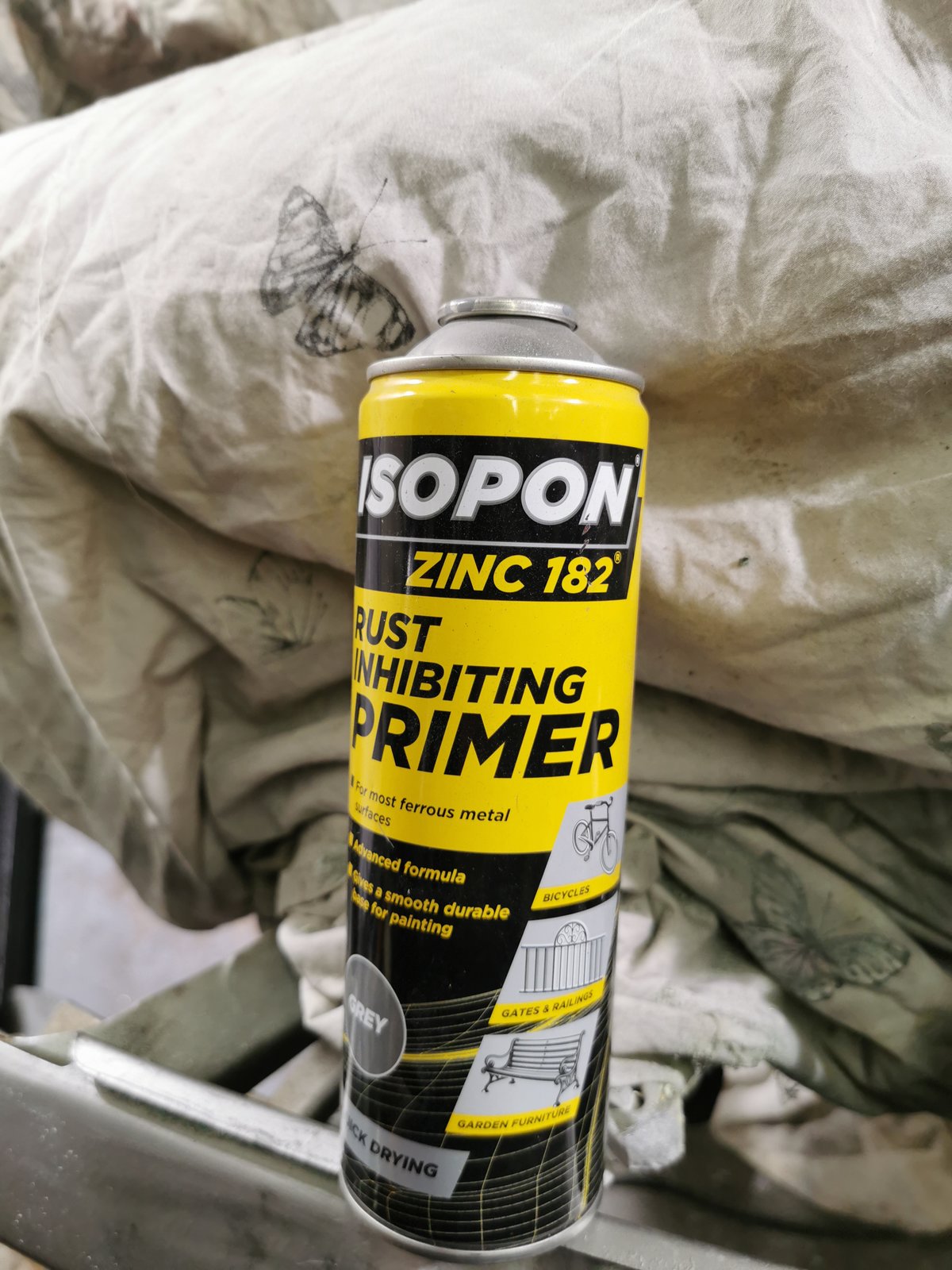

It’s not the best of stuff even in best conditions. Too much solvent in order to get a thick coat.
You need a warm garage and a warm panel for it to cure properly
Not as we are using cans.The biggest problem is temperature when painting this time of year! Even a different brand would probably struggle to cure also
Some bodyshops add accelerators to the paint to help speed up the job
The halfords stuff is way thicker than Spraywell high build. But the Spraywell is easier to put on in thin coats.
