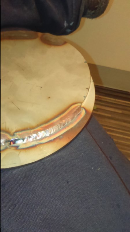

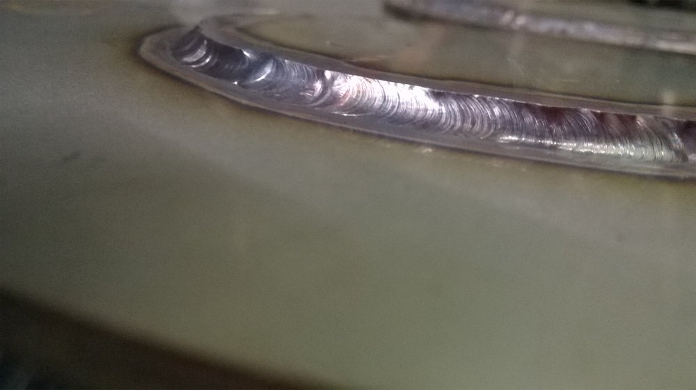

Cheers there is a tee joint I did but no phone back to the old smashed up phone where I can't see the to part of stuff

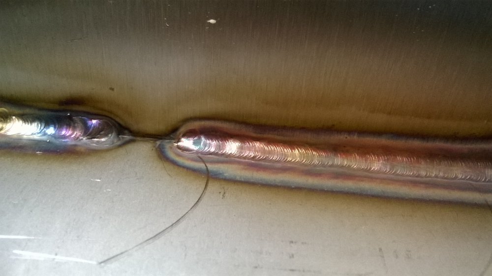

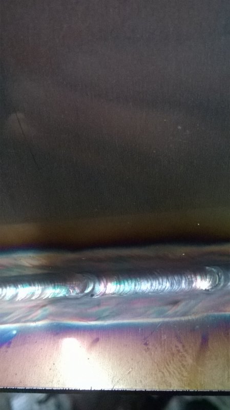

I've had a few members over for half a days tig tuition which I am happy to offer at the same rates but your quite a distance it wouldn't be practical to travel from Bristol to here. Tbh your doing ok and the runs look nice. I've noticed you stack up very close together, nothing wrong with that at all its your own developed technique. You might find it clicks even easier if you take more positive but less frequent dabs rather than going like a fiddlers elbo.Cheers Richard wish some one could teach me some little techniques I been using this forum and youtube its dont get me wrong a great asset to have but its not the same as some one over ur shoulder teaching a couple more hear I tryed a bigger filler wire to build up a more subs penney effect and just dabbed like crazy

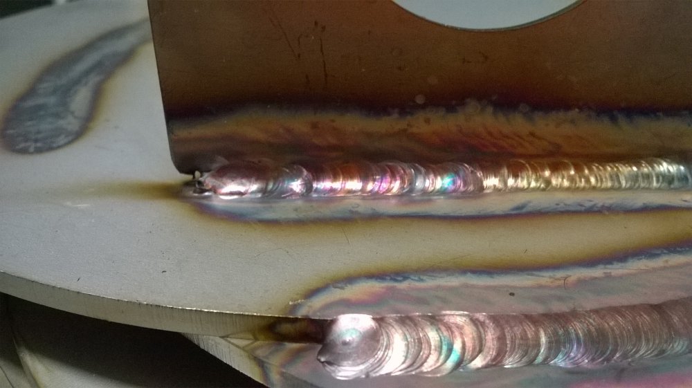

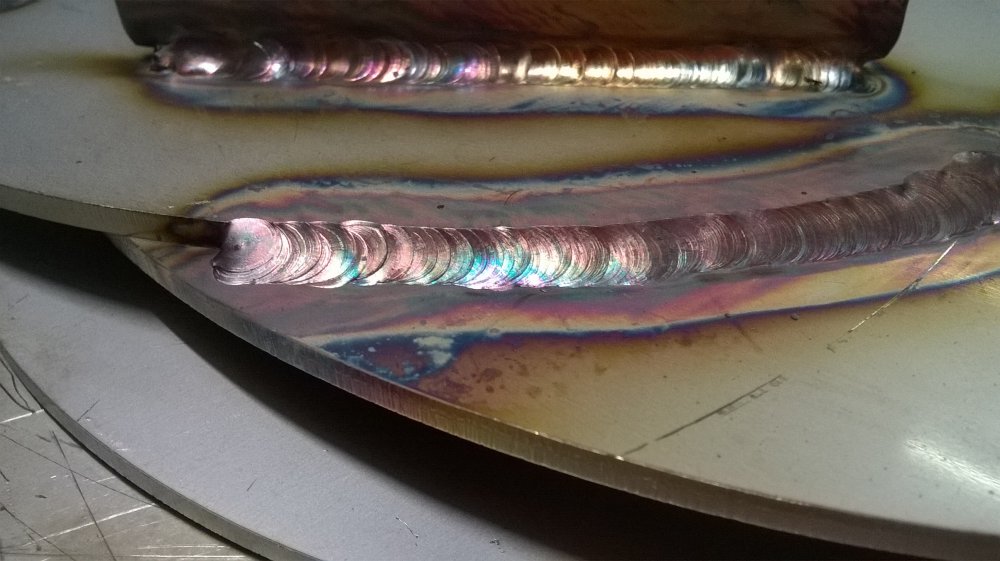

I've robbed your photo so you can see what I mean. There is nothing at all wrong with your intervals but there is no harm in taking your time and adding fill when it's needed rather than 3 times a second. Below is a fillet and lap where I have added fill less frequent but in a positive manner to prevent cutting away of the top edges.
