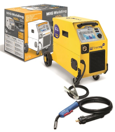

Hi all,
I bought the above faulty mig from ebay. I know, I should know better!
Anyway, upon dismantling it I found several blown 1A fuses floating around inside. The fuse holder on the control pcb is empty and the small transformer has an o/c primary winding. While I'm waiting for a replacement transformer to arrive, I was wondering whether anyone is able to confirm that 1A is the correct fuse rating, I assume it's a slo-blow? I expected it to be printed on the pcb, but it isn't!
Also I've found a wiring diagram for the welder, but if anyone has a circuit diagram for the pcb that would be really helpful too!
Many thanks,
Steve
