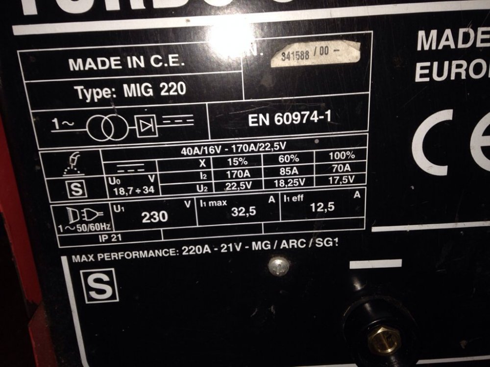

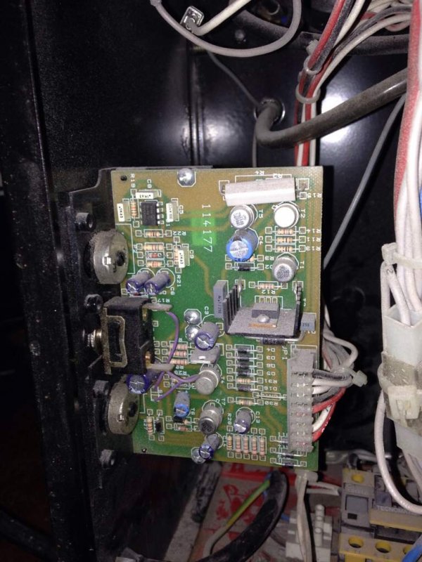

Looks like my old 1989 Einhell inside as do the controls and front panel printing so I'm thinking made in Italy by Telwin. What does the serial number say, does it give a date code?
A Clarke sticker might make the spares cheaper than Sealey!
I went and looked the only numbers I could see were these in the top right hand corner of this photo
been pretty much good to go since. I've never Sean inside a sealy but that looks fairly well built. Not so sure about lack of air flow on rectifier bridge (Ali plates above fan) but I don't think that will be much of a problem
It's a perfectly fine welder, but the fan cooling might as well not be there as the fan will drive very little air without a duct and will contribute very little in getting heat out of the casing. It will make a small difference to the duty cycle of the transformer, but disproportionately small considering how much extra you pay for fan cooling when they machines are new. If you can find a dead commercial fridge or computer power supplies you could rob ducted fans off them and mount them in place of the existing arrangement to boost the amount of cooling air exchange and the speed of the air circulating around the casing.

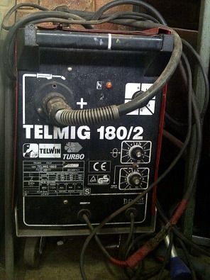

I'd say that's more of a supercharged fanTelwin Super Turbo........
A bit OTT and noisy compared to a Papst ducted fan though.
