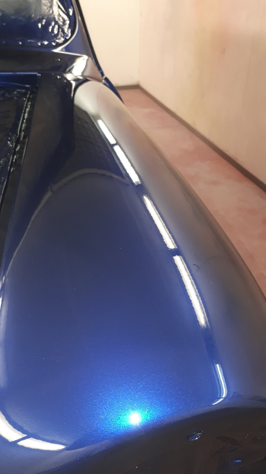

I have a T110 cap and yes it is a flatter finish than the TE20 although it's slower, I normally run it around 2 bar which is around the recommended pressure by Devilbiss, that's with a HS clear
