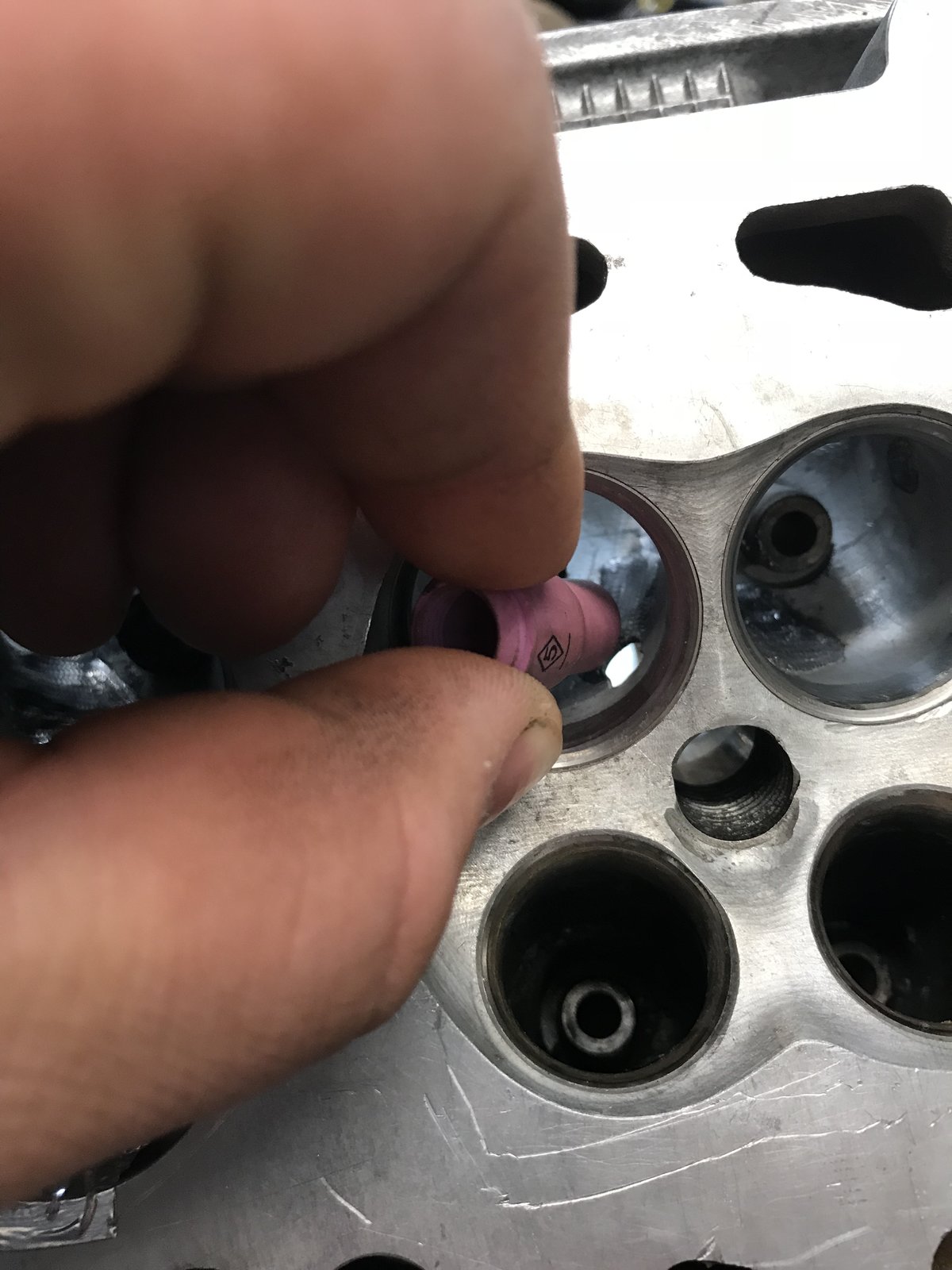

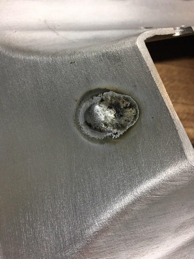

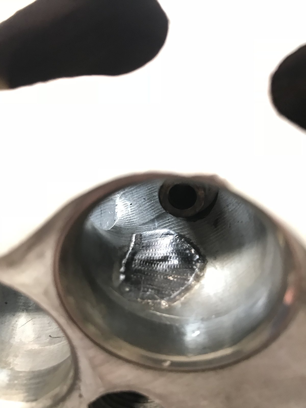

I had an unweldable cylinder head brought to me a while back told the guy I couldn’t do it, he took it to an real high end engine repair company, they acid washed it apparently, then carried out some laser welding.
Subsequently, the guy had the spark plug wells bored out and they broke through the cylinder again, and I was able to tig it with no problems this time.
