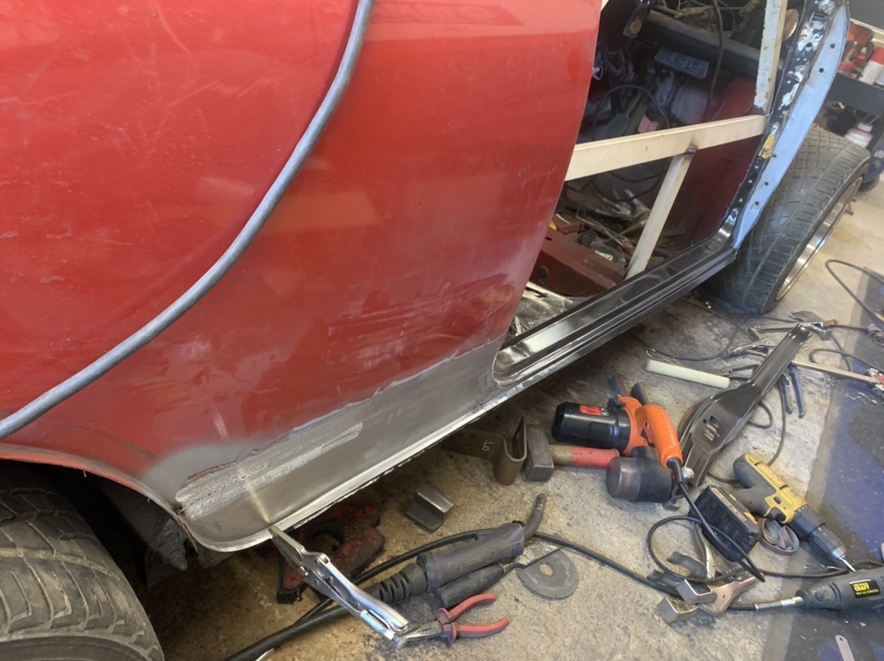

I use the edge of a thin cut disc then roloc pads
If possible body file to finish.
If it’s a panel joint I gas weld as it’s soft then dress with dolly and final with body file
