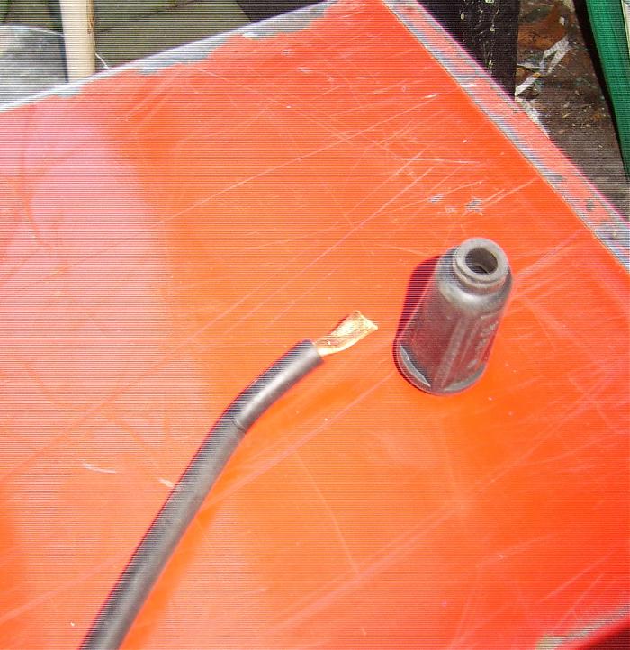

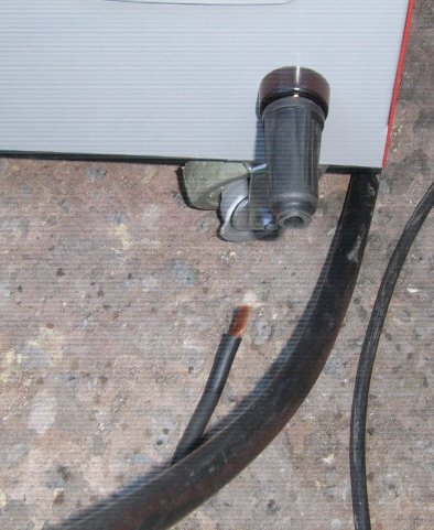

Easy to fix, and i happends to me often. Inside the rubber bit is a brass bit, the earth cable pushes up inside the brass bit and is secured by an allen key grub screw. just loesen the screw refit the earth and tighten back up.
Zardoz said it was crimped btw.
The crimped ones are cheaperAnyone else geting flashbacks from the 70's agggh its the maestro again
