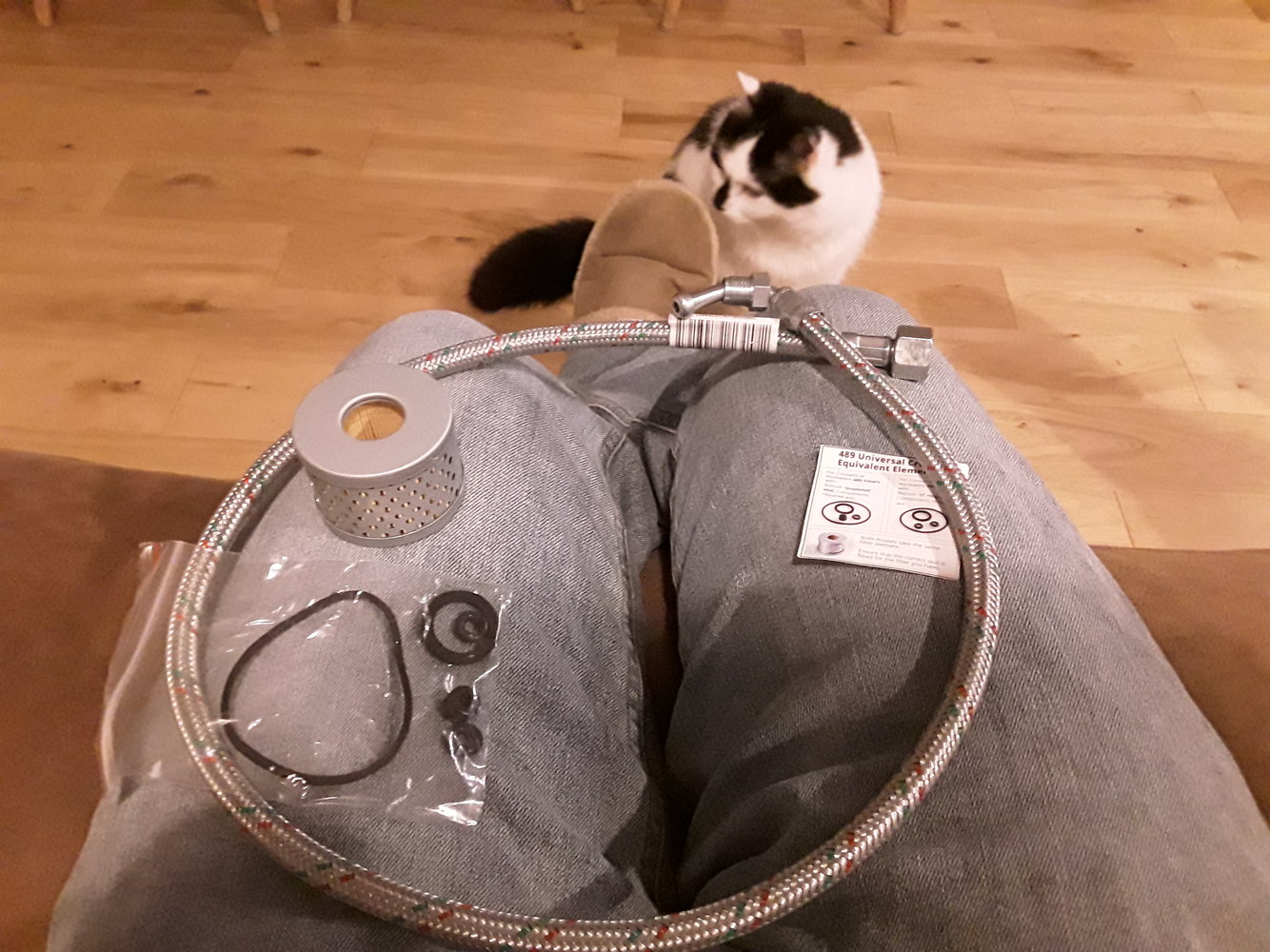

I went out to check the boiler on Sunday and it smelt quite oily, I found the flexy oil pipe was weeping so ordered a new one along with a filter element from Heating Parts Warehouse. They're here already, not the cheapest but good service!.
Apparently those metal braided pipes are supposed to be replaced every year or two. The green pipes are something like five years. Our plumber mentioned it last year.I've taken the sensor apart and there looks like a burnt SMT resistor or other similar component (I can't see it it's so,small!) Bin job

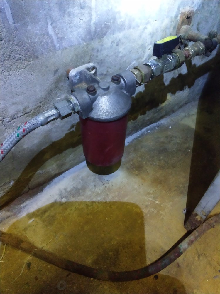

Same as the filter that looks like it's never been touched! I'll find another boiler man for the next service. I'm tempted to get OFTEC registration and do that as a job instead of being an electrician, seems like easy money servicing and installing oil boilers...Apparently those metal braided pipes are supposed to be replaced every year or two. The green pipes are something like five years. Our plumber mentioned it last year.

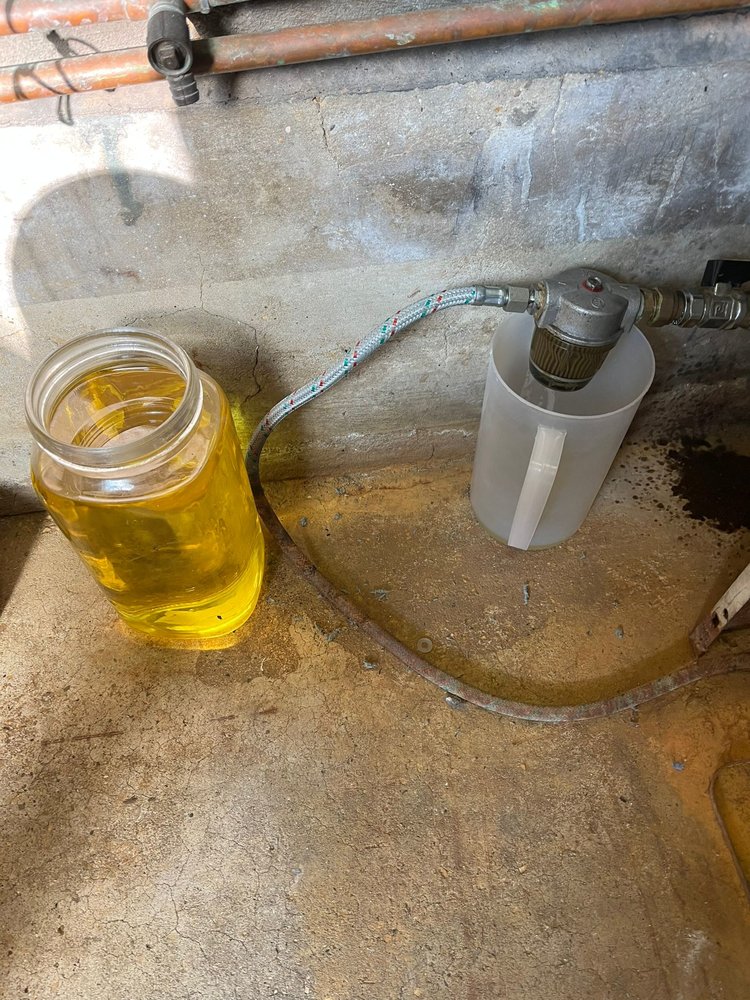

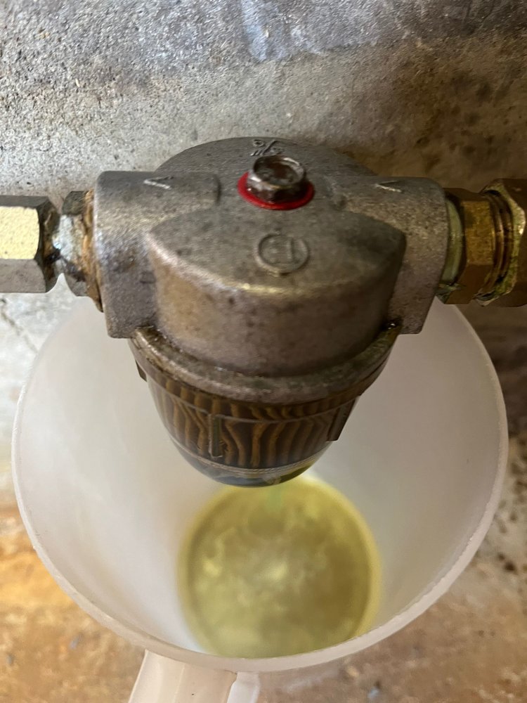

Going back many years when I worked for a builders merchant, we sold 3/8 OD soft copper for oil lines & the fittings were generally flare fittings. The flaring tool was the same as the basic ones sold today in MM type places for brake lines but without the little die for doing the double flare.Another call from an old neighbour that his filter is leaking! I'm going to have a look tonight.
I think they're 3/8" fittings, it's old pipe so probably not 8 or 10mm.
Any ideas?
