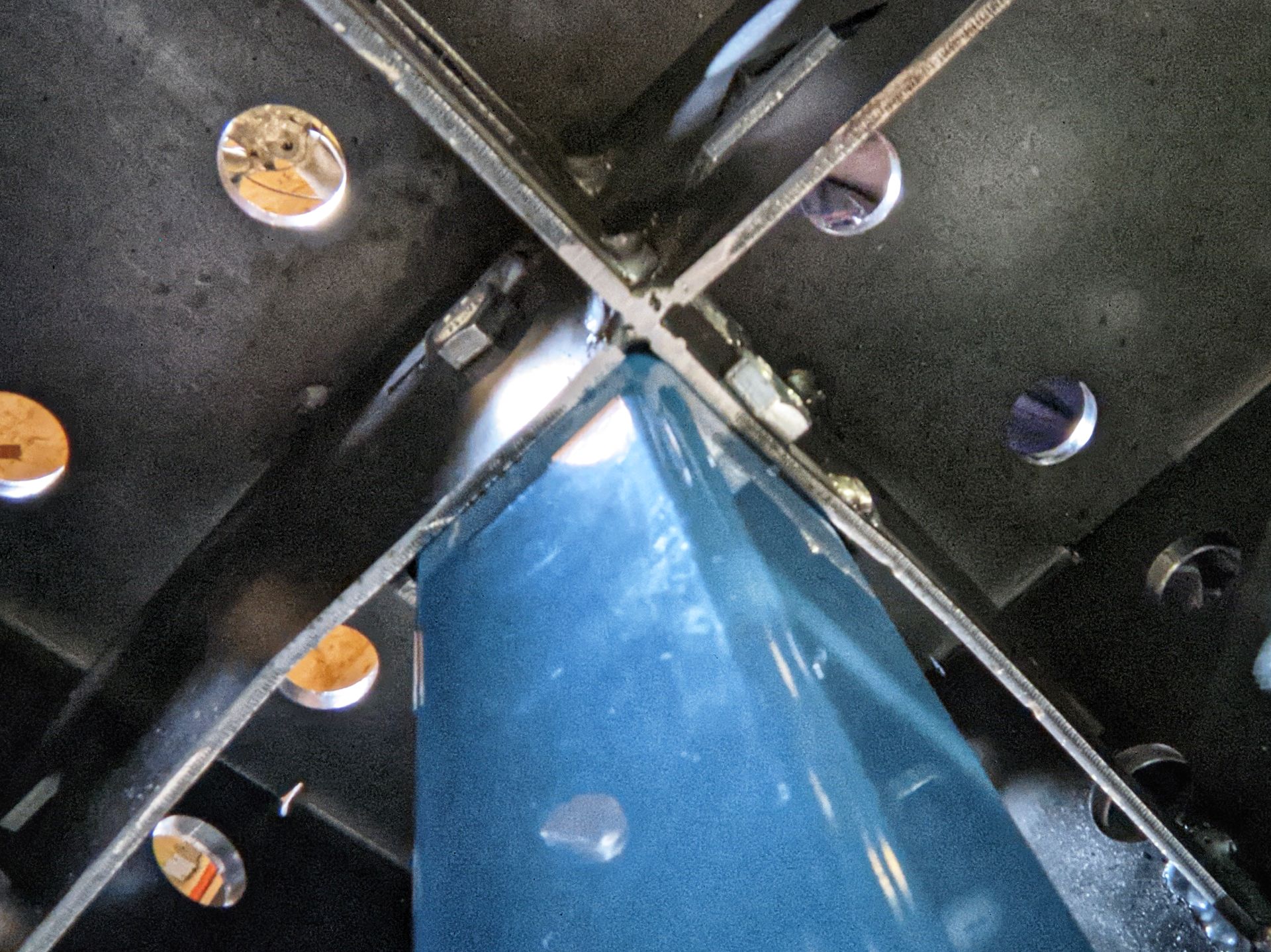

I'd also anticipated needing a burly neighbours help (had some wine set aside) to get it assembled but, whilst lesser mortals may have struggled, I was just able to get it done myself; got the top on to a sack truck, bolted the legs on and then levered the other side up to rest on the sack truck whilst I bolted the remaining two legs from underneath. Each leg slots in to the underside and is secured with two M12 bolts passing through at 90deg to each other:

I'd envisaged the sides being separate parts but these are folded with incredible precision - I could also only envisage this stiffening the top itself and you can also see that the holes have actually been drilled out to 28mm after (laser?) cutting:

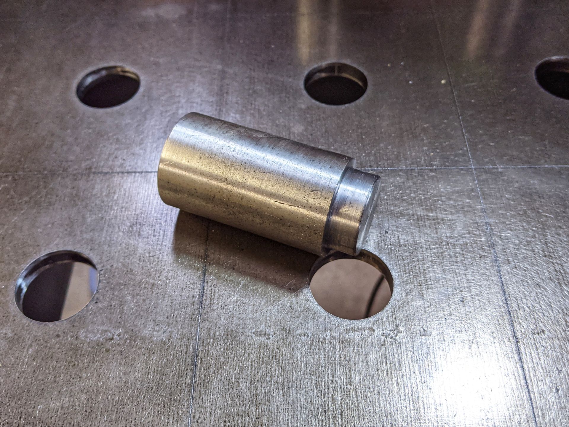

I'd also anticipated the surface having 16mm holes as the GPPH ECO tooling mentioned on WSD's website refers to 16mm but they are 28mm. I'd found a box of unused 16mm woodwork dogs/stops at work (in the wee cardboard box labelled 'steel billets' as nobody before recognised them for what they are - the school is 60yrs old!) and thought they'd be useful. Most welding and fab tooling in the UK seems to use 16mm so might be a consideration for some. Again, I've pointed this out to Tom; it seems that 28mm is standard and 16mm an option.
As work was so quiet with only about ten percent of kids in before we broke up for Christmas I jumped on a lathe after finding some 35mm stock and turned some dogs/stops:

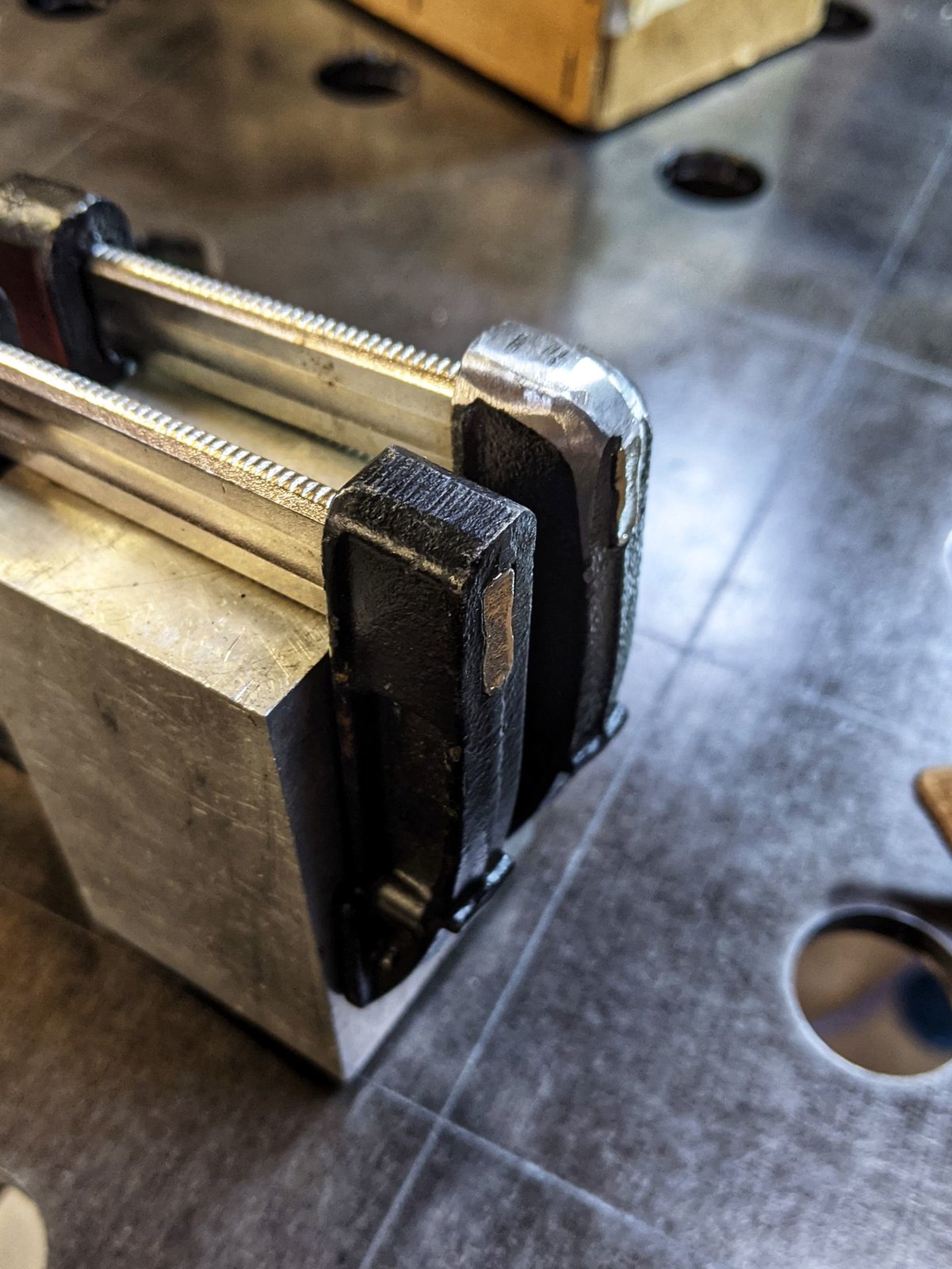

Anyway, it turns out the larger holes are a blessing in disguise as I've found I can just grind off the outside corners of some cheap Aldi/Lidl clamps and they'll slip through the 28mm holes and clamp from the underside:
